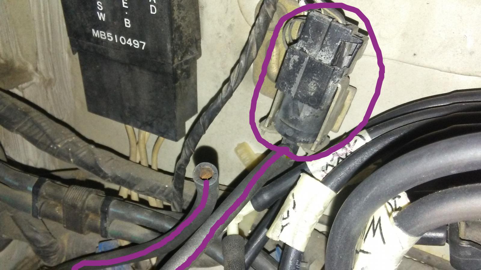

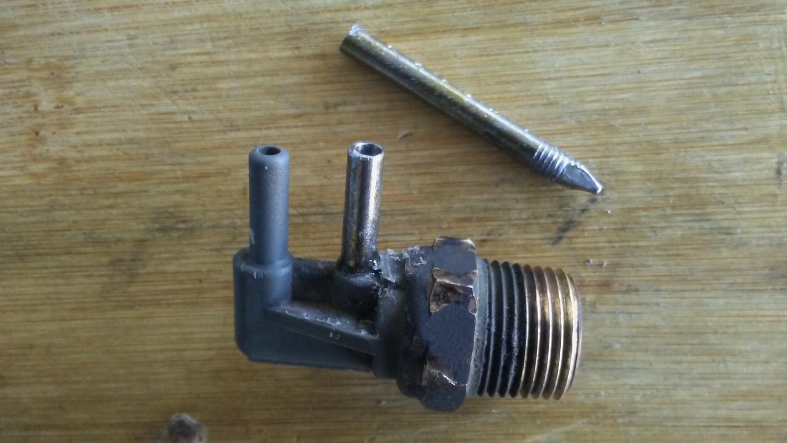

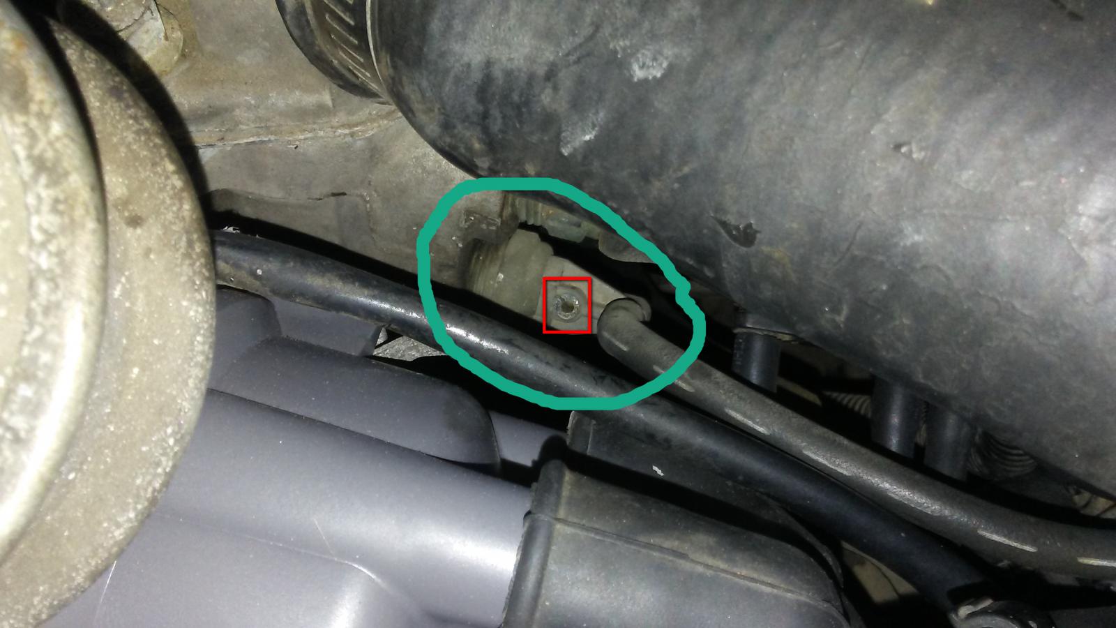

    I accidentally broke what I believe to be a sensor. (Made of plastic) I need to know where I can get this part for a 1988 Mighty Max. Also the vacuum diagrams in the manual aren't clear enough, I was wondering if you guys knew where these hoses attach to. I'm in the process of routing the hoses to their correct place and need help in doing so.
    Broken Part:
    Hose goes where?:
    Yea, that is a thermo valve for the emissions/carb system. You won't find a new one, I looked forever years back, you will have to source a used one and hope it doesn't break during removal.

    Here is my desperate attempt at trying to fix this thermo valve. Used a nail that I drilled through and some super glue.
    The thing on the firewall is the AC idle bump up valve.
