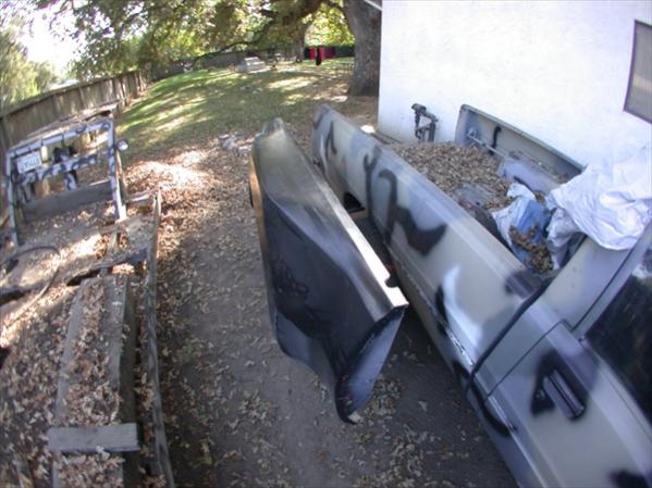

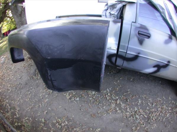

    Fiberglass Bed Side Comparison
    Here is what the bed sides will look like. This is only the Plug, not the part.
    The actual part will only be a shell of the out side. Nothing on the inside, just a shell totally open with a 1 inch lip added for strength around the wheel opening.
    I will have pictures of the parts soon.

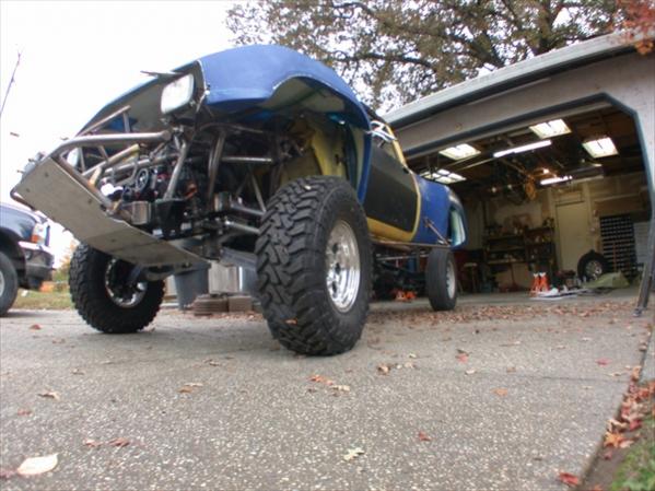

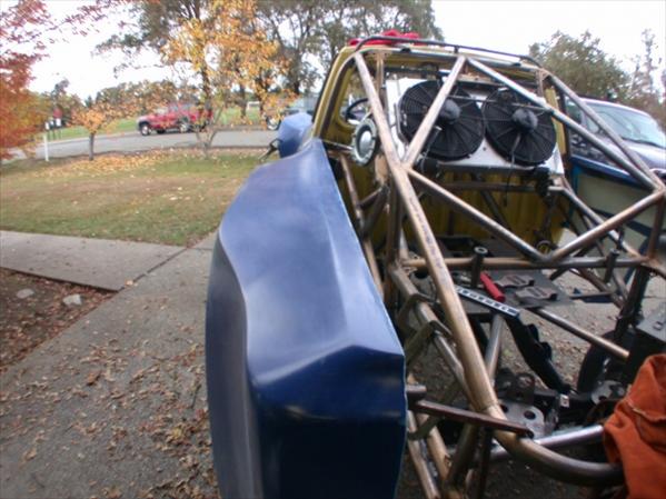

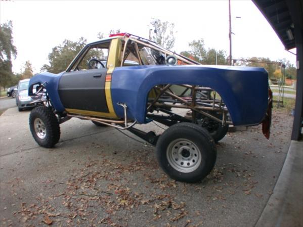

    Finished parts.
    Here is what the cost is from fiberglass Jeff. Pricing does not include shipping.
    Rear bed sides cost $575.00 each Or a full bed set for $1000.00
    Complete Front End $1550.00
    Complete package including left and right rear bedsides and complete front end. $2250.00
    This does NOT include shipping or any hardware. Glass only.. Parts need to be fitted and there is finish body work involved. This is for the glass only. Carbon fiber starts as low as $8300.00 more for the complete package. This depends on the type of carbon fiber used.

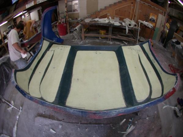

    Very interesting, this is much different than the fiberglass parts I am working on. Yours is much more extreme than what I am going for. I am retaining the hood and bedsides and go with full fiberglass front fenders and some 5" fiberglass flares for the bed. I have really opened up the front wheel wells and the rears are already capable of stuffing a 35". The OEM front fenders were so small that you would experience rubbing even with a 30" tire. I am trying my hardest to make my fenders look 100% stock.
    How did you do the flares on the rear of the 1st gen - metal or glass?
    3,848
    Mine is a 7 inch flair, but the truck is now 1.5 foot wider in the front end. The wheels still stick out side the flair by 4.5 inches at mid travel. One thing to keep in mind is the stock fenders are crap and there is a real good chance they will not survive the mold process. Mine folded like paper at the bottom near the door. Have you done many molds? In by build thread I show some tricks on the flanging process. Just look closely at the pictures.
    It would be nice if you flange the mold around the flair it's self, before doing the rest of the fender. This way you can make just a flair or complete fender and flair. It might be worth the extra day just to give your self the option. Then you can sell the flair as a bolt on option for stock fenders. It just makes the mold more versatile for you. You would have somthing like a 7 peace mold when done. Mine is 6 just for what would be 1 fender if it was stock. Next year it might be a full stock fiberglass cab out sides.
    3,848
    On mine, the first thing that was done was to shorten the bed by 1 foot. Then cut the opening larger and weld in sheet metal to the width it was going to be. Next came a cardboard dam around the hole bed side about 8 inches high. 2 part, 4 pound expanding foam over the hole thing. Sand to rough shape. Fill in all the BIG holes with bondo and cover with 2 layers of glass to make a hard shell. Then it's the basic finish work after that to make the final shape. I go into a lot of detail in my build thread. Parts 1 and 2 on the molding.
