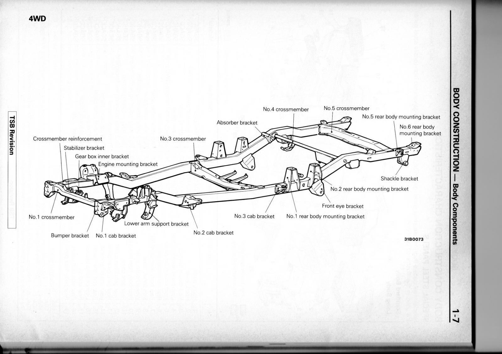

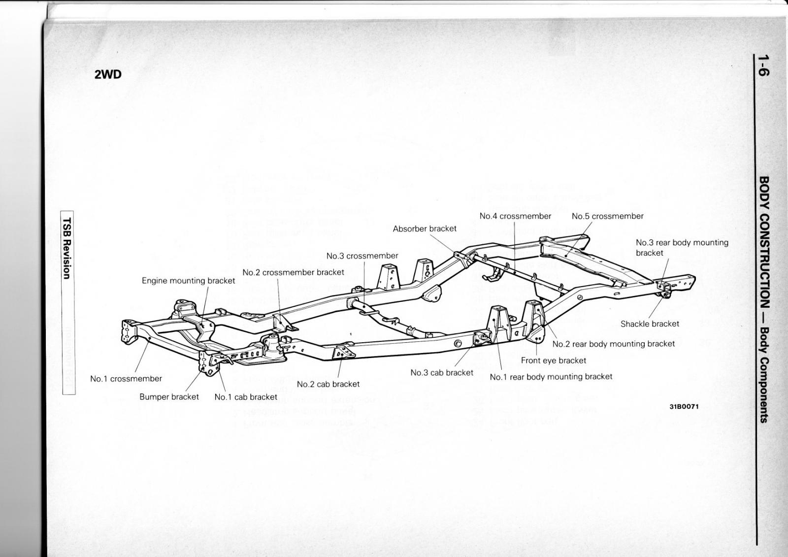

    I pulled these from the factory collision repair manual. It's an overview of the construction and differences between 2WD and 4WD frames.
    The book has a lot more info, including precise measurements for repair and replacement of various parts. Let me know if you need more info.2WD frame overview.jpg4WD frame overview.jpg
    These same drawings are in the Wiki section of the forum, along with many other diagrams. FYI
