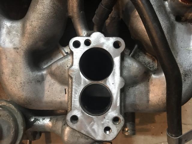

Do I have to block the hole on the side of the manifold? Looking at the carb, that hole looks like a vacuum port.[/QUOTE]

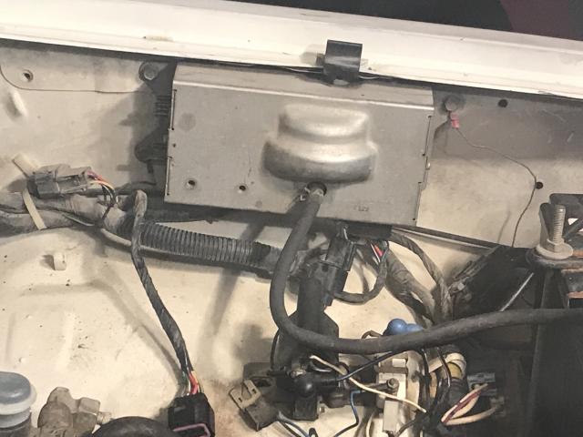

What about the other electrical connections on the control box? Do I need to do something with them?![]()
If you're asking about a threaded hole pointing towards the driver's side directly below the carb, there should have been a vacuum barb "tree" screwed into that with 5 barbs on it. You can just plug that, but it's a weird BSPT 1/8"-28 threading; looks like this plug should do the trick:
https://www.ebay.com/itm/122857847756
In this case for distributor vac advance you'd just use "ported" vacuum from the carb. The DFEV carb with that K614 kit should have a suitable barb low on the choke side, just above the idle mixture screw.
Just disconnect the wiring terminal blocks connecting to that box and the carb. You can just leave the disconnected terminal blocks as-is, maybe tuck or zip-tie them out of the way for tidiness if you wish.
I really appreciate all the info. The port I’m talking about is between the two carb mounting bolt holes closest to the head. Looking at the stock carb, it looks like a vacuum port.
I threaded the bottom hole and I’ll be getting a plug.
Aha, that's the jet-valve port, only works with the stock carb and does nothing at all (good nor bad) with a Weber swap. No need to do anything with it as I think the adapter plate blocks it, but you may as well at least remove the lash adjuster screws that operate the jet valves, effectively disabling them, or even get a jet valve eliminator kit to replace them entirely. You'll find those lash screws on the same rocker arms that operate the main intake valves.
