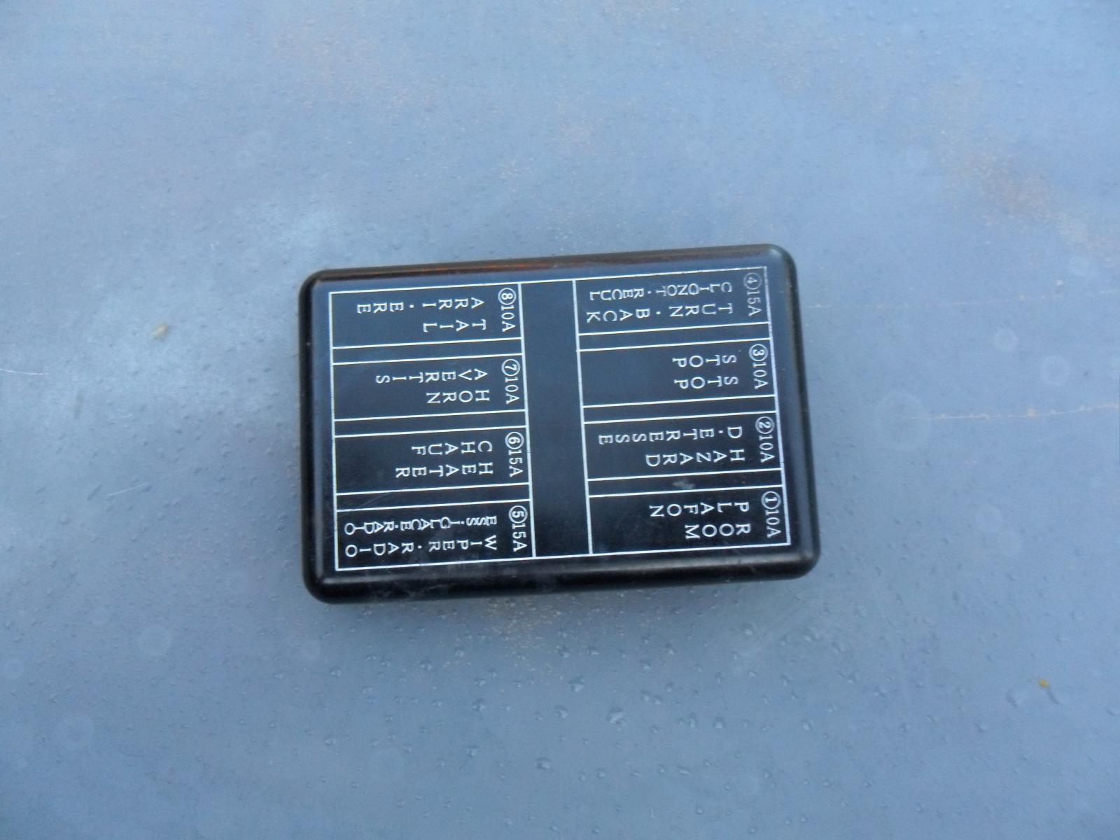

    Well I turned it off and back on and the station I saved was still there as were the settings. I connected the memory wire and power wire then used the old wire I had for power on the last unit. So if there is power there is memory. There will be a picture of the fuse block cover at the end of this post. Bottom right would be the top left I soldered to. I honestly do not comprehend what some of those terms mean.

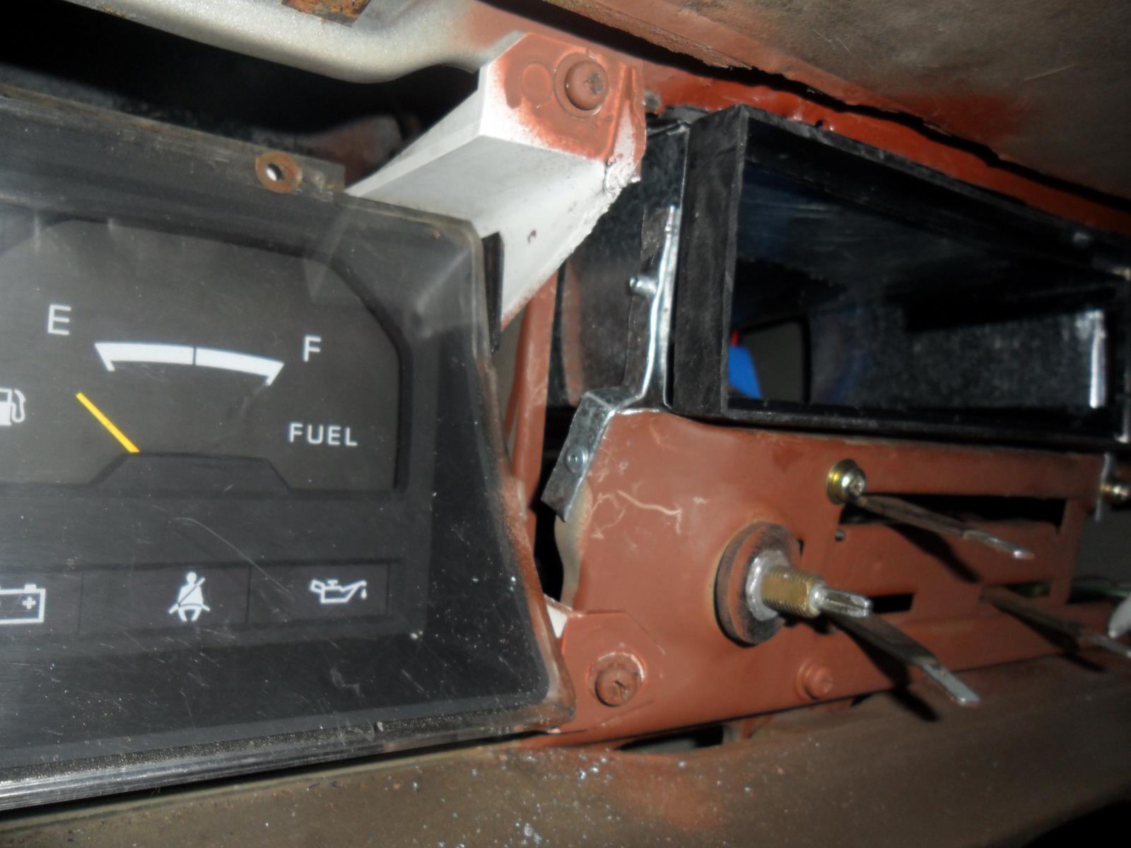

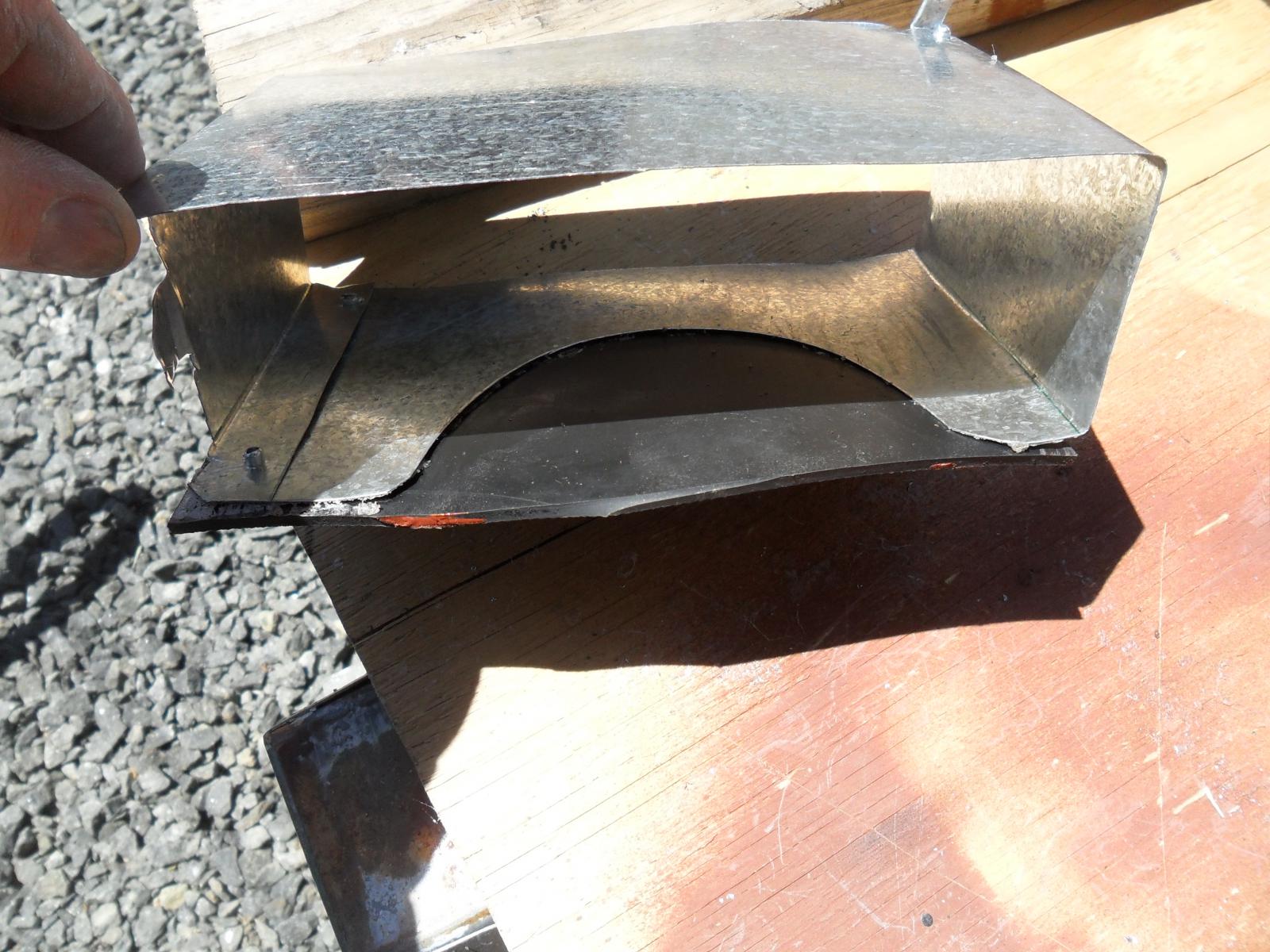

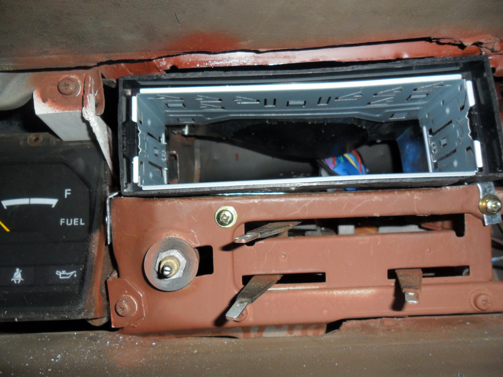

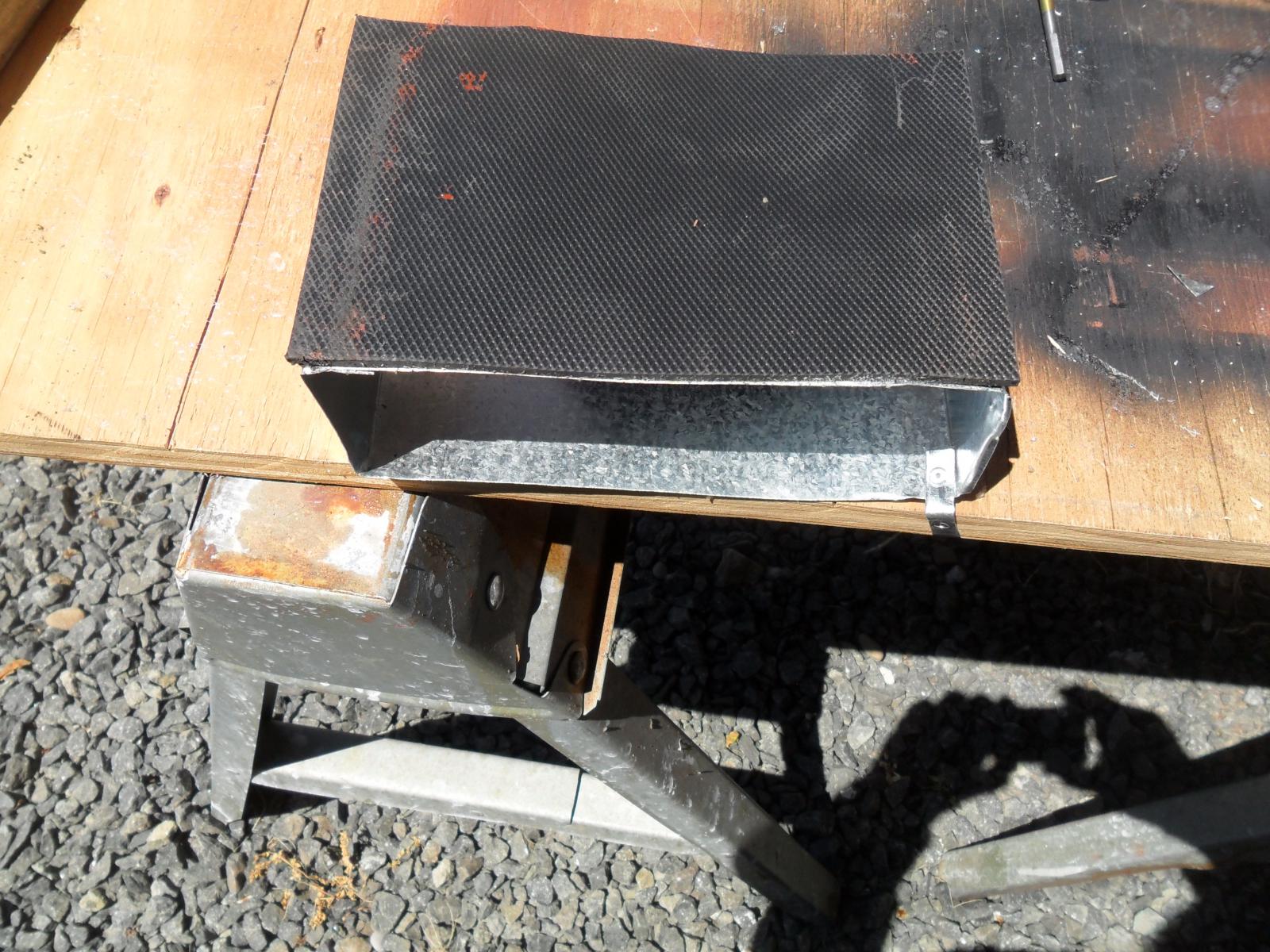

    Here is my solution to my problem with the speaker and the cut out on my dash. Looks like I need to take it apart sometime down the road and pull that left side out further so it sets closer to the face of the dash panel.
    What I came up with was to build a box with galv Sheet metal. Then line the top of it with non-conductive rubber. I bought what is called Switchboard mat. Cost $11.50 per foot off the 3ft long roll. I used 7" piece of my 1'x3'. I riveted the box together (had to crush the rivet near the front with vise grips so the plastic frame would fit.) spray glued the mat to it. I found out my tabs would not work so I folded a strip of sheet metal. I suppose it's called hem even if that is all I was using of the metal. Then I riveted a piece down in the lower right corner and drilled a 1/8 hole so the top right screw of the heater controls would hold it. I can't find the picture of that. Then I riveted a piece on the left to the dash metal that is still there and when I got the box set riveted it. (I probably need to redo that eventually. It left a big gap) Then I slipped the plastic frame for the basket that locks the unit in. Put in the basket pulled te wires out and plugged it in. After messing with it a bit I pushed it home. swithcboard mat.jpg cutout.jpg speaker magnet pushes dwn.jpg rivets!.jpg need to reset left side..jpg

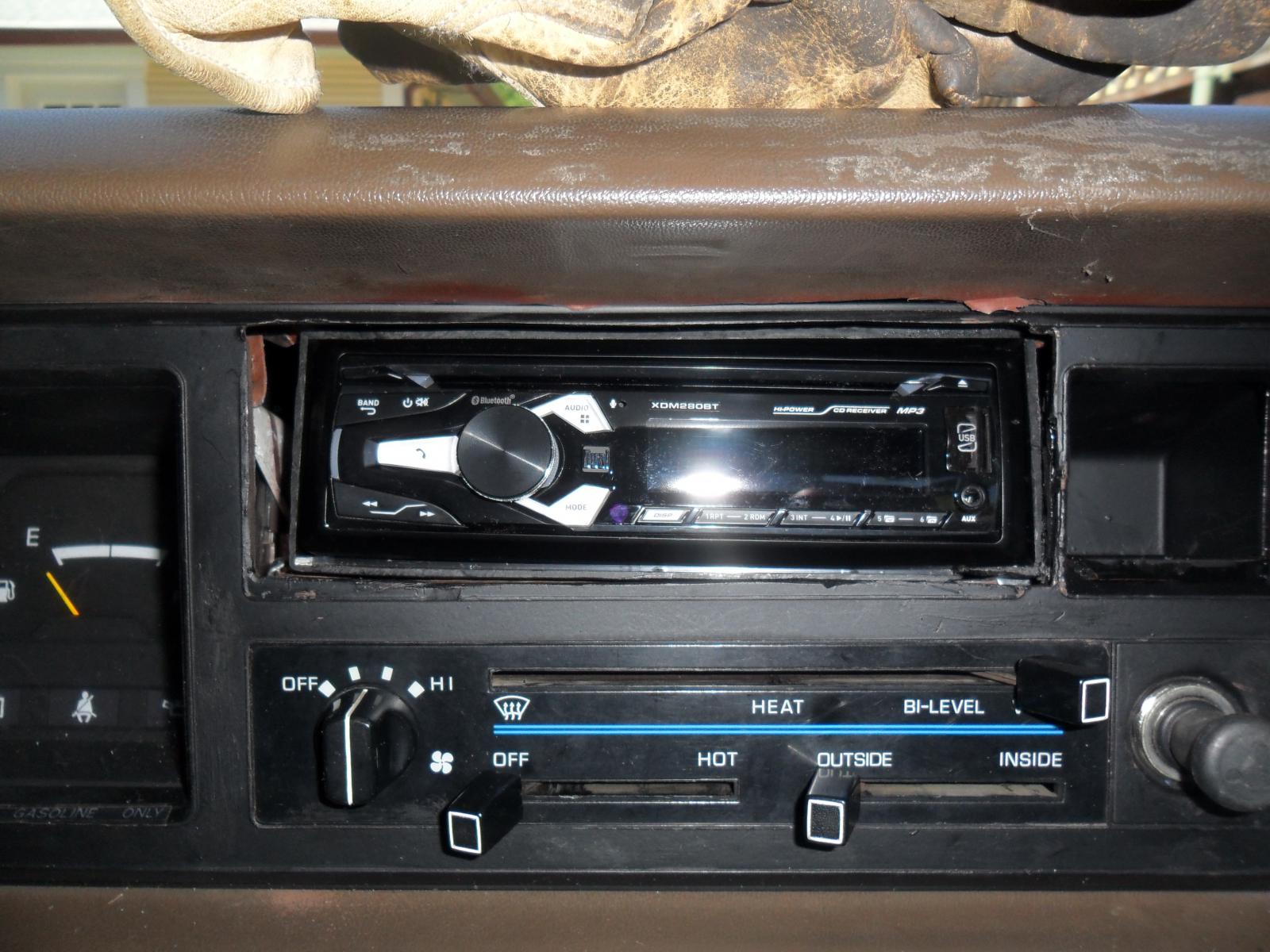

    Well got it mounted again. Its not great but will do until I decide to do something else.
