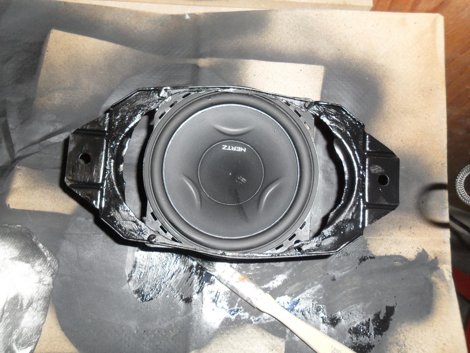

    I decided to install the CD./radio unit I bought myself for Christmas a couple years ago. Well I have the dash speaker out. It is an oddball. I found this website but the speakers they show come in pairs and do not have the correct mounting holes. https://www.sonicelectronix.com/dodg...-speakers.html So I emailed them the picture and am awaiting a reply to see if they have anything that fits properly like the OE. Does anyone have that speaker part number?
    That is 6.75" center to center on the mounting holes. 3.5x5.75 actual speaker measurement. I can see how a 5.25 round speaker might fit if the two corner mounts were far enough apart. I was hoping the good 6x8 out of my Dakota would fit. Off by about an inch and probably too deep for the location.

    EDIT- THIS METHOD DID NOT WORK. THE PLYWOOD WAS TOO BIG. THE SIDES OF THE OE SPEAKER MOUNT ARE THE ABSOLUTE LIMIT ON WIDTH. LOOK BELOW I REUSED THE OE SPEAKER FRAME.
    The one they had was $229US if I remember correctly. Thanks for the advice you aren't a snob I'm not that worried about the quality of the sound system. I think it will still be very nice.
    I went to the stereo install place that I know of and I got a pair of 4" Pics attached. The guy who would have installed it let me know he was just going to use a piece of plywood, wink, where the salesman was talking about "making a plate" , Once he told me that I realized how to fix it and bought the speakers being recommended. IDK how to judge but you gotta trust people sometimes. He told me he gave me a $50 cut in price. I paid $80 for the two of them. So here are pics of the solution I came up with. I have not stuck it in yet because I am waiting for paint to dry so I can go get some spade fittings that fit. The ones I bought at the hardware look right but are too tight. Once I get that in and a wire dangling I am going to s solder the rest of the connections if I can and for the Chrysler door speakers I am going to have to see if Crutchfield will send me a set of connectors so I could use the OE connector.
    It's good enough for me. I used half inch plywood when I broke the 1/4 inch twice. I'm sure you could use 1/4 if you had a better jigsaw than I. The hole in the middle was to be 4" maybe just a bit bigger, I might be a bit a lot bigger. A hole saw would be best if you had one. Finding screws short enough to mount it to the wood is a problem too. If I couldn't get them I was going to grind off the extra from the stock screws it came with. The two holes for the mount I drilled straight through the old speaker 1/4 inch hole. I'm hoping I do not have to try to mount it on top of the board. I may put a bit of landscape fabric over it to protect it from sun.

    The speakers are poly cones, the body is metal and the magnet is covered with plastic. I have felt I'll think about getting MDF but I'm not that invested in the idea unless this thing just sound horrible. I will cover this mount as suggested. That should give some UV protection.

    The plywood was too bulky. The absolute limit on width is the width of the OE speaker. I chose to cut up the OE speaker frame and screw the new one to it. If you have a nice cutting wheel for your grinder that would be best to do the job. Make the cut out flush on the back side. I marked the holes and used a drill to make pilot holes before screwing the screws through those hole, then I mounted the speaker to it. I had to cover the cone and grind off the top of the screws (sheet metal self tapping 1/4 long) then paint. I used a paint brush and sprayed a puddle to dip it in to get at the fidly bits. The felt did not want to cut after I glued it on so it looks like heck. The thing is mounted. I discovered on my trip to the JY that the gen 1 Dakotas are getting rare around here no joy finding OE speaker harness connectors but those spades that did not work on the new speaker will work on the OE dak speakers I am going to put in the door. I got a plastic sleeve that holds the short locking sleeve that comes with the head unit and some speaker backing for the door for free. The sleeve is too fat around the edges. I'm going to look for another one. Here's the new pics. EDIT- the speaker backing is really a kind of mount with molded in cover to protect the speaker from rain. I'll take a picture when I get to mounting them.
