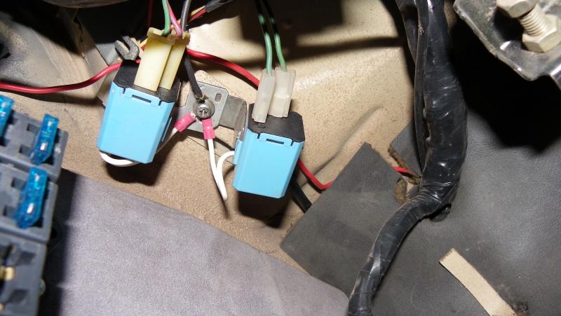

    LOL that's the seat belt timer. the Flashers is a triangle black box with pink writing with an L shaped plug on a small bracket screwed into a mount under the dash. There is a round silver pot with a double plug beside it that's the hazard flasher. They are located behind the side vent tube so you have to look up behind it to see them.
    Here's a pic of the original flasher
    so look for something like this.
    Pic of the location of the 2 flashers
    Their screwed into a little tab up under the dash above and behind the fuses

    There is nothing under there that looks add what you described. Could you somehow post a picture?
    Turn on the hazard and fallow the click noise. The turn and hazard are 2 different units. But they will both be a 2 prong unit.
