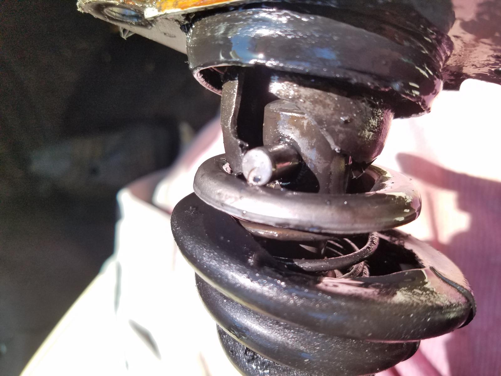

    My bushings got lost in the mail, so my friend and I pulled the shifter out to look at it and found a massive chunk of metal has broken off and on the other side it's cracked. Does anyone where where I can buy this? Theres a 2wd truck in a junkyard nearby would the shifter from that one work in my truck?

    Measure the reach of the shifter so you get the right one I have 2 5 speeds and each has a different length shifter where it goes into the tranny so you don't waste time getting the wrong one.
    Rockauto carries just the bushing part.
    Got any part numbers?

    Check the "for sale" here looks like there is a gen 1 being parted out it has a shifter!
    03-23-2014
    660
    Pukwana, SD
    Found a old D50 sitting in a junk lot it was a 2wd and had a shifter in it would that work on yours? I can talk to the guy if your interested.
    2wd and 4wd shifters are different - 3 bolt for 2wd and 4 bolt for 4wd

    82 shifter does not work in a 87, I wanted a short throw and I wasted 4 hours because I fucked it up for the old shifter. I finally got it in at the expense of my bushing popping off and me digging with a pair of needle nose for another hour to have it fall into the pan. needless to say I had a bad day. it was 3" shorter and I had to push down for 5th. all shifters were different between 1st ten, 2nd gen, 2wd, 4wd, and obviously manual and auto. but make sure when you put it in the notch in the plate and the metal gasket are aligned and are against the 4x4 whifter. I know this is an old thread but its still a good tip for anyone reading in the future. hello future!
