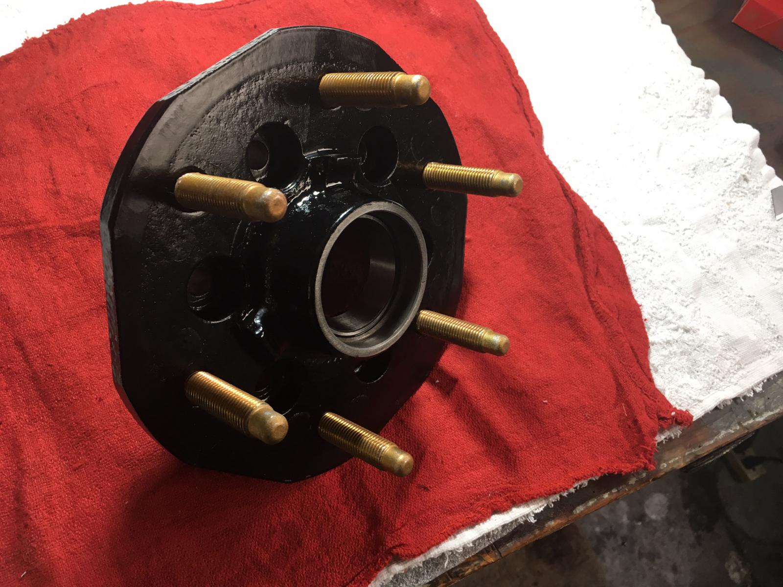

    So had the wheel centers and hubs powder coated semi-gloss black. Installed some ARP wheel studs, not cause I wanted to but had to install longer ones cause of the new wheels. Also, you can see the hub centric rings I got. The fit perfectly. IMG_0052.jpg

    What's the part # for the extended studs you used? I need some for my 94 mighty Max
    Thanks in advanced

    Extended studs?

    Quote Originally Posted by TTan94maxi View Post
    Thanks in advanced
    Ok, now I got it. To tell you the truth can't remember.
    They are ARP. 12X1.5
    I took a measurement of the knurled part of the stock stud and than used that info when ordering.
