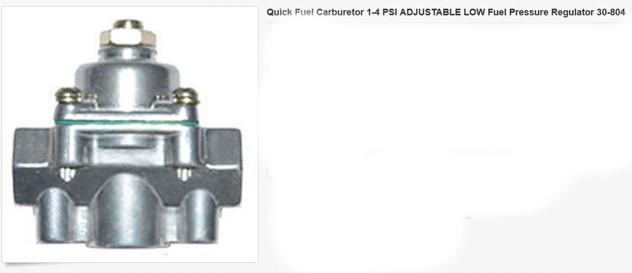

    factory pump with a fuel pressure regulator2.jpg the problem with that is i put a gauge on the line going to the carb and could not get a reading @ all so i thought maybe the the gauge was bad so i bought another one regulator with gauge 3.jpgcould not get a reading with that one either. now i hooked theses in the line that goes to the carb (after the pump before the carb) so it should have read something right? but i get nothing no reading on either gauge so i took them out and am now just running the fuel pressure regulator2.jpg
    The regulator you show comes preset at 3psi. That is very low and you'd have to have a very good (expensive) gauge to get a good reading on that low a pressure. 3psi is also the correct pressure you want for a Weber carb.

    Dude! I just ran through the exact same situation with my 88 G63B.
    I bought that exact same holley regulator and a harbor freight 0-10 psi gauge. Couldn't get a reading, was frustrated, truck ran like garbage, already tried re-jetting. Finally decided to listen to everyone's advice on here and put an electric pump on my truck. Turns out I wasn't getting a reading because my mechanical pump was putting out 0.5 psi at best. I have a shortbed regular cab 2wd which makes mounting a fuel pump near the tank somewhat difficult, it's real tight back there.
    I used an Airtex E8016S. I know Airtex doesn't have the best rep but I had it laying around from a different build. It was something like $25 from rockauto, I looked it up for a first gen RX-7 that uses an inline pump, it puts out about 4-5 psi. Best of all, it's tiny and has a pre-filter threaded right into it. Don't forget to hook up a relay. Echlin part no. AR272 (standard five-pin relay, fifth/middle pin goes unused) works perfect.
    Truck runs much better now at idle and on the primary jet. Could hardly get into the secondary range (>3000) before. I really think the mechanical pumps are garbage for anything but the stock carb (which also happens to be garbage lol).

    well here's an update:
    took little truck down to the new mechanic today
    he put gauges on the fuel lines and found out that the pressure coming from the manual fuel pump is 5 pounds
    and after the regulator it,s 4 pounds going into the carb
    *he also sprayed carb cleaner around the bottom of carb and found a vacuum leak*
    so he tried to adjust the regulator down to 3 pounds and no go
    it just would not go down any more.
    so i had another regulator with a built in gauge he put that one in line and got it to go down to 3 pounds .
    it ran fine sitting there in idle.
    but after going down the road the truck died like it ran out of fuel so i hooked the fuel lines back up to the old regulator and it ran still had run-on after shutting the engine off .
    taking it down Wednesday and he is going to put new caskets on it and make sure there isn't a vacuum leak and then go from there.
    a lot of my problems may have been the vacuum leak it just never dawned on me that it would be leaking duhhhhhh .
    on the bright side he is doing all of this for $40 bucks the other guy i had wanted $300 just to hook gauges up. so needless to say i now have a new mechanic.
    hope he works out.
