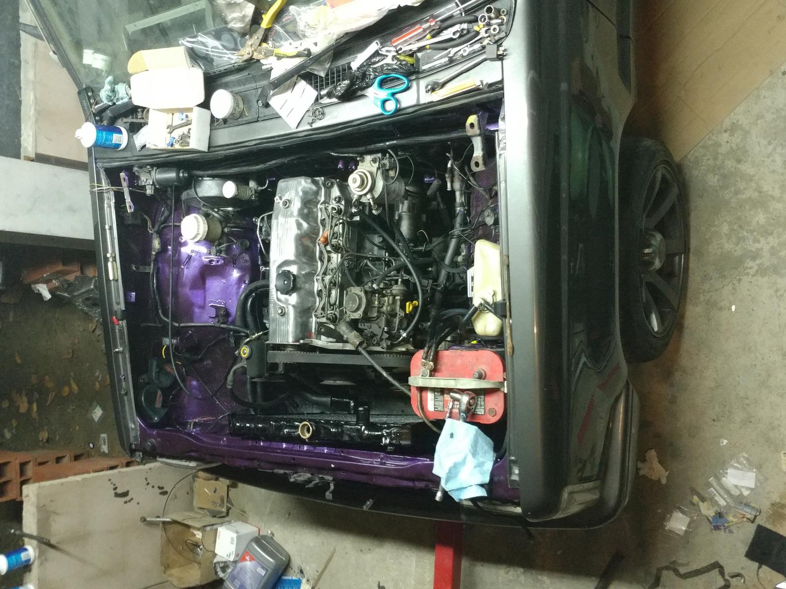

    Those numbers seem off.. But then again it's alot of boost for a td04... I never dynod mine but im sure it would be somewhere around 200hp and 400tq... I havent put on the evo turbo as yet.. Currently i have a td04 13t out of a bmw 3 series diesel..
    01-18-2015
    250
    Inwood WV
    1991 Mitsubishi L200
    4D56-T
    Quote Originally Posted by Speedaholic View Post
    Thats a lot of Nitro lol
    I went with the APS SR50 that i ran for a while on 25-30psi, to much lag, i moved to a SR40, which is same cold side but smaller hotside.
    30 PSI dyno'd 127rwhp and 217rwtq. Same dyno i dynod the 15t, same gearing, same tires, etc
    (oh, this dyno is also 5 speed)
