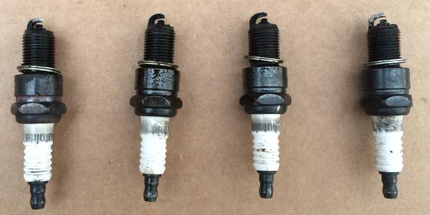

    I finally got around to checking piston compression and got <90 PSI on all cylinders… It could be that my compression checking tool was off, but given that the exhaust was whitish and spark plugs (at least two of them, see picture below) had a good amount of white residue on them, I am certainly suspecting a blown gasket or even a cracked head.
