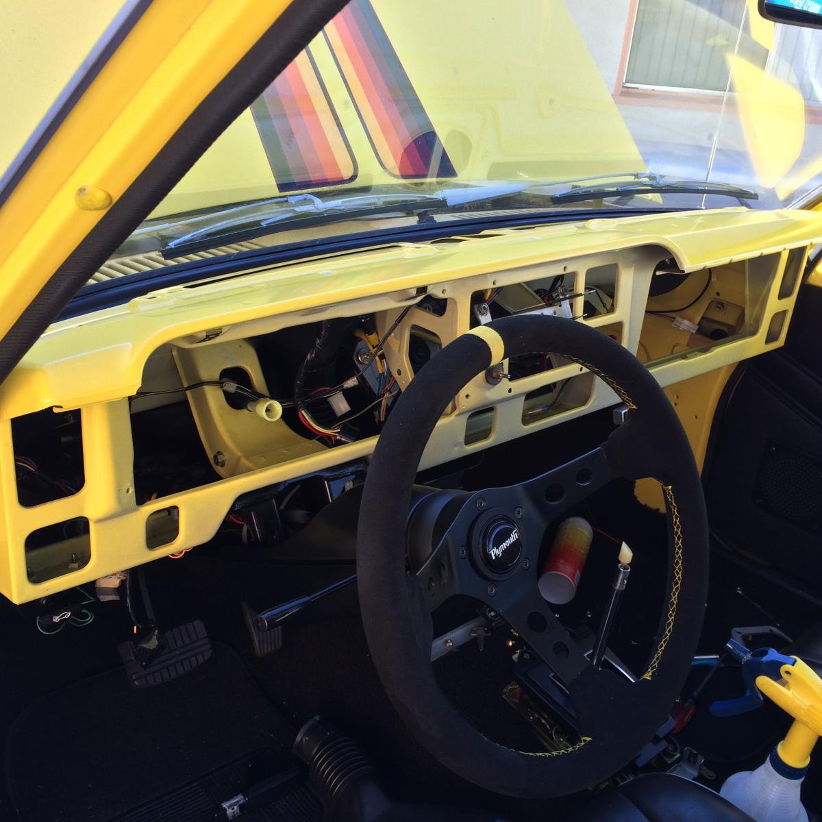

If you are mechanically inclined it's a breeze. IMG_0519.jpgIMG_0520.jpgIMG_0521.jpgIMG_0524.jpg

You will need to remove the demister vent panel directly under the windscreen. It's anchored down with 4 x 8mm flare nuts (the demister diffusers are anchored into place by them). A handful of phillips head screws hold the hidden back edge of the dash padding to the dash frame (you will need a stubby screwdriver or one of those crank handle screwdrivers you sometimes get in flat pack furniture as space is limited). Pull the glove box, instrument panel, vent control cover panel, the big screw hiding under that plug in the dash, the instrument dimmer knob and the remaining screws on the underside of the dash padding that hold it up to the lower dash frame and you should be ready to pull the dash pad off. Removing the steering column cover may also add some clearance to pull the padding off.

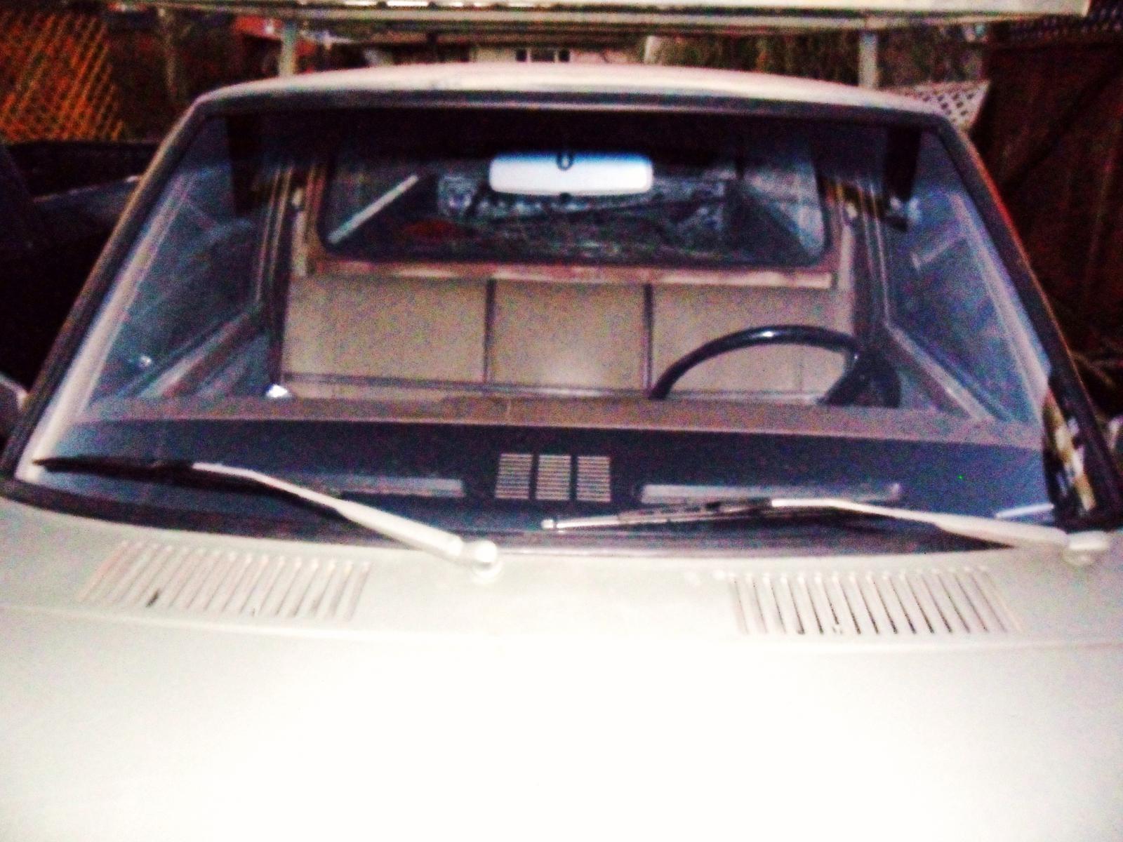

Well it turns out there was a lot of adhesive or black sealer injected into the old window gasket. The glass guy figures that the water is coming from the cowl/firewall or possibly being driven around the glass. The person who put the sealer in blocked up the passenger side drain area at the top of the fender where it curves up to the windshield. The pinch weld was immaculate it looked new the clear coat was still glossy So its on with no sealer. I will wait for rain to see if it has worked I need to sand and prime it and take the dash out to look for shorted wires and a leak.
EDIT- I forgot to mention that the glass guy said the water might make it around the glass through the gasket because the chrome trim had been removed. He said the chrome added a lot of tension to the gasket and its removal may have let water through.
