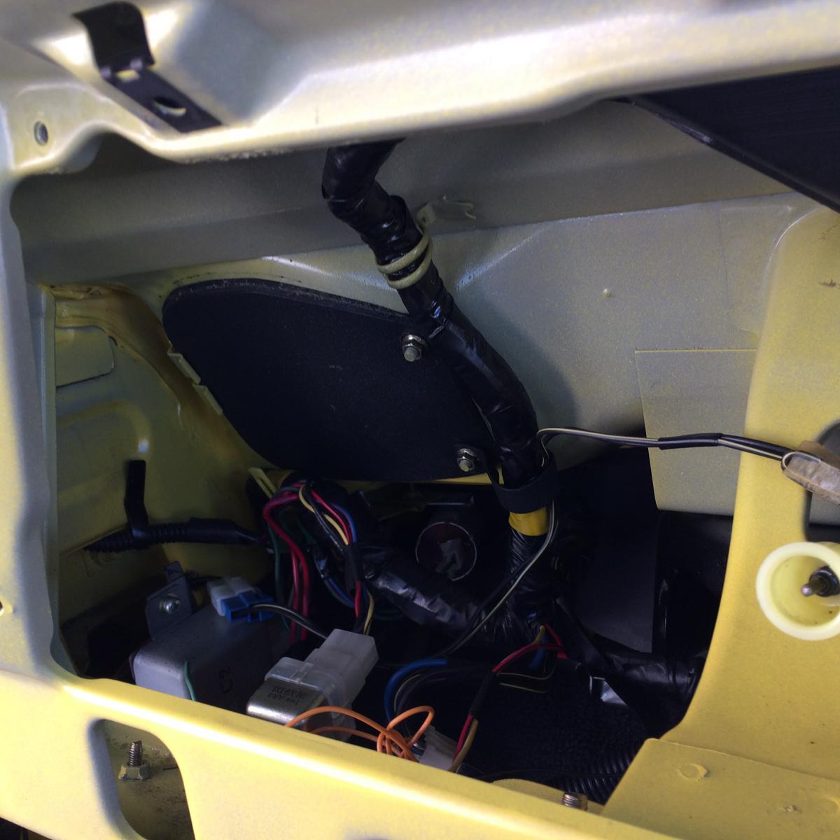

    If you are mechanically inclined it's a breeze. IMG_0519.jpgIMG_0520.jpgIMG_0521.jpgIMG_0524.jpg
    I don't have a write up.
    Sorry.
    You will need to remove the demister vent panel directly under the windscreen. It's anchored down with 4 x 8mm flare nuts (the demister diffusers are anchored into place by them). A handful of phillips head screws hold the hidden back edge of the dash padding to the dash frame (you will need a stubby screwdriver or one of those crank handle screwdrivers you sometimes get in flat pack furniture as space is limited). Pull the glove box, instrument panel, vent control cover panel, the big screw hiding under that plug in the dash, the instrument dimmer knob and the remaining screws on the underside of the dash padding that hold it up to the lower dash frame and you should be ready to pull the dash pad off. Removing the steering column cover may also add some clearance to pull the padding off.
