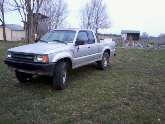

    Here's mine, I put 16" rims and 265x75R16 tires on it
