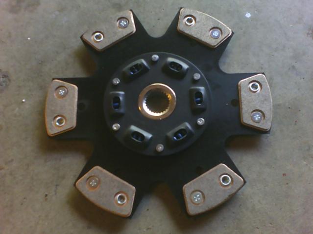

    I knew i would have to do something. What is your suggestion on the clutch?

    Ok. I think the game plan will possibly be to get as much out of the stock pump right now. Then figure out what I'm going to do to lower the compression. Once I get that done I'll add more fuel with a massaged 83 pump and honed injectors.

    I think the biggest issue you will start running into is figuring out how to prevent the tranny and clutch from failing when you try to put the power to the wheels.
    3,846
    Your local clutch shop should know where or have the ability to get one built for you. All they need is the disk and they should be able to get one from there. If not I know that Capitol Clutch and brake in West Sacramento can help you out. Or point you in the correct direction. Here is the one they made for me.

    I have had good success with the Centerforce II clutches.

    Ok. Well I'll get my turbo and manifold done. Then I'll start looking at the rest of the stuff.
    Here's a list of stuff I am going to do in order. Let me know what you think.
    12v glow plugs
    Turbo, intercooler, and manifold
    Clutch
