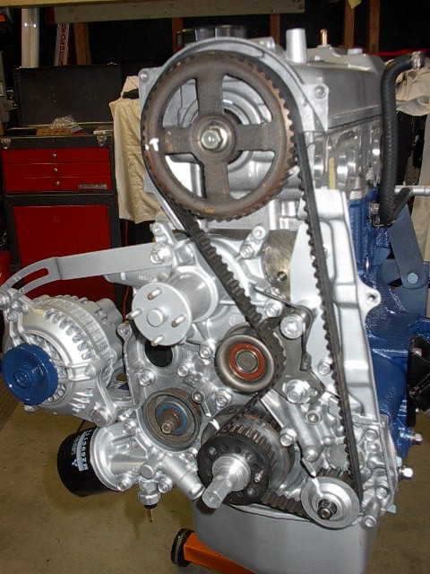

This is what it looks like lined up.
also check out http://mmeierle.com/images/Max/1G%20...2%20ENGINE.pdf
Page 11C-28 is the start of the removal and installation process from the factory manual. step by step, you will be fine...
Replace the B belt while you are in there.
