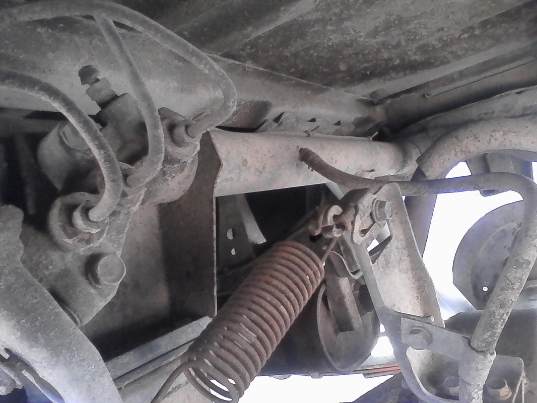

    Thanks pennyman1 and camoit. Just to make sure I don't get myself in deep trouble, is this the bleeder valve you are referring to?:
    Yes that is it.

    Yes that is it.
