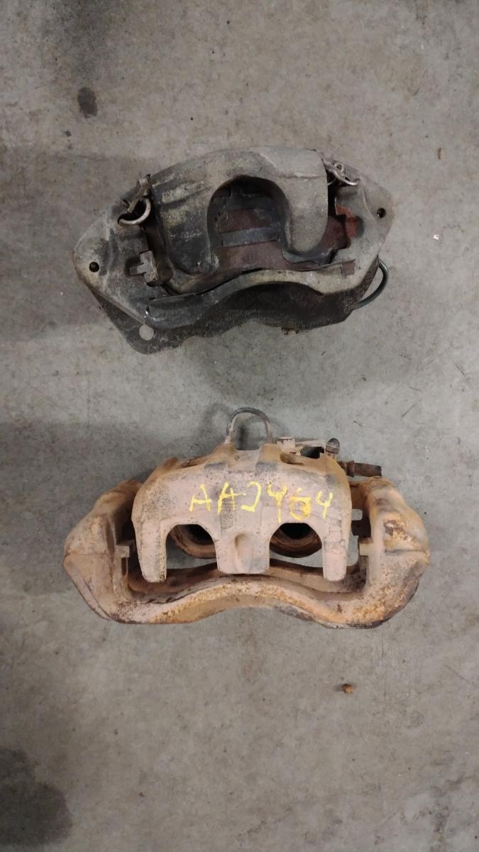

So I took the plunge and bought a pair of Gen 2 steering hubs and rotors for my Gen 1 brake upgrade. And I can confirm to all that have and will ask this question - yes, the Gen 2 caliper bolt holes are the same distance apart and threads/bolts are the same but are 'clocked' on an angle compared to the Gen 1's. I wanted to go the full deal and use twin piston calipers from a Montero (Pajero in Oz) but I wasn't able to find any in the JY but I did make an unexpected discovery. I noticed a pair of twin pistons on a 1998-2000 4WD Mitsubishi Challenger and decided to try out the fitment on the Gen 2 steering hubs - and they bolted up perfectly. I think the calipers are intended for a bigger rotor but they'll work (unless I can find a rotor to match them). Added note - the Gen 1 and Gen 2 geometries are the same (215mm high from ball joint to ball joint - 135 mm from centre of the bottom ball joint hole to centre of the tie rod end hole)

Instead of the bolt holes running parallel to where the ball joints align with each other, the top caliper bolt hole is directly in line with the ball joints while the bottom bolt hole is located more off to one side. The calipers' relation to the disc is still the same but now it is further up and away from the steering arm end. Put it simply - Gen 2 steering hub assemblies are a nut and bolt swap not needing any modifications. You could use the whole steering hub and brake set up as the floating caliper is an improvement over the fixed caliper on the Gen 1, but due to improved clearance of the Gen 2 design, twin pistons will mount up with the only mod (that I have seen so far...) is bending or maybe notching the backing plates a little.
Ouch Roy, that one stung a bitI haven't lost any further digits of late, I sorta more grind them down... And I did mean clocked. Gen 1 brakes mounts holes are at a '12 to 6' relation, while the Gen 2 brake mount holes are more '11 to 5'. Get your Gen 1 brakes fixed folks for cheaps! Better than using the back of a Semi
I'm still confused. i get the meaning now but you've added more confusion for me. As I understand it the gen 1 calipers are floating calipers (Solid piece bolted to hub floating piece rests on it.) and the gen two are one piece calipers (everything including piston in one piece) which can have one or two pistons depending on what kind you get. Where is the floating bit on the gen 2 if they bolt up direct?
