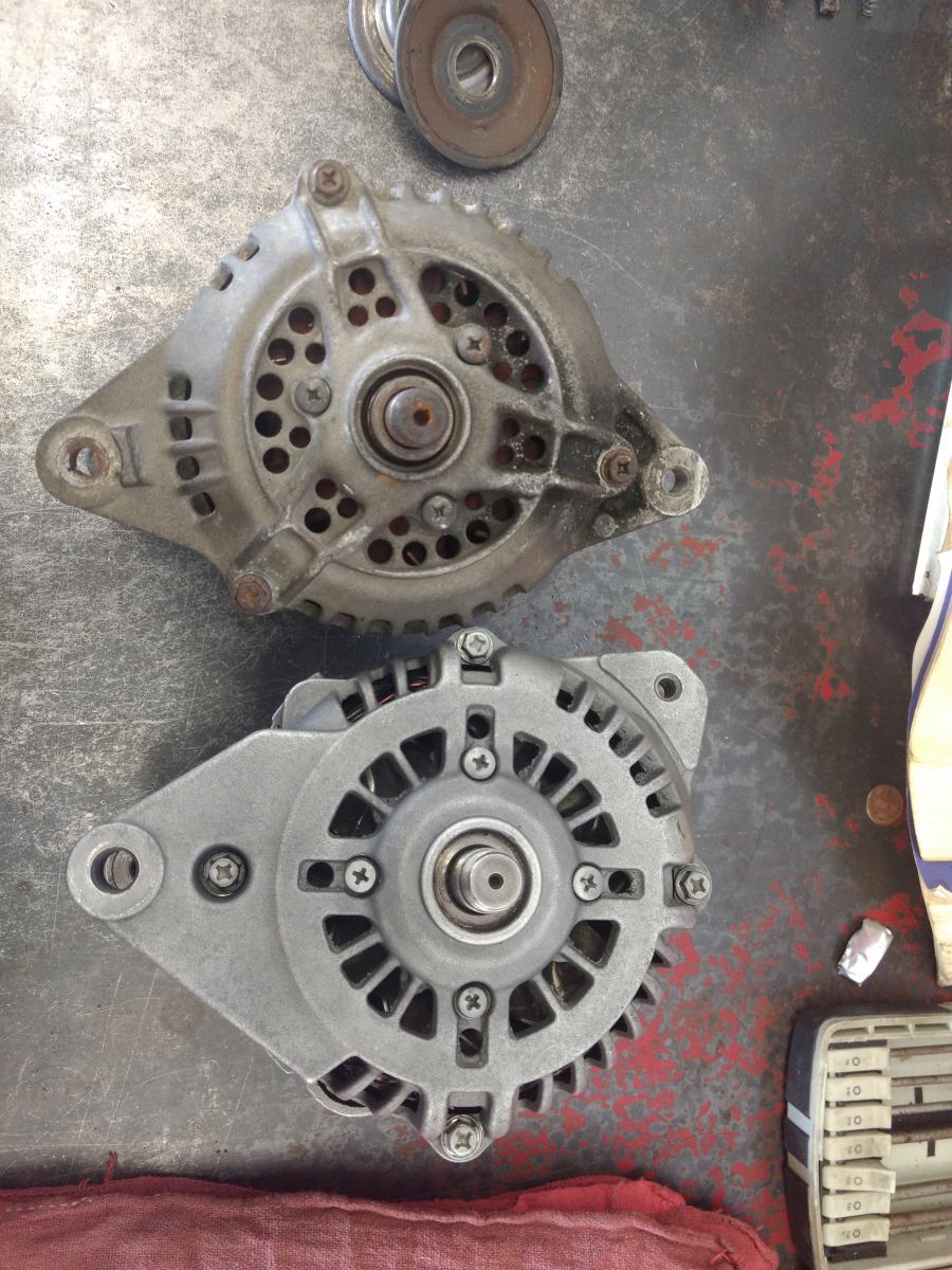

    15356595617921920901648980606048.jpg15356595617921920901648980606048.jpg also where the positive terminal comes out, you cannot get the oil dipstick into the dipstick tube.
