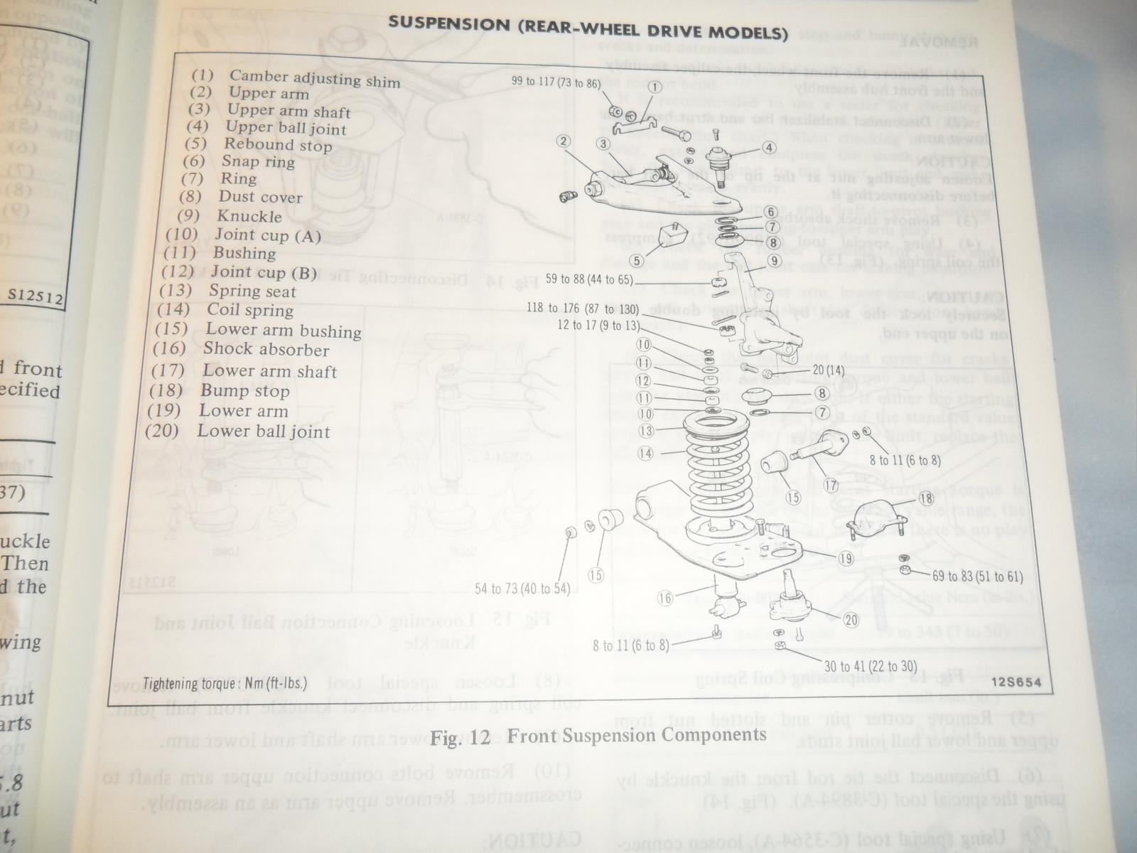

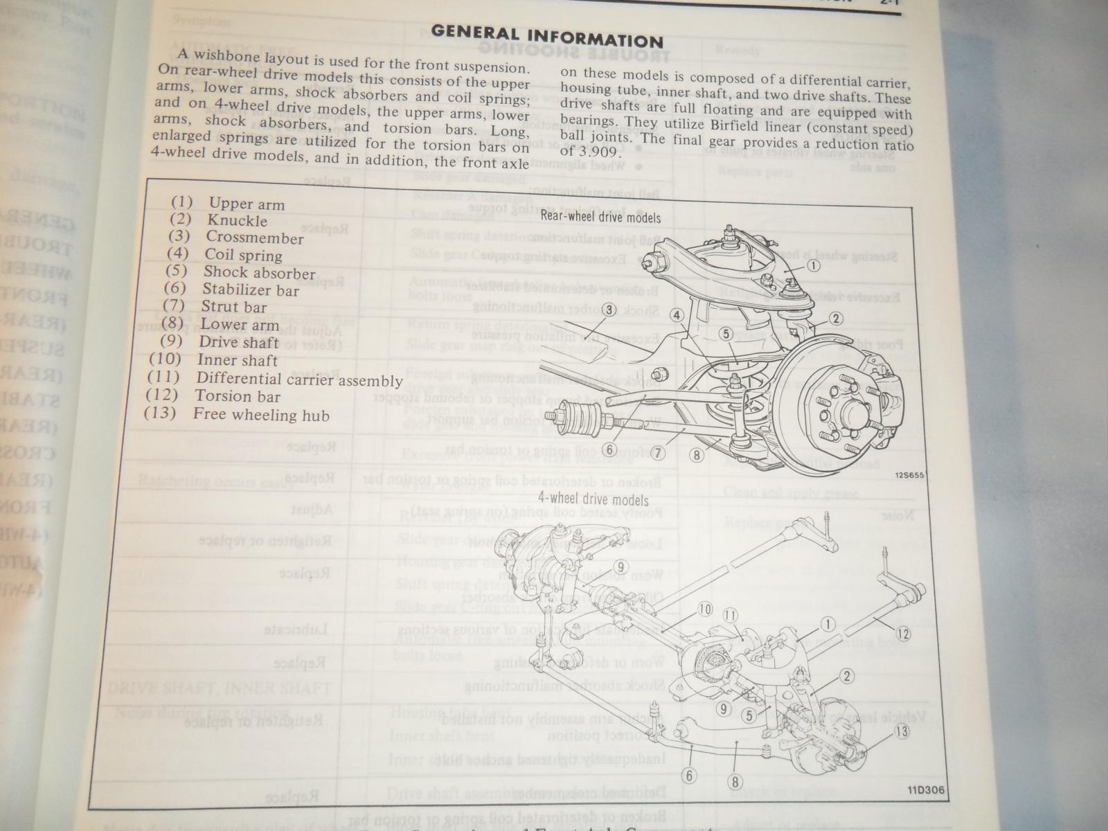

    I finally made myself look through my FSM and I thought these two pages might be helpful as they show a spread out pic with numbered list of the part names. On the second pic there are numbers in this format "x to Y (x to Y)" this is the torque spec Newton Meters and Foot lbs respectively.
    Oh yea do you have to have a spring compression tool? Or can I just take things apart?
    I want to make my FSM a PDF but it is in real good condition and the only way I have found to do it requires me to destroy the binding. I might get one that is a little worse off and do it down the line.
    No spring tool needed, just have a jack under the lower control arm when you start unbolting it/pulling parts off so that the coil doesn't spring out of the pocket.
