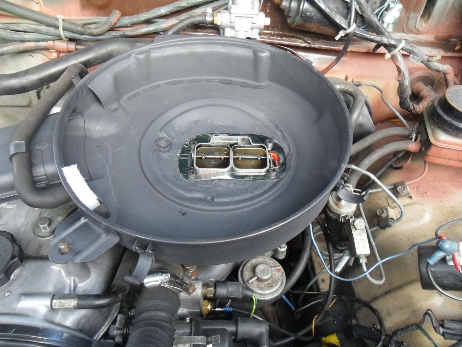

    This is still a work in progress but you can see it can be done.
    I am not a pro just making due with what I have because I hate being overcharged.
    Stock Air cleaner mod to Weber carb
    I put the air cleaner over the spot where it goes and did my best to mark the correct orientation of the carb cutout and marked it inside with silver sharpie.
    I ground cuts into the circular part that extends out the bottom. Slice it like a pie down to where it flares to level with the flat bottom. More cuts = easier bending.
    Then I bent each piece down trying to straighten the lip. It occurs to me that if you have a good cutting wheel you could cut this lip off first. I had a general idea of what to cut off and did with tin snips and the grinder. I hammered the body of it as flat as I could with a 16oz ball peen on a 2X10 board. It is a process and even when you are done it won’t be flat.
    Then I held it over the carb to make a better marking for the shaped cutout. I got close and set in top. It became clear I would need a spacer. I was going to get a piece of alum cut but it would have been as much as a new carb. I found some cork tile at Joann Fabrics and it will do the trick. spacer materiel.jpg bottom plate on the cork.jpg
    At this point I am close I got the shaped hole cut open to allow the air cleaner body to set on its mounts and sit on the carb with two spacers. I probably need to use the other two spacers I have left. I will need to get longer bolts for mounting this securely to the carb. I am going to use JB Weld to plug those two holes in the pan and fix up my cut out. Then a short bolt to plug that threaded hole. When I get there if I can’t get the holes for the mounting bolts cut in the cleaner pan just right I will probably use the Weber air cleaner bottom mount plate to secure the air cleaner by sandwiching it. Might use it anyway. not perfect.jpg it fits.jpg

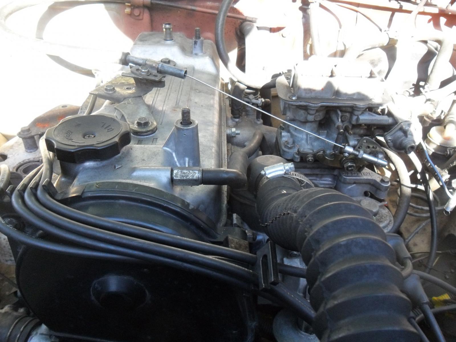

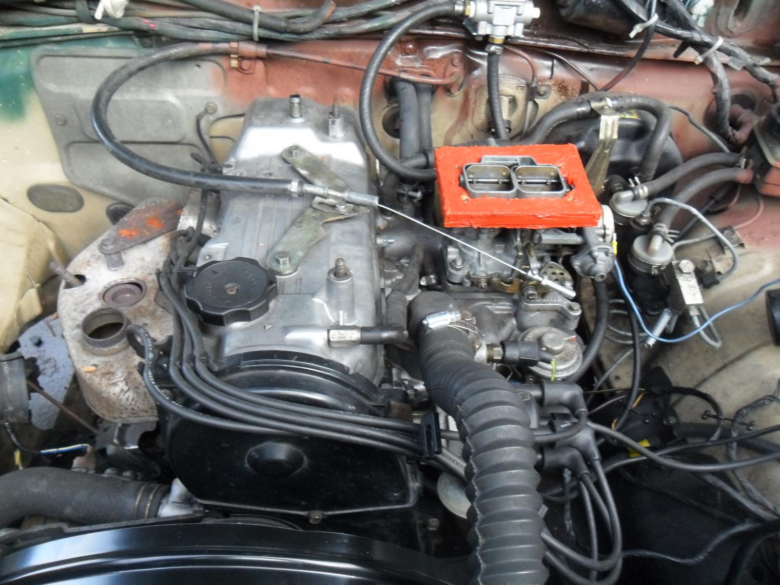

    Turns out the accelerator cable mount is in the way. !!?? How can that be? I have it off in the pics.
    It is mounted on the piece that I guess was OE on top of the valve cover with both cover bolts through it. It looks like I will have to get a new longer cable to push through the housing and mount the anchor point in a different hole on the valve cover.
    Any ideas there would help.

    The top of the Weber fuel bowl cover/throat inlet has 4 threaded holes so unless you've already drilled holes through the modified air cleaner box and screwed the 2 components together, you will need to do that (I can't see any screws in the pic but that might just be me). They will need to have decent washers under the screw heads as well or they'll eventually stretch the metal and pull through it. This will also clamp the air cleaner down onto your new seal and prevent air leaks. I'll be doing something similar when I can get back to my truck, but I'm using an oval air box from a different G63B engine. Trying to find the original round one was nigh on impossible

    I'm pretty close just waiting for stuff to dry. I used some gasket maker to glue the 3 pieces of cork together. Once I got it all fit I used a good knife (we call it a rubber knife in the insulation trade) and using a square cut the sides to square. I have coated the whole thing in that gasket materiel and am letting it dry while also waiting for the JB Weld to fully cure. That gasket stuff will give the cork some strength and prevent it from sucking air between the tiles and let the bottom of the cleaner pan seal to it. I got new bolts of the same size as that faccacta (SP?) air cleaner but 1 1/4" long. They are 6 or 8 X 1.25 EDIT I'm pretty sure the 1.25 is the thread pitch not the length I figured out that I can leave the throttle cable in its place after I had it mounted and screwed down tight to the top of the carb by actually attaching it while the air cleaner was bolted down. It rubs so if anyone has ideas or knows the right way for it to be run let me know please.

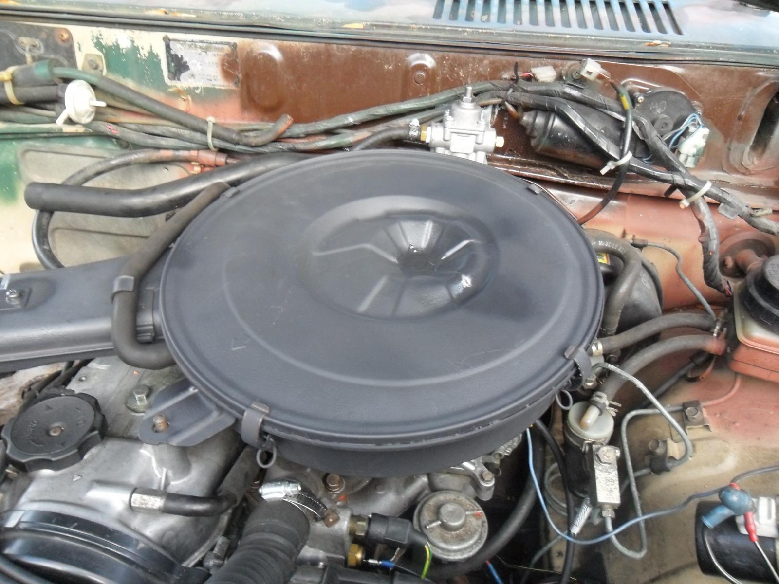

    Done.
    I had to modify a couple of the bolt holes in the OE cleaner pan. I'm sure you guys will be more accurate than I was in placing them to begin with. Maybe use the gasket from bottom plate of the old square one as guide? I figured out the throttle cable, rotate that mount bracket between the valve cover bolts 180 both ways and eliminate the riser. view PCV and throttle cable.jpg Throttle cable fix and finished spacer.jpg
    This resulted in having to shorten the cable .
    I placed the spacer on it fits, snug. Set the OE cleaner pan on it and then used the gasket from under the bottom pan to trace and cut out the bottom pan from the square air cleaner being replaced. Put it over (the silver part) the top of the OE cleaner pan and put the bolts through. mounted showing intake.jpg using old botttom plate as washer.jpg
    The hose for the valve cover goes where I thought it would and I have no idea what used to accept that other hose I'm sure it is emissions stuff. Maybe I'll replace it when I rebuild this gas hog.
    I don't have the filters for it yet but it started right up and I have nothing but high hopes . lid strapped on.jpg
