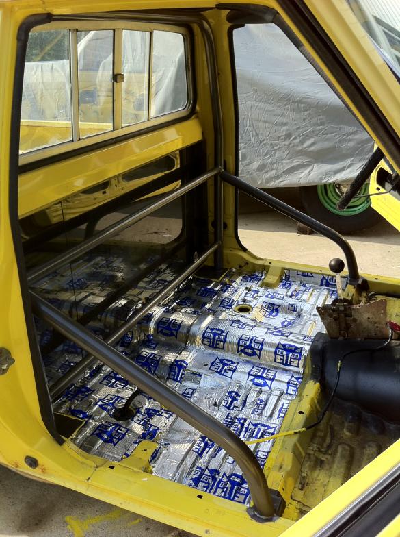

    So what is the heat shield stuff? Name and manufacture please....
    77
    Morgantown, KY
    1980 Plymouth Arrow Truck
    Fat Mat, eBay, less than 1/2 the price of Dynamat! They do have a web site, but I just found it on eBay, did the math, and bought it there.
    I didn't do any further forward than the front seat rail because I was going to do more firewall mods, but have decided against that. Now I need to find or build a heater that fits up there before I finish up the insulation.
