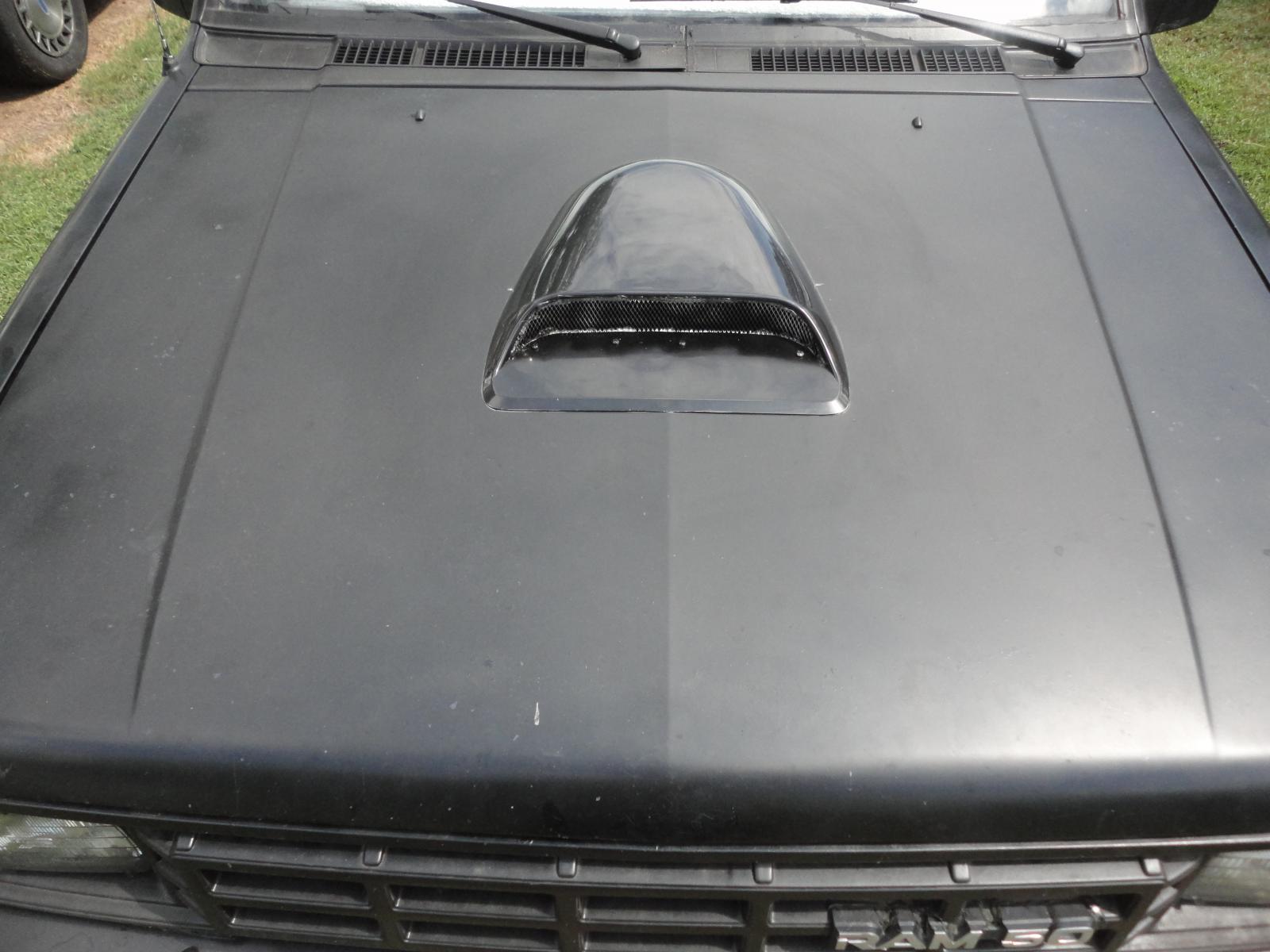

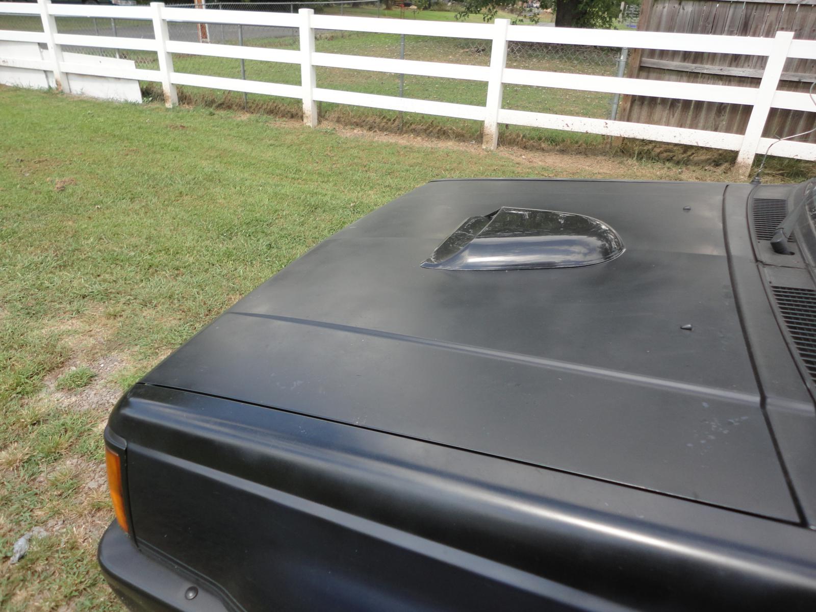

    well after messing with the run on issues i think i have finally figured out what the problem is the weber is getting hot from the heat of the water running threw the intake and the heat of the engine also the heat of the day. so i got a hood scoop and installed it on the truck and low and behold no more run-on plus the bright side is it looks cool lol DSC02877.jpgDSC02878.jpg
    This is unfortunately one of the drawbacks of using a Weber without a sealed air intake. The under hood temperatures aren't good for a carb like the Weber (or any other carb for that matter) - if you can rig up a cold air intake directly to it you'll make gains all round and it will fix issues like the ones you've experienced.
    Nice job with the problem solving!
