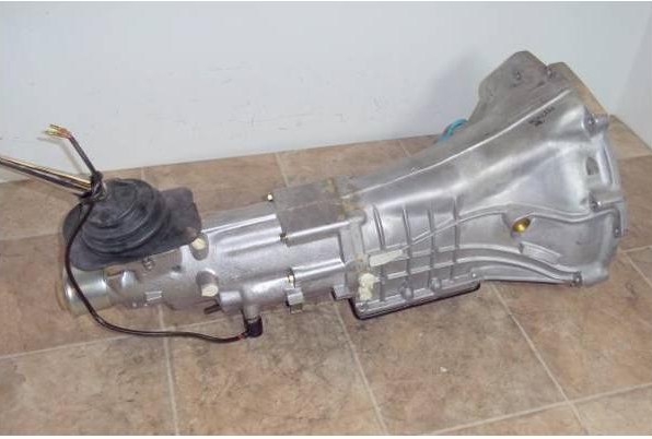

    Will this 5speed trans "Dodge D50 5 speed manual transmission. 21 spline output, and 20 spline input. This shows no witness marks of ever having been installed, see pics. Research tells this fits 82-89 Dodge D50. Please research and make sure that this will fit your application. All the info I have on this is listed or pictured." fit that motor and my rig as is? or will I have to change the drive shaft? They show a pic with these numbers stamped on the case in ink; 9C42354 NL I haven't contacted them to ask any questions yet.

    the 2.6 will fit, the 5 spd will work IF it is a wide bolt pattern and the motor is from a 5spd truck. You may have to shorten the driveshaft and modify or change the cross member.
