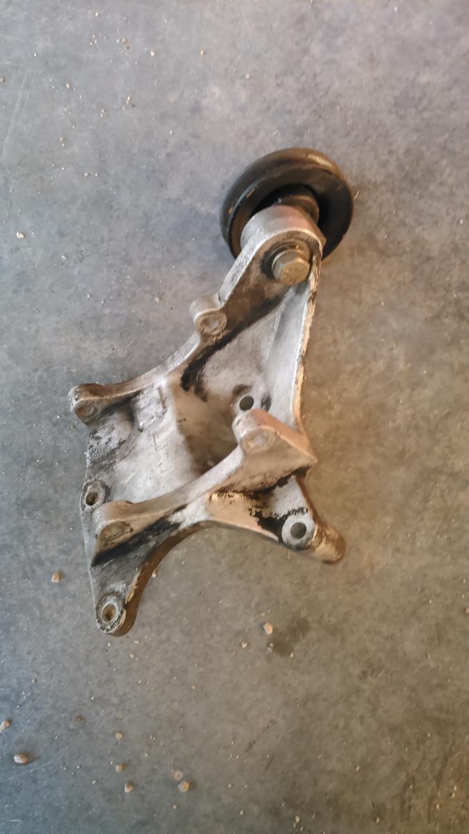

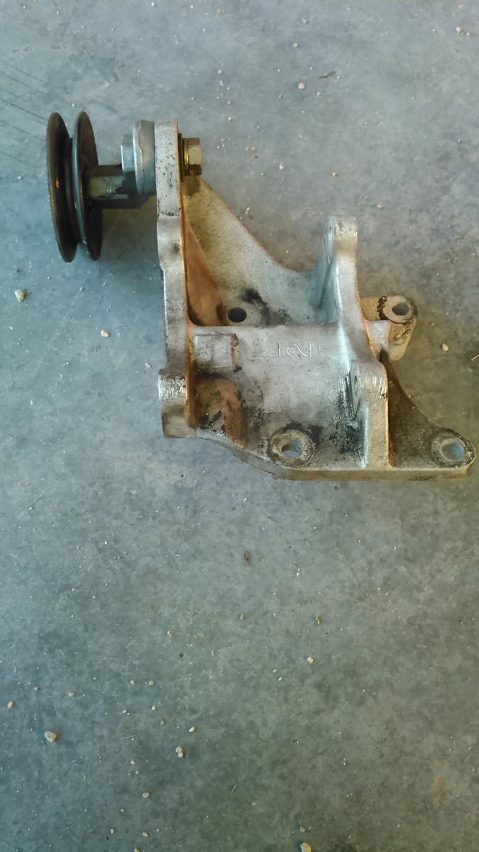

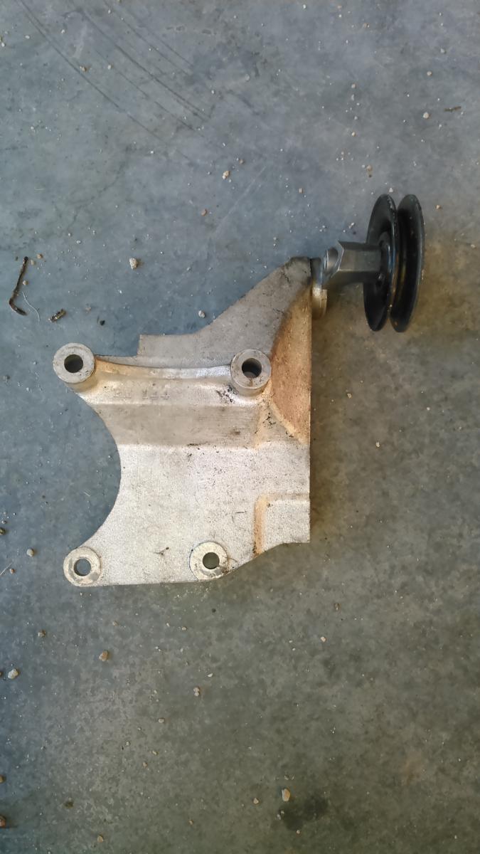

    I have one that I can take a picture of. As far as I understand the 2.0L motor has the same as the 2.3L diesel; being that the bolt holes are the same. I have a bracket from a 2.0 motor and that is what I will send your direction. I should be able to get you a photo this week.
    I have no advice as where you can find one though. Sorry.

    Skullzaflare is correct. I have my block back from the machinist and tried to line up the ac bracket to where I thought it was supposed to go. Doesn't line up. On the 2.0 engine it appears to wrap around the balance shaft, where in the 2.3 it sits above it. I'd have to add some spacers, get longer bolts, and move a hole on the bracket. I still am including the pictures though, even if it's not the right one. At least give you something to brainstorm about.

    this is off the 89 2.0 i just pulled
