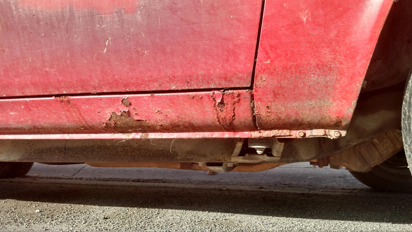

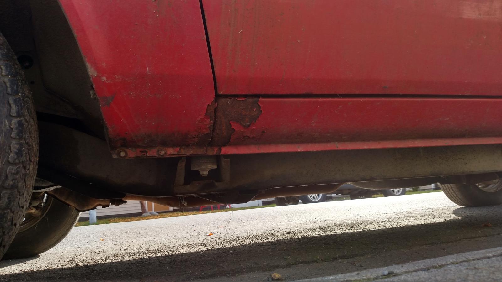

    Has some rust but i think ill be able to fix it before it gets any worse
    IMG_20160919_111638821_HDR.jpgIMG_20160919_111649986_HDR.jpgIMG_20160919_111700226.jpg

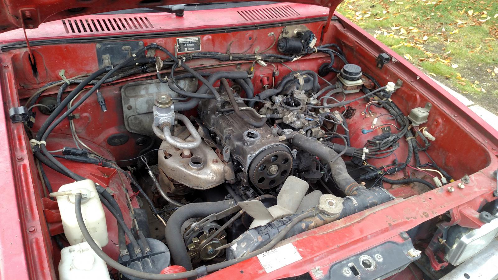

    Engine turns over (manually) belts look good which is surprising its missing some things like plug wires, igniter, oil cap, simple stuff. The oil looks like its reverting back into dinosaur poop though ha ha.

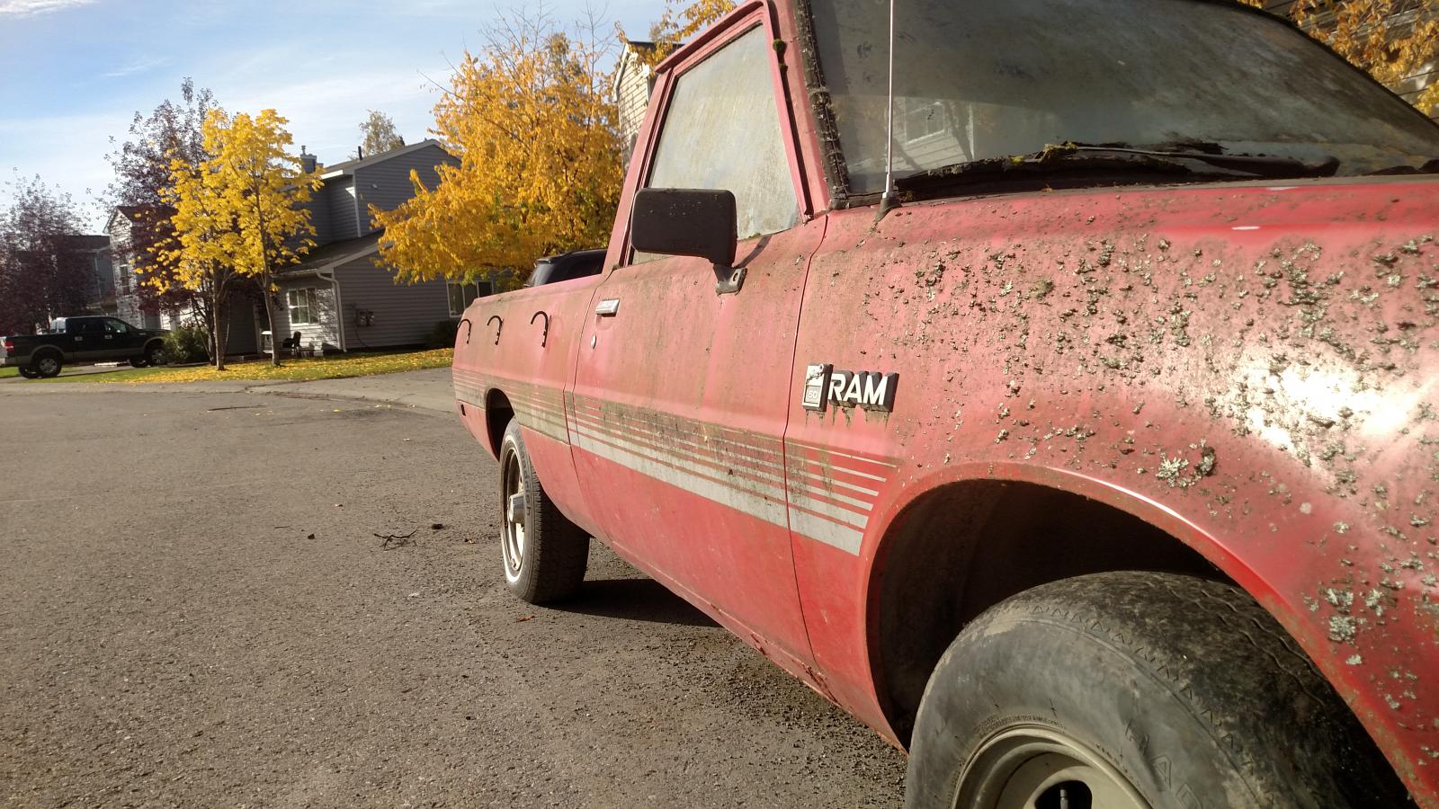

    After I pressure washed some of the crap off of it. Unfortunately some of the pin striping came off with the dirt :/ but aw well I'm gonna have to wash and wax and I already found a paint scheme i want anyway...
    IMG_20160920_111019128_HDR.jpgIMG_20160920_111028005_HDR.jpgIMG_20160920_111040519_HDR.jpg

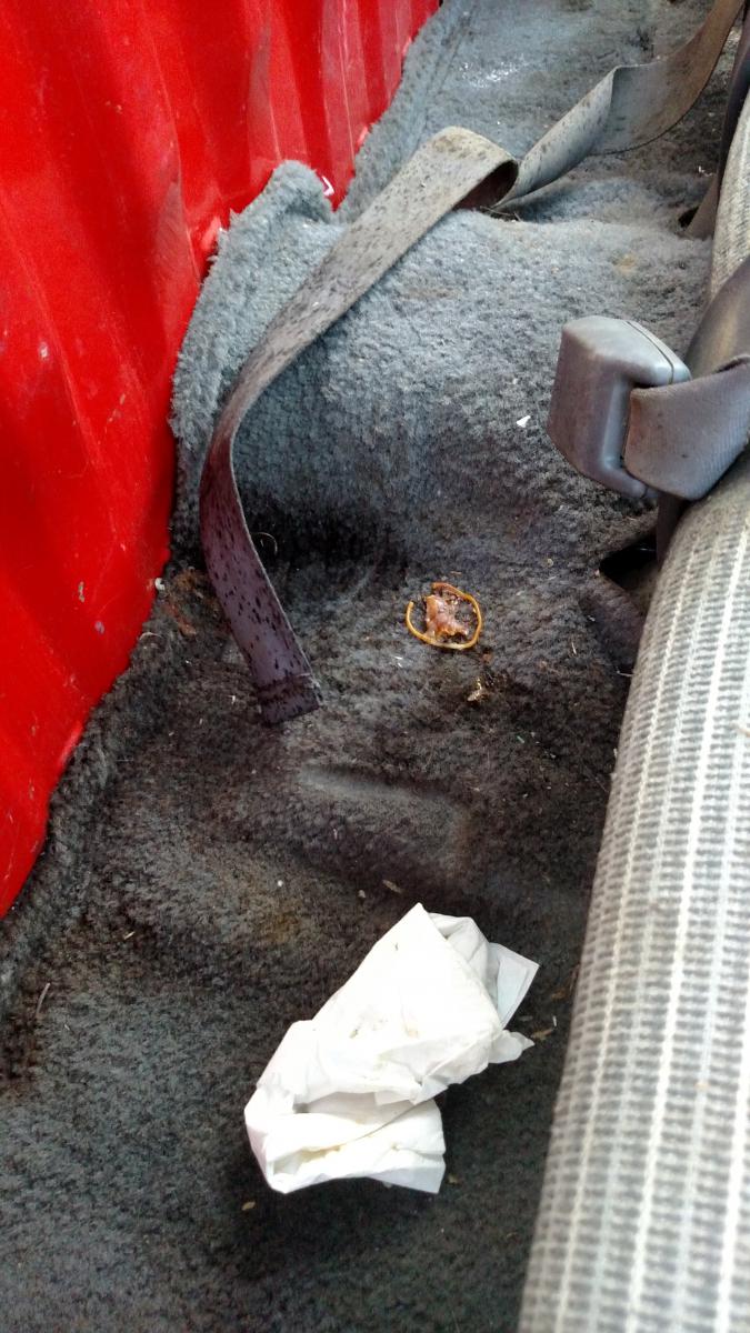

    Honestly i expected there to be more rust under the carpet! pleasant surprise!
    IMG_20160921_173716745.jpgIMG_20160921_173730093.jpgIMG_20160921_180758372.jpgIMG_20160921_180813425.jpg
    Nasty
    Skittles bag from 96! ha ha
