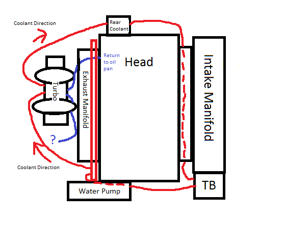

    Also, I'm trying to understand DroppedMitsu's build guide but his pictures are kinda fuzzy from what i can see its done something like this diagram i made but where does the oil feed to the turbo from? I see the oil return going into the pan but does the turbo get its oil from the pan as well?Untitled.png

    You can grab oil from the port where the oil pressure gauge goes. The drain should never be less the 45 deg if you can help it. Any oil sitting in the return will cook in the turbo.
  4. #54
    The turbo gets its oil from the back of the cylinder head on the passenger side. You'll have too much oil pressure and need to run a restrictor if you use a port on the oil filter housing.
    So this is where you got the feed for the turbo DroppedMitsu?
  6. #56
    Yes, that is the OEM turbo feed location.

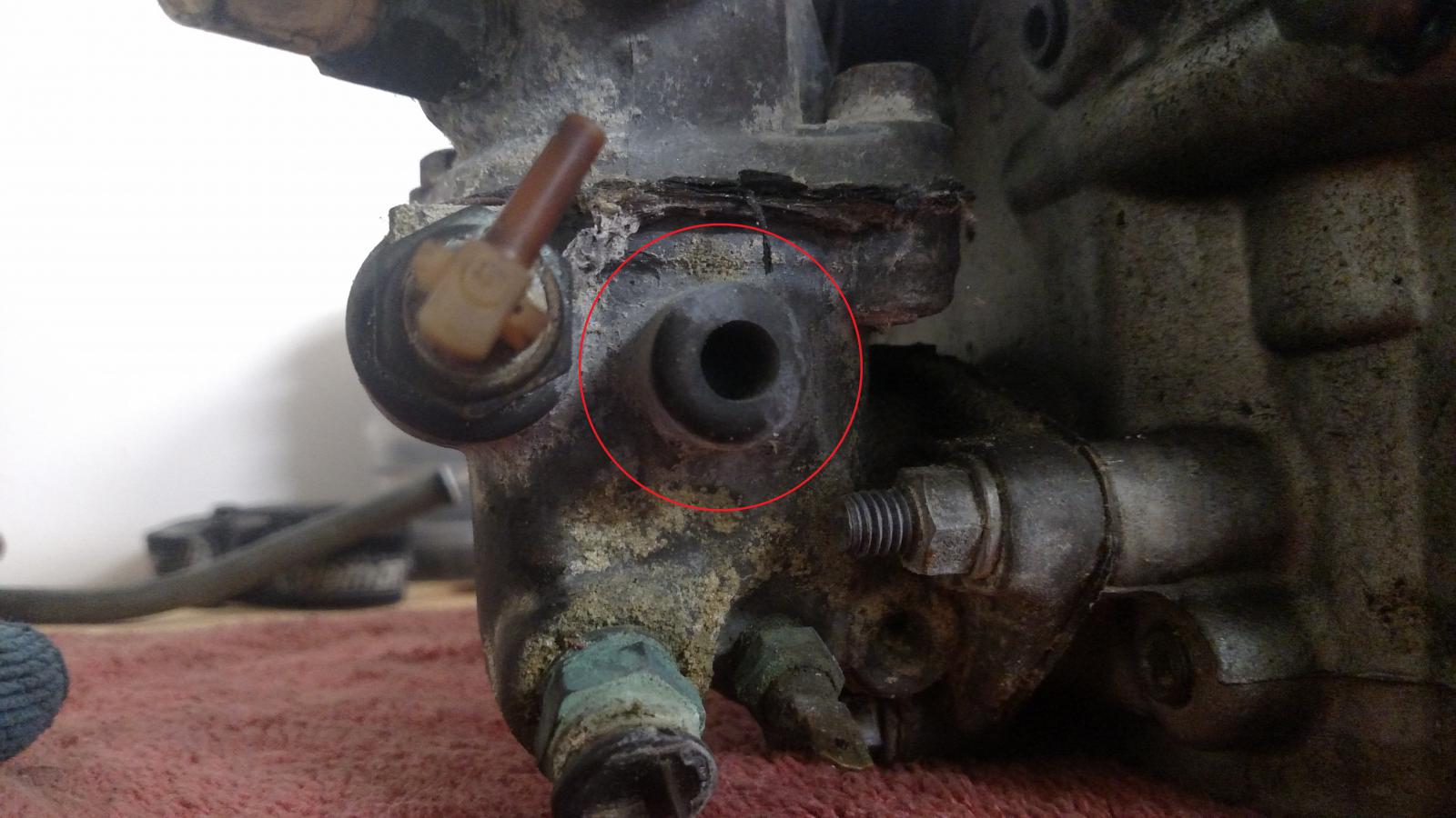

    as far as the coolant locations i know the feed comes from a modified coolant pipe off the water pump. and returns to the back of the head where the coolant return is, i saw that there is a nipple looking thing with the hole blocked off. was this where you drilled out the hole you where talking about?
  8. #58
    Yeah thats where my return goes. I ended up drilling that spout out and tapping it for an AN-pipe thread fitting and im running all braided hose and an fittings for all my oil and coolant lines.

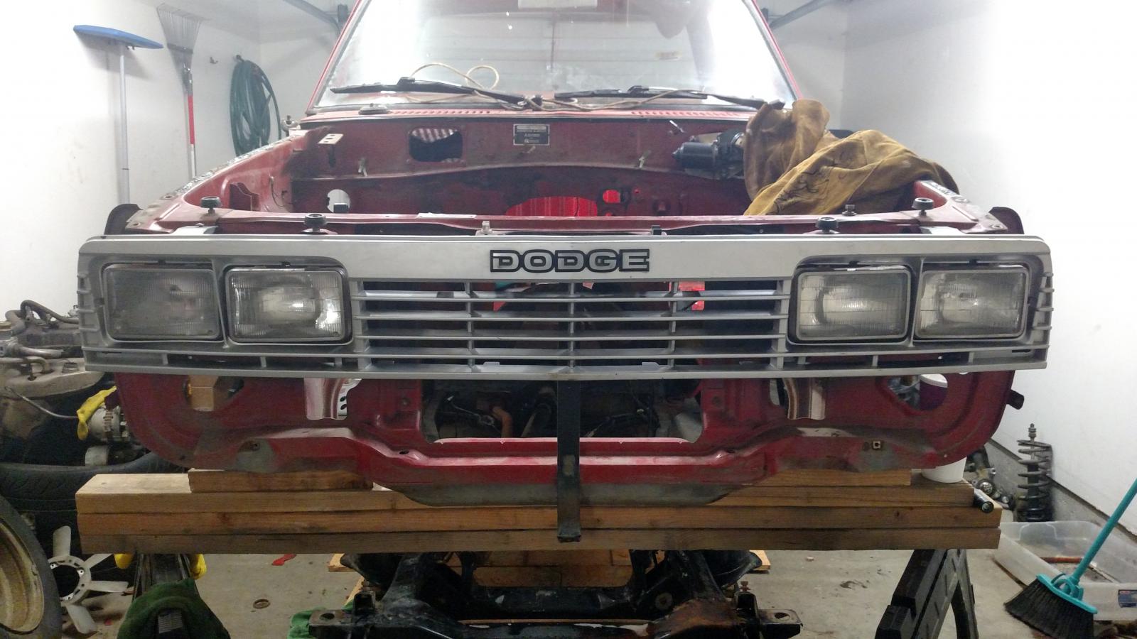

    Sorry for the delay with the project! Money dried up for a little bit. Engine is awaiting going to the machine shop which is waiting on the money for their hard work ha ha. Gonna go with factory 2g pistons on the 1g rods and run the 14b turbo to start, might switch over to a 16g if i have the cash down the line. Wifes cooper is in the garage awaiting a tie rod and a ball joint to come in so the truck is sitting out in the cold. good thing i taped the window up that is broken and falls down ha ha. Today i finally started tearing apart the beat up door cards. planning on buying new particle board and possibly doing a new design or just redoing the factory design with new material.

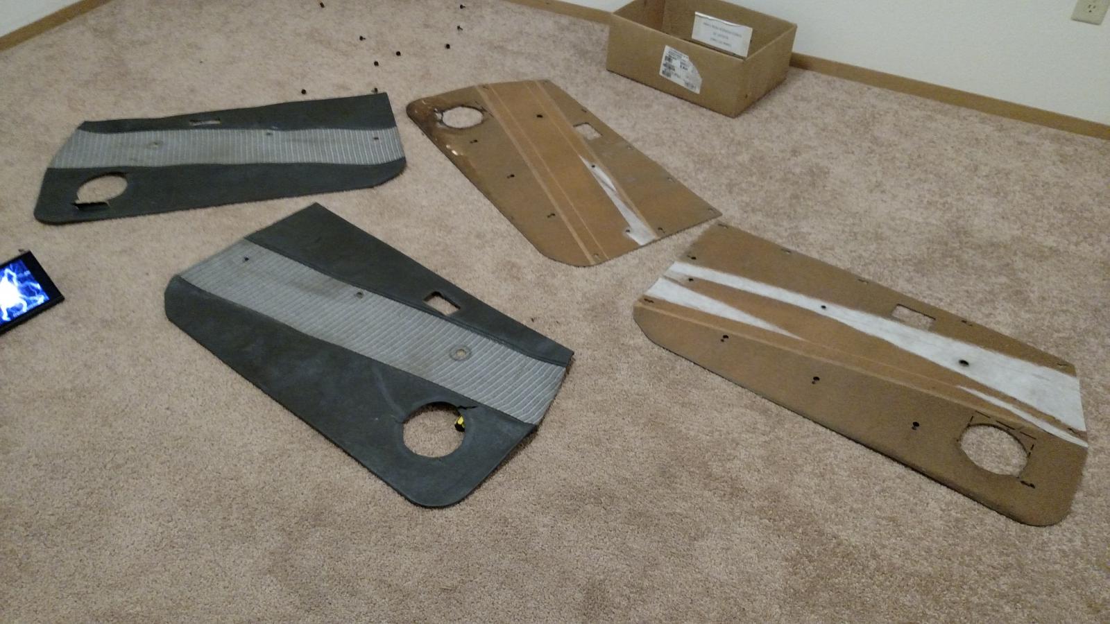

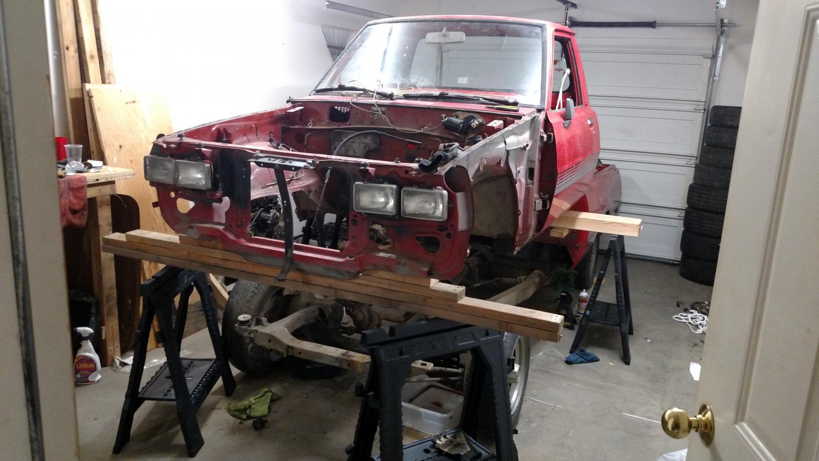

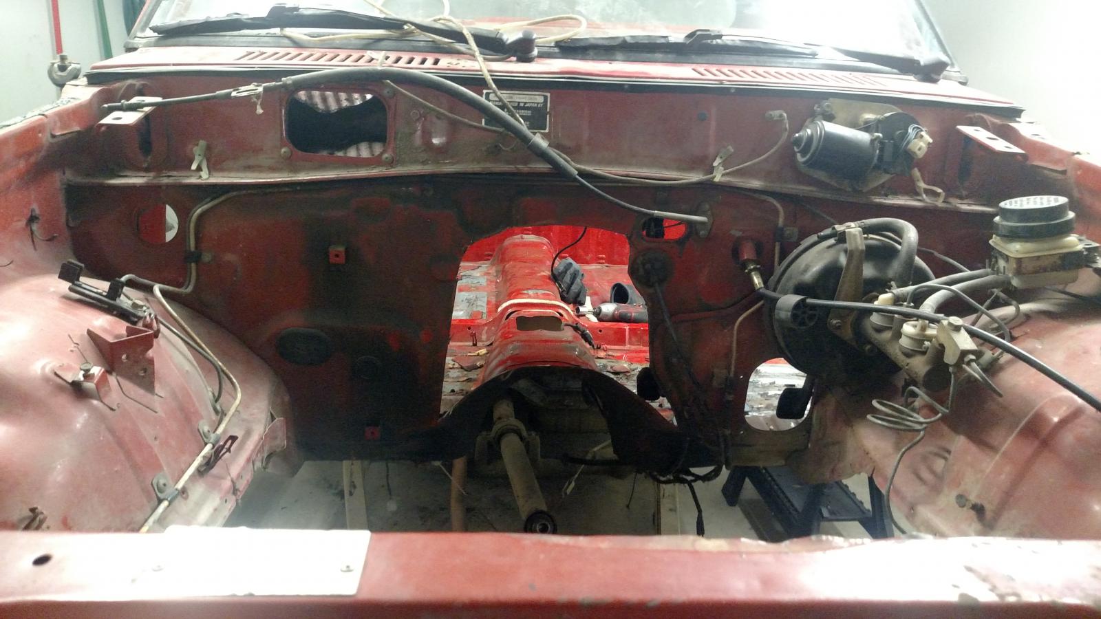

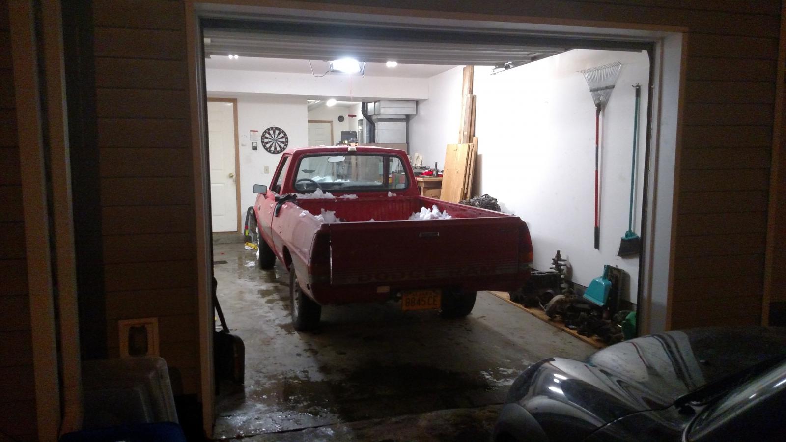

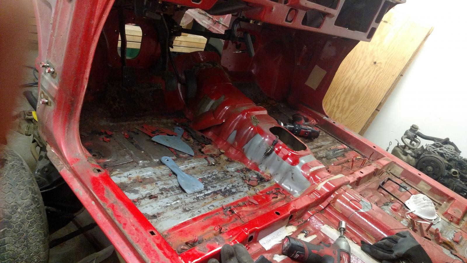

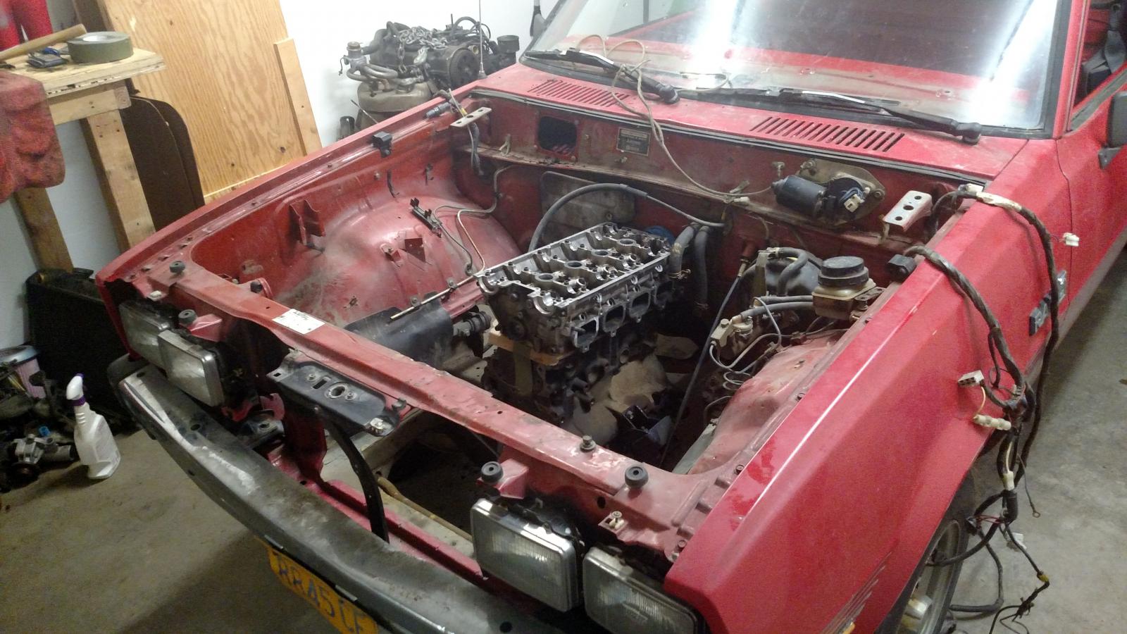

    More updates! finally got the truck in the garage after getting all my other mini projects completed. and got the block and head in so i can start figuring out how much i need to mod the firewall. turns out its going to be about 2.5 to 3" just like stated in other threads. the heater sits right behind the spot i need to move out so i might look into relocating it to the passenger foot well if i cant space it out enough to fit in the factory location. but progress.... Got the interior ripped apart and ragedy old dash pulled out. i imagine finding another one thats not all torn up is going to be close to impossible so i might just make some kind of custom dash that is built off the non removable dash frame.
    IMG_20170126_185024507.jpgIMG_20170127_160834189.jpgIMG_20170127_205833207.jpgIMG_20170127_205840214.jpg

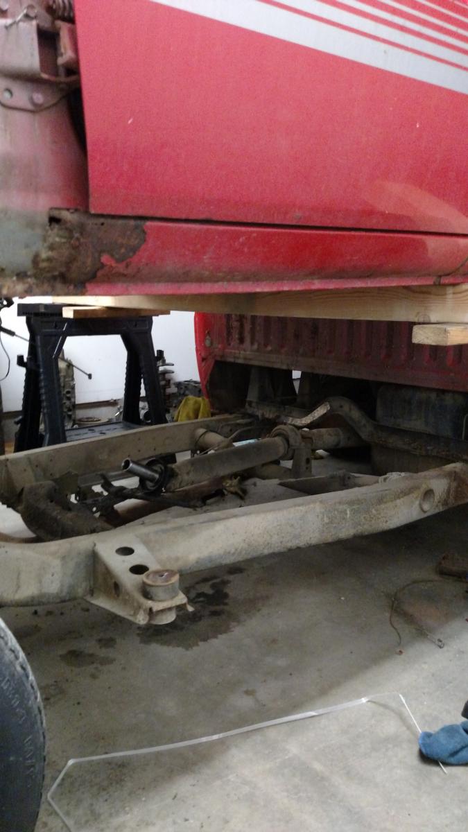

    body lift be looking good ha ha. im thinking about hanging the cab from the ceiling with some rope to mod the firewall and weld in new floorboards. would be alot easier having it like 3-4' off the ground. plus i could mount the engine and tranny on the chassis a hell of alot easier.

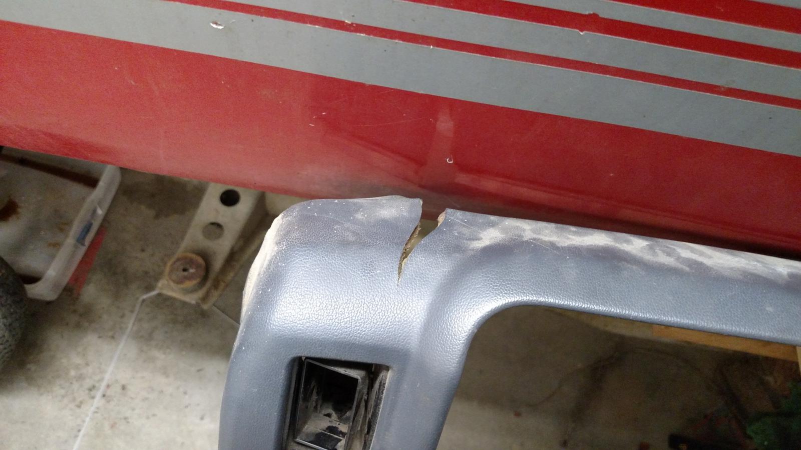

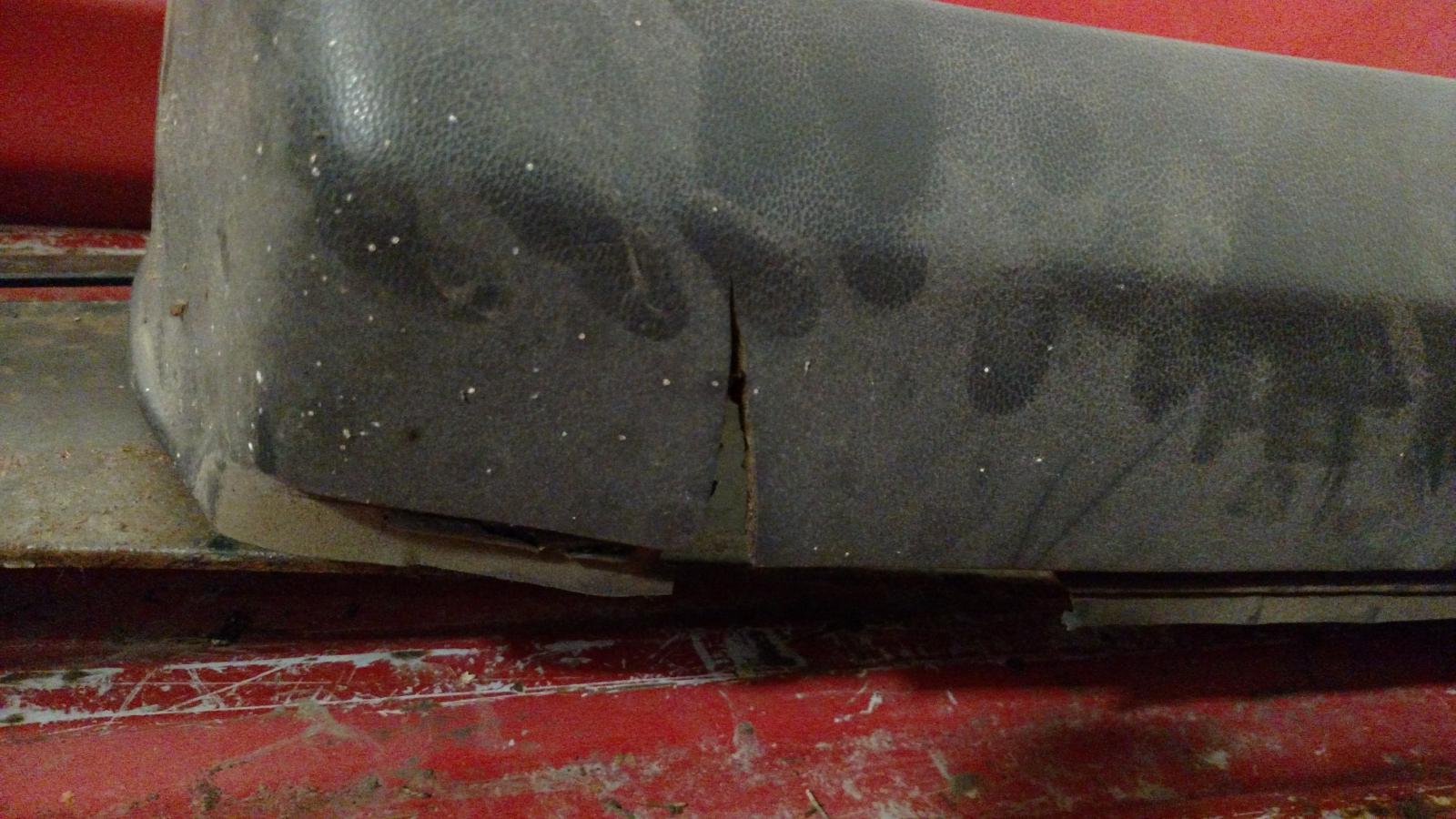

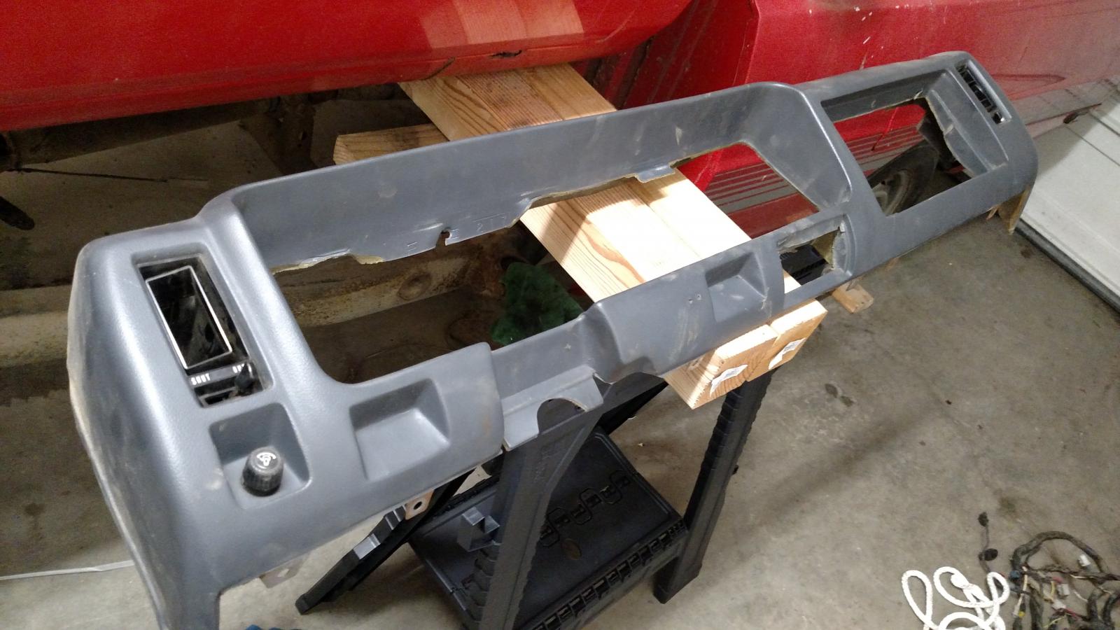

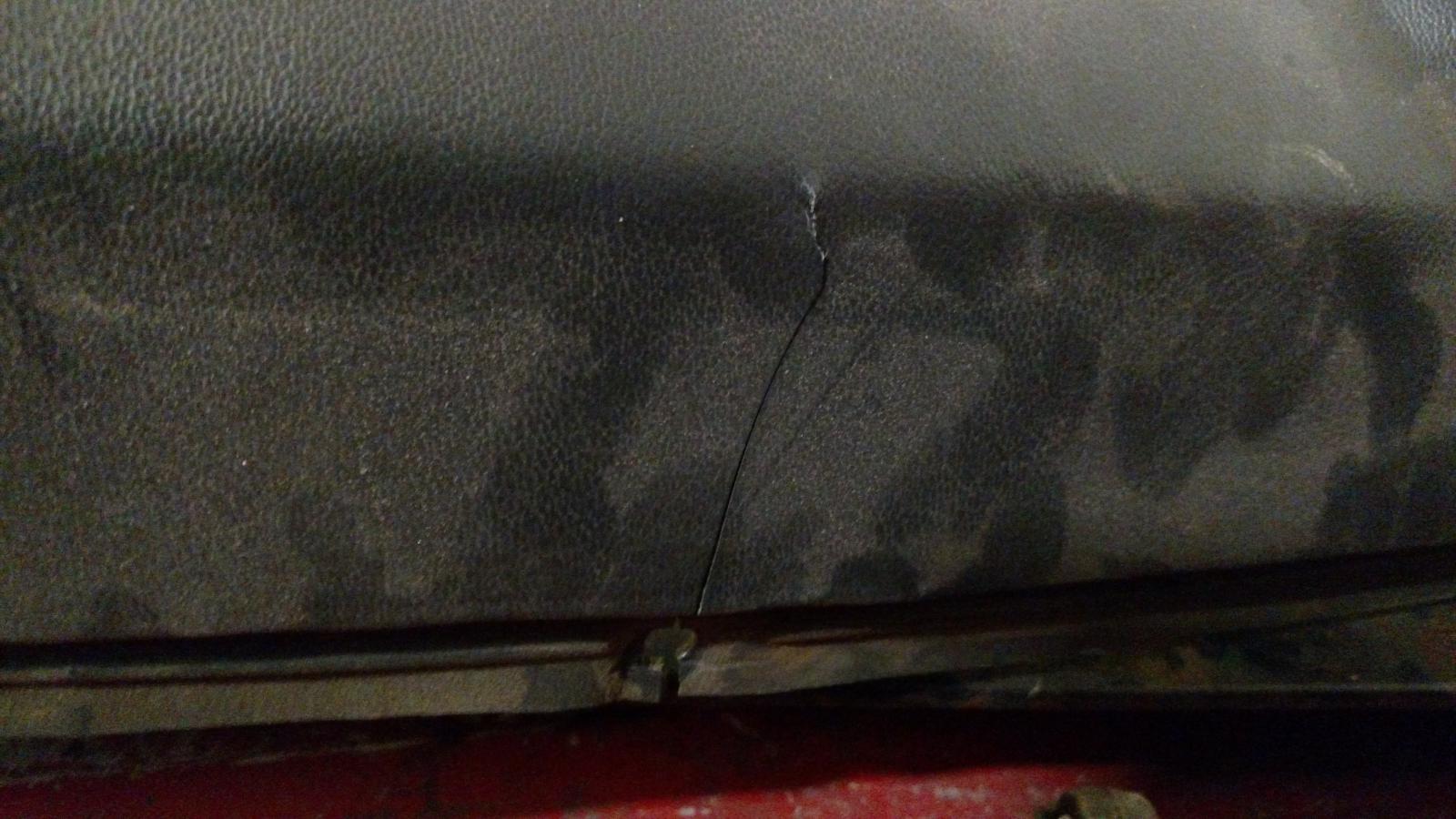

    So i looked into the dash and i suppose its not to bad. what do you think?
    IMG_20170204_232958742.jpgIMG_20170204_233005805.jpgIMG_20170204_233028049.jpgIMG_20170204_233040837.jpg
    Also... body lift got a little higher ha ha.
  17. #67
    Are you going to recolor the dash? The worst crack is obviously the one on the corner of the instrument surround. I'd trim off the edges where it has split and curled up, fill it with expandafoam, then glue in an offcut of vinyl to fill the void. Hit it with vinyl color spray and fingers crossed the repair will be discrete. If you're going to recolor it make sure it is super clean. Scrub it with sugar soap and hit it with a pressure cleaner (sounds sketchy but as long as you use a wide fan setting on the nozzle and don't try to blow holes through it, the new color will bite into the dash padding permanently and not flake off like paint - I did this myself and you'd be amazed at what oil and gunk is embedded in a dash...) The smaller cracks you might be able to get away with filling it with RTV and wiping it smooth with a finger.

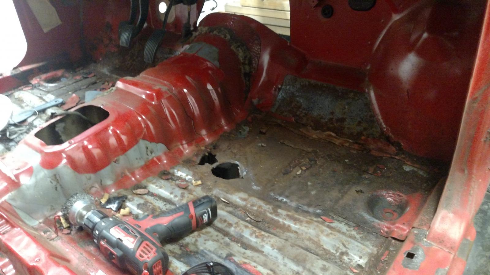

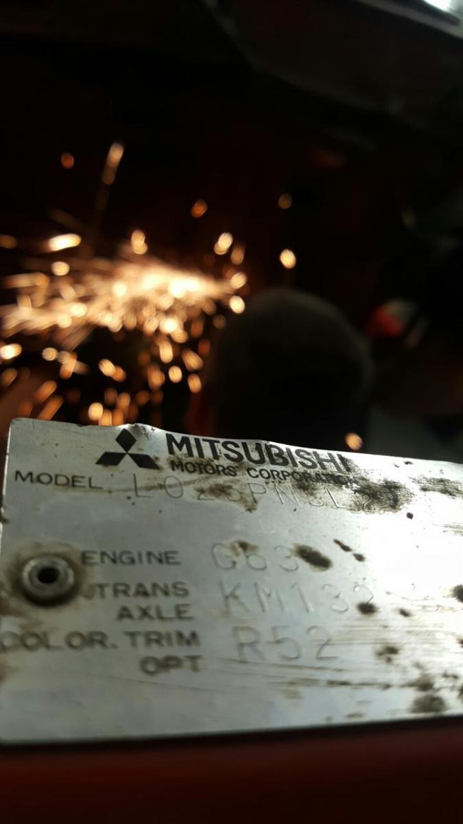

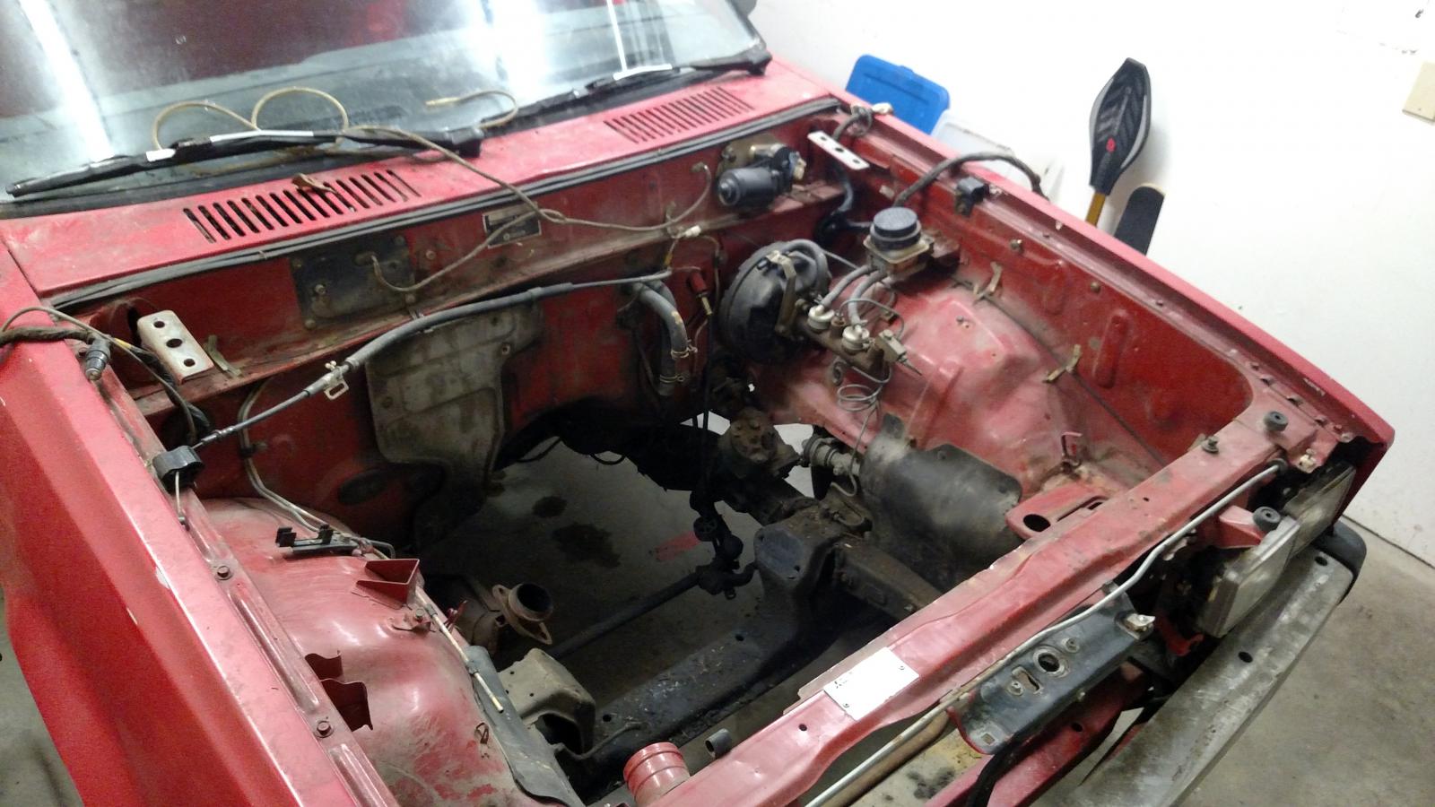

    Going to look into the dash another day. for now its all about grinding and cutting. Started grinding at the floorboards and most of the floor seems to be pretty salvageable.
    Also cut the hole for the firewall extension. debating about, how exactly I'm going to do it but for now I'm planning on taking the piece i cut out and making little extensions and welding it back in place. or just get some sheet metal and making a rounded cover to weld into place. unfortunately it seems there was no way to keep the factory mounts for the heater. looks like I'm going to have to find a alternative I'm sure summit or moroco make something for like old hot rods that's a "universal heater" kind of thing.
    also cool shot my friend made while i was cutting.

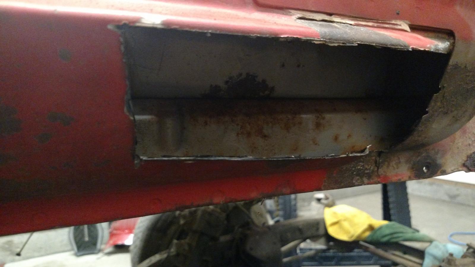

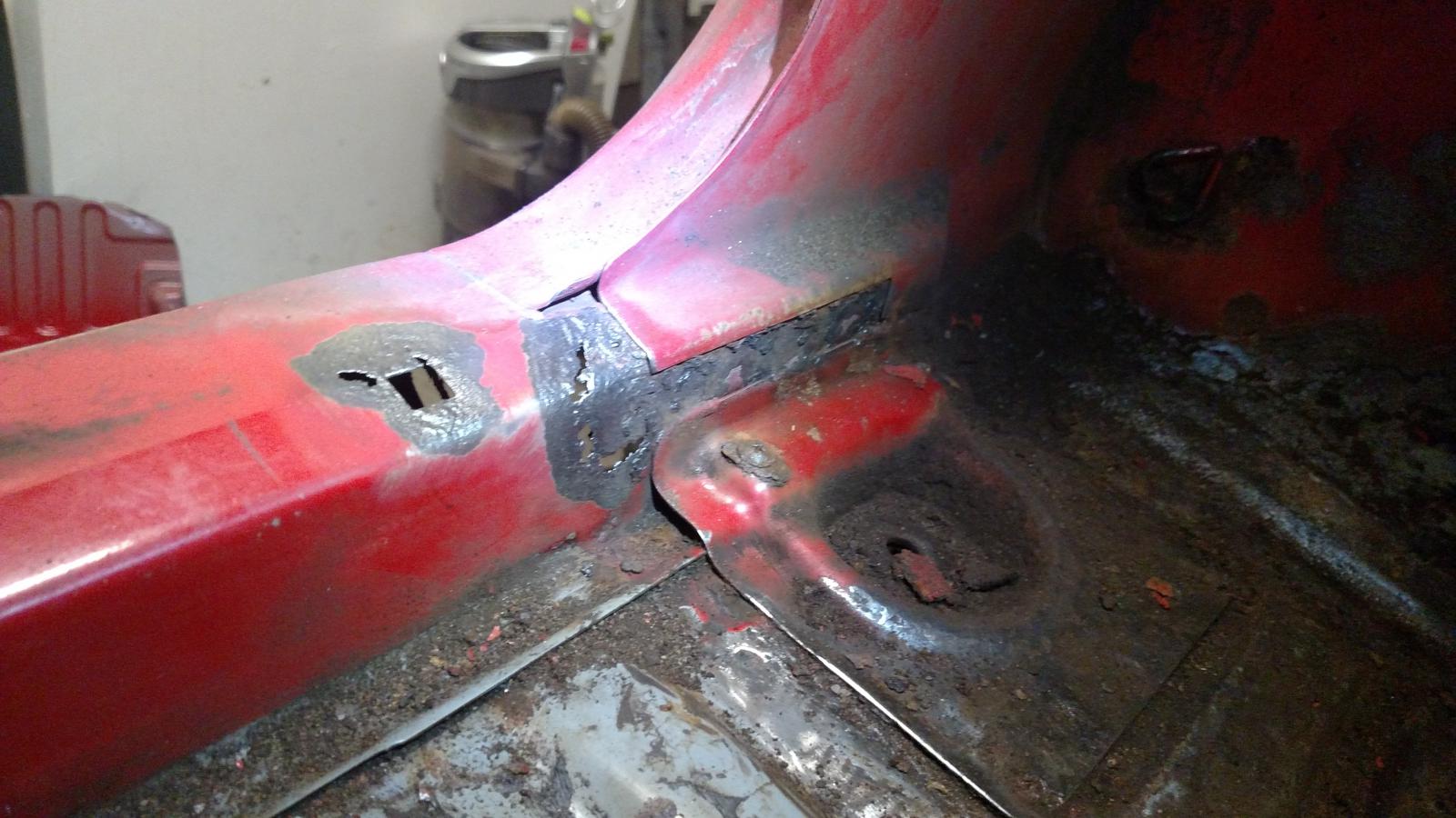

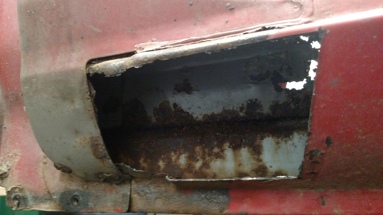

    well started cutting stuff out and the passenger side looked better than i thought but the drivers side is rough. looks like im going to have to cut and fill a lot of holes. the rust has eaten through into the cab where the front body mount is and has started to eat through to under the body where the pinch weld is. I hope I can find a way to cut it all out and weld in new pieces without loosing the factory shape. I'm sure trying to find replacement weld in parts for the cab is impossible ha ha. but on the bright side, the drivers side floor looks to be in ok shape and the passenger side is going to be east to fix. I managed to cut out a square that seemed to eliminate all the major damage.
    IMG_20170207_190013154.jpgIMG_20170207_190027918.jpgIMG_20170207_190039968.jpgIMG_20170207_190049233.jpg

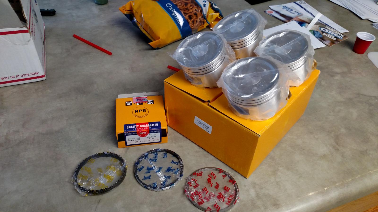

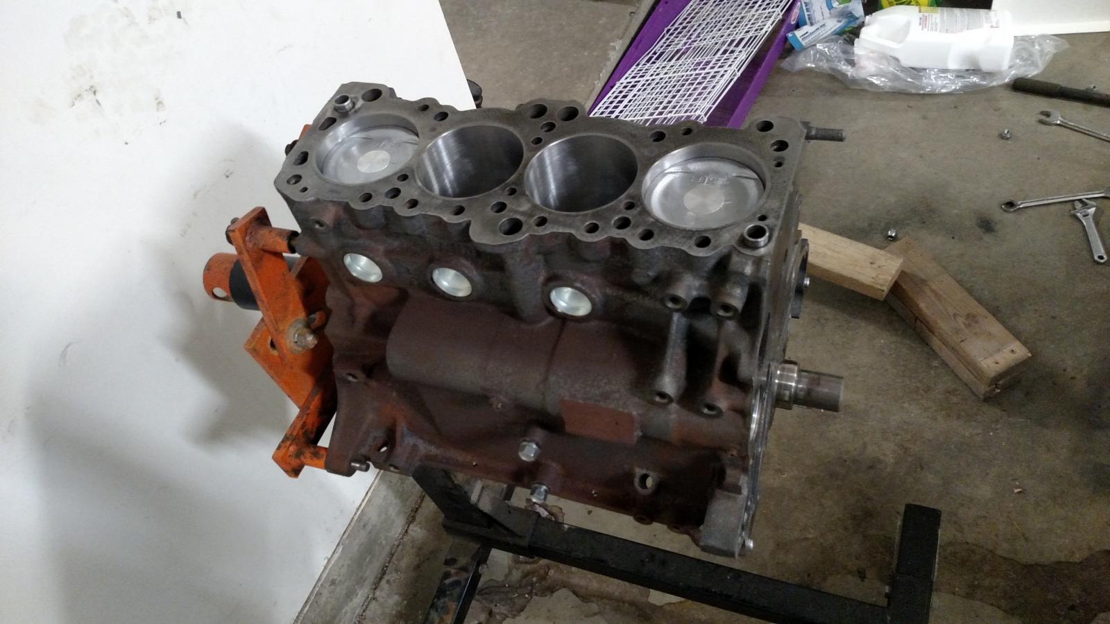

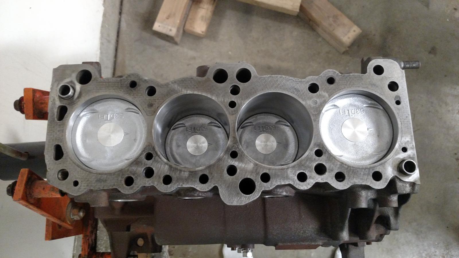

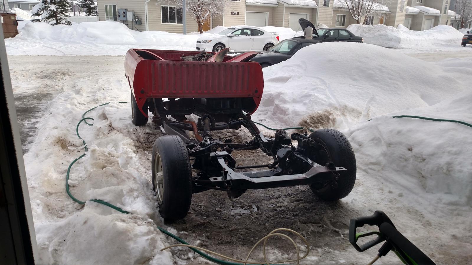

    So some updates:
    Finally rolled the chassis out to pressure wash the chassis to get ready to paint it. Gonna do the front, then when i have the cab back on I'm gonna take the bed off and do the same thing.
    Then something came in the mail!!!

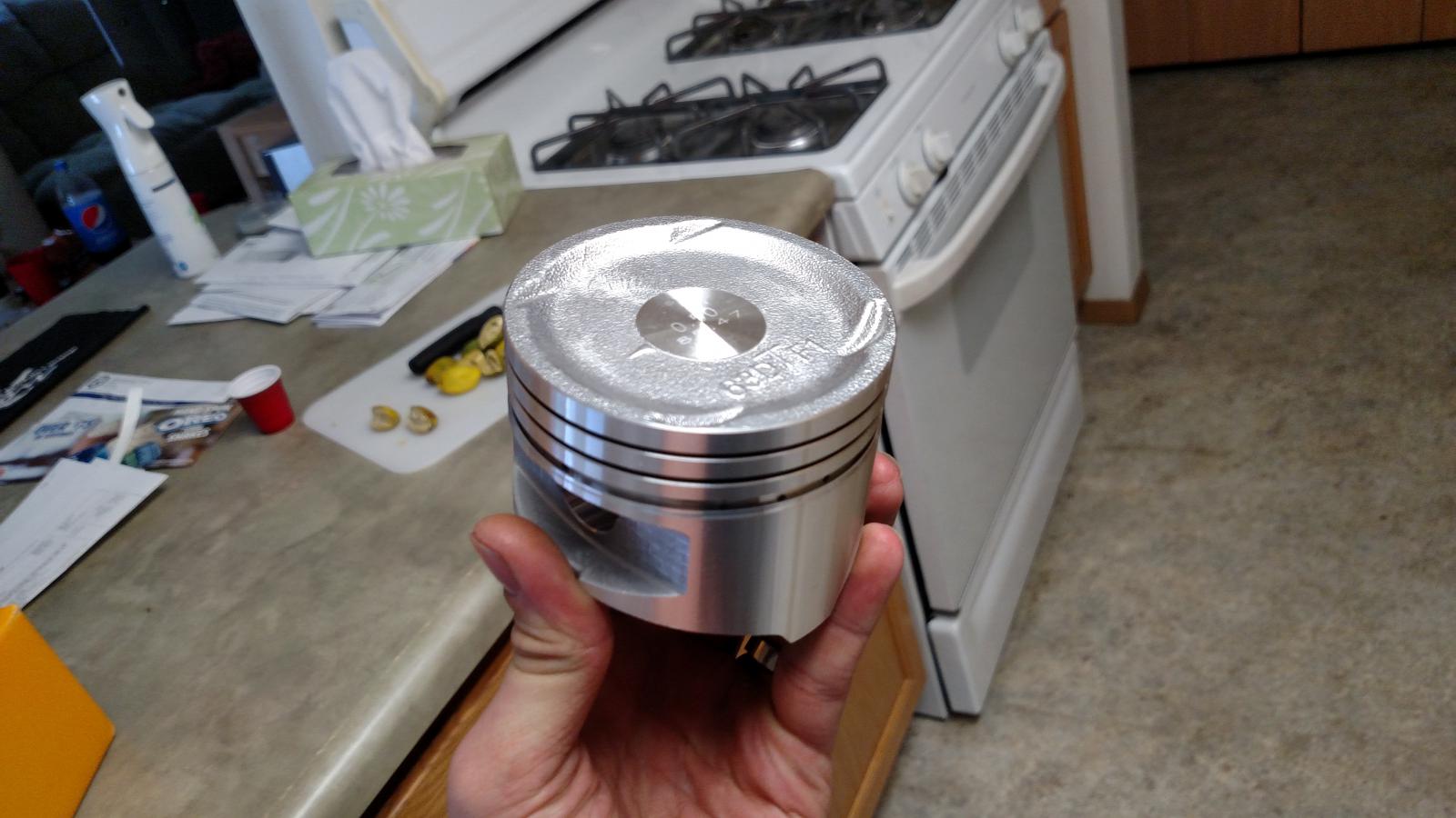

    Dropped those off at the machine shop and thanks to Uncle Spence here on the forums i got my missing grill! Thanks dude!
    Also dropped the pistons off and got the block back from the machine shop! Looks fancy.
    Unfortunately the money dried up again and the project is going to be on hold financially for a few months again.
