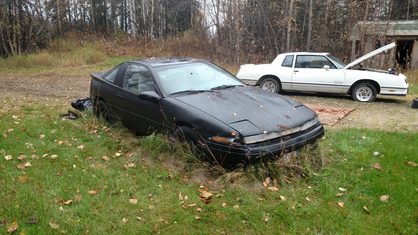

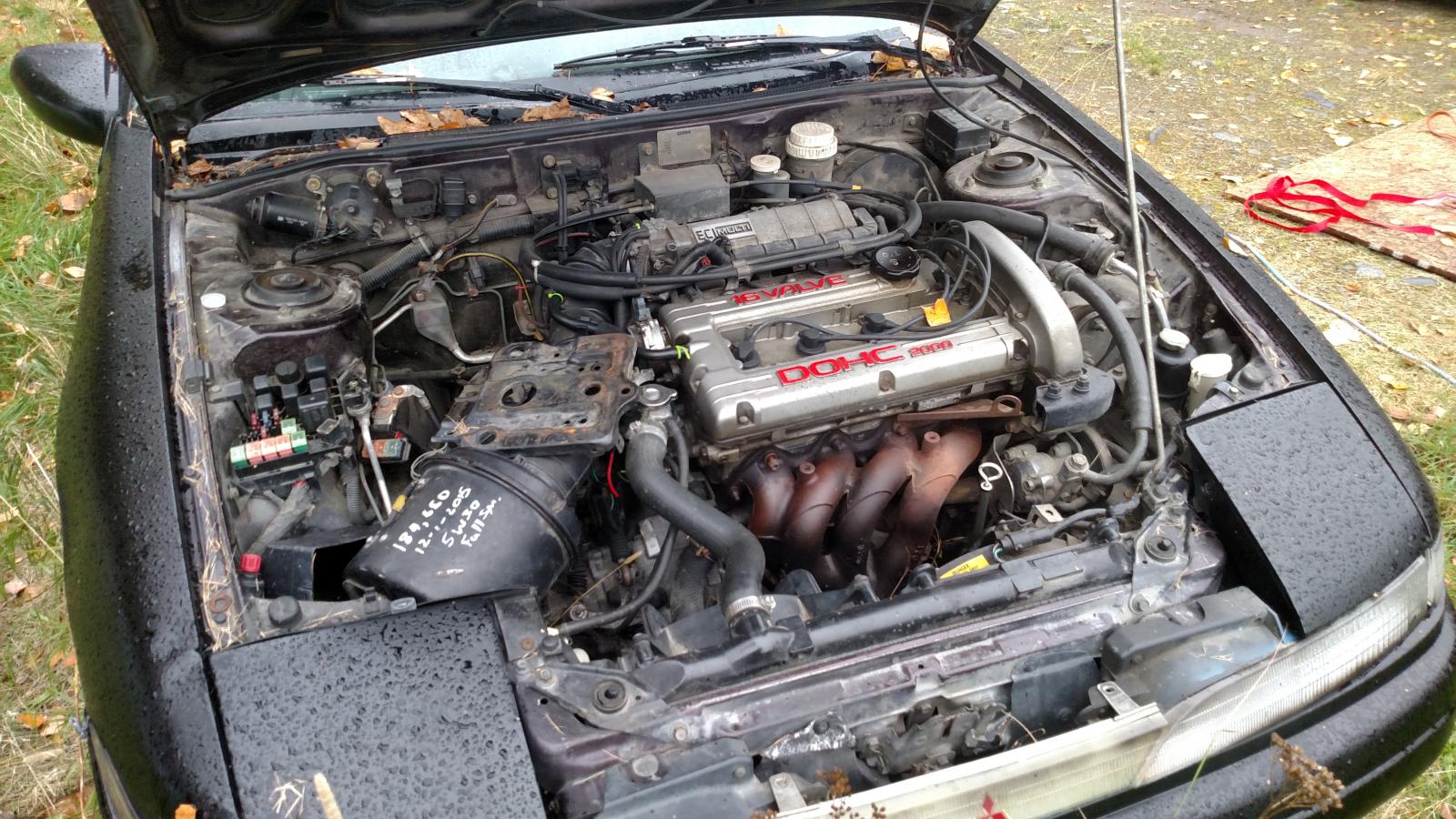

    Hmm so the challenge is really just finding a 2.6 at that point which would not be easy up here unfortunately, since i have been up here i have seen one starion on CL but it was in immaculate shape. I couldn't live with myself knowing i ruined a perfect starion for my truck ha ha.
    Here is what I have leads on at the moment up here.
    1st gen Eagle Talon but its FWD, guy says he has everything I need to turbo it but he just never got around to it, 500 bucks. weren't all 1G talons DOHC? here is the ad for reference http://anchorage.craigslist.org/cto/5769417393.html

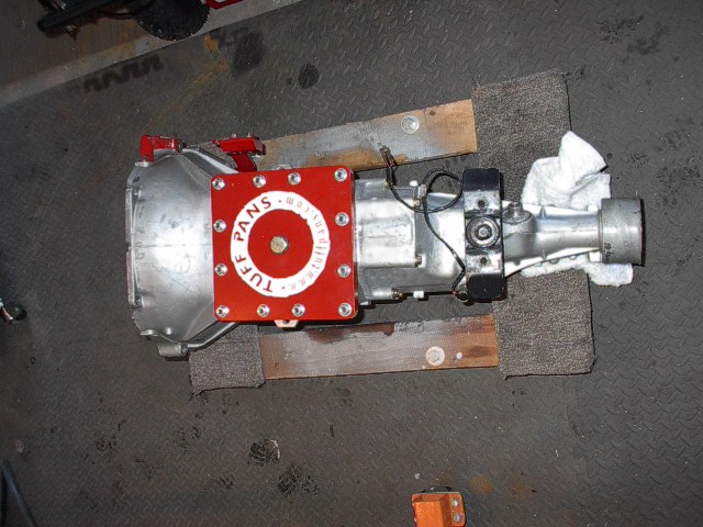

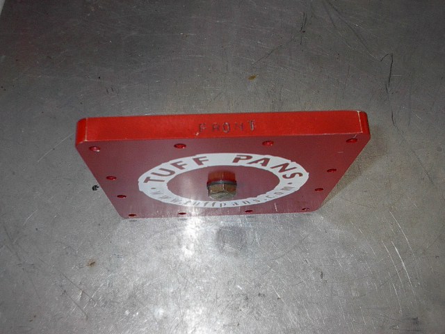

    the Tuffpan is a billet pan that is 1/2 " thick and installs with studs - not really a deep sump pan.

    http://www.tuffpans.com/
    says 3/4" or 19mm aluminum not steel
  10. #35
    04-04-2011
    712
    Columbus, OH
    1992 Mitsubishi Mighty Max
    Tuff Pan. served me well. I was grabbing 5th under boost well over 450HP.

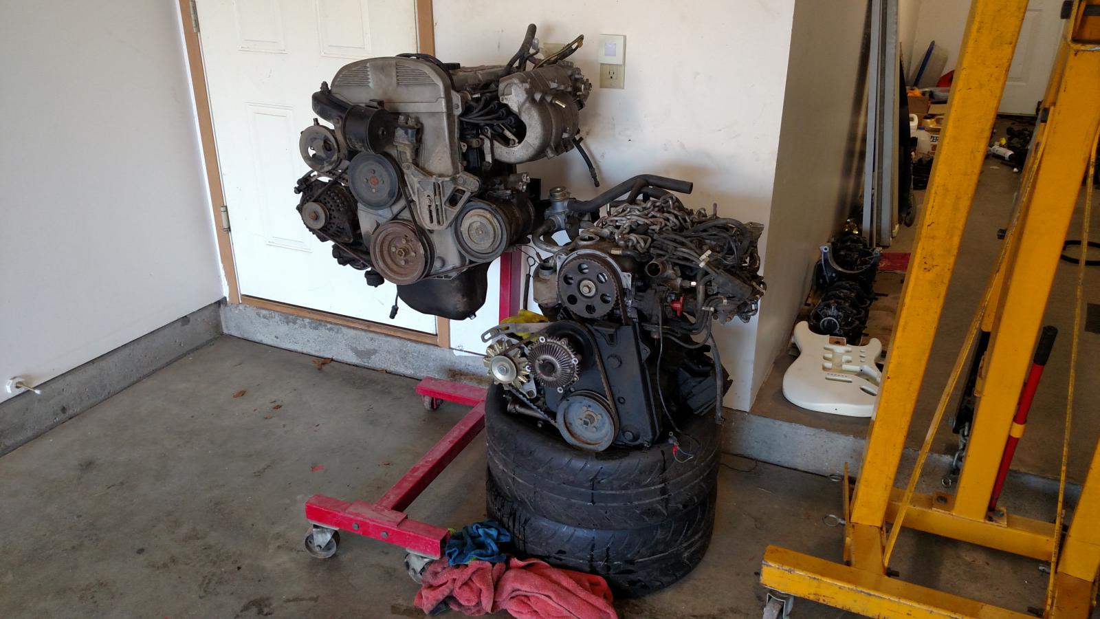

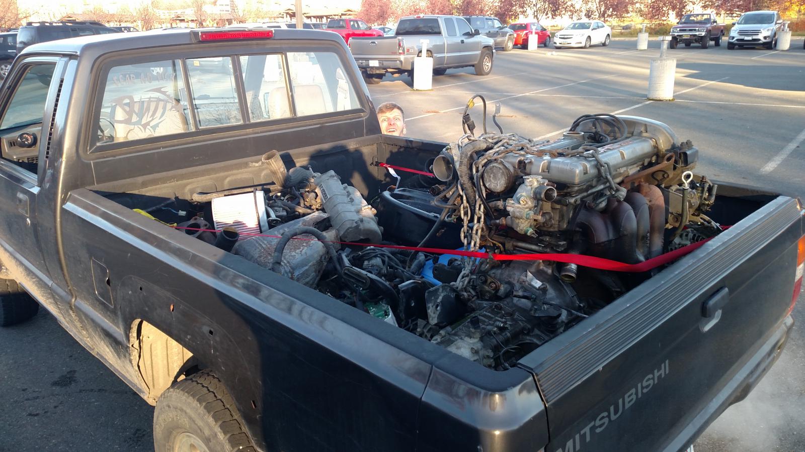

    Engine has been acquired...
    And he wasn't lying, it came with everything I need to convert it over to a turbo accept pistons. Debating about running the factory compression and less boost. hmmm decisions. But i do have, both the manifolds, engine harness, ecu, turbo, throttle body, maf, boost controller, etc. should be fun.

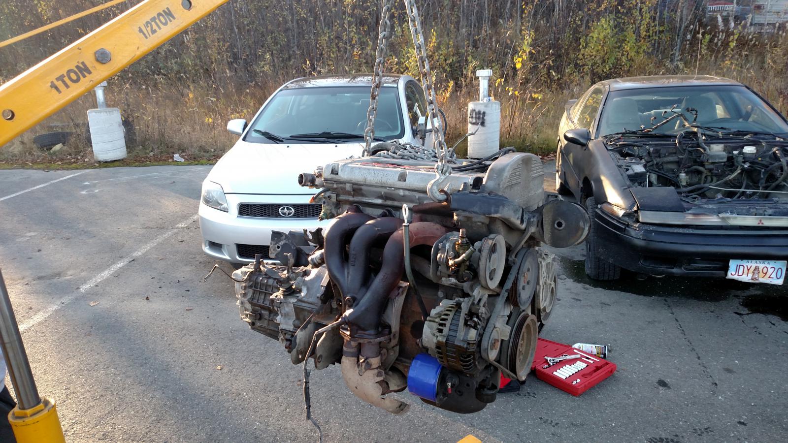

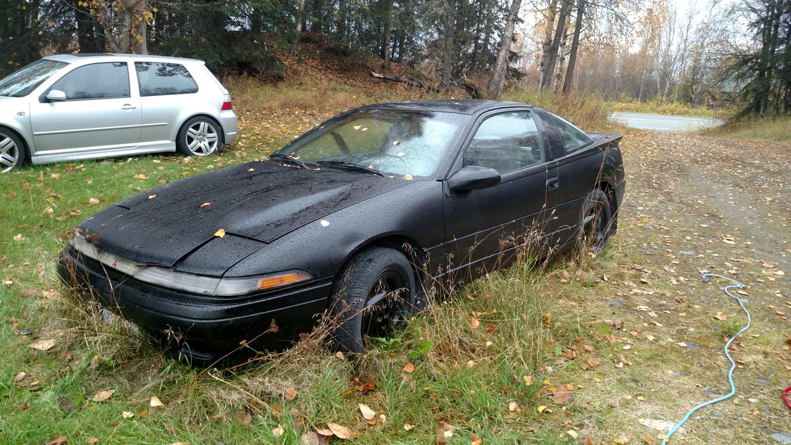

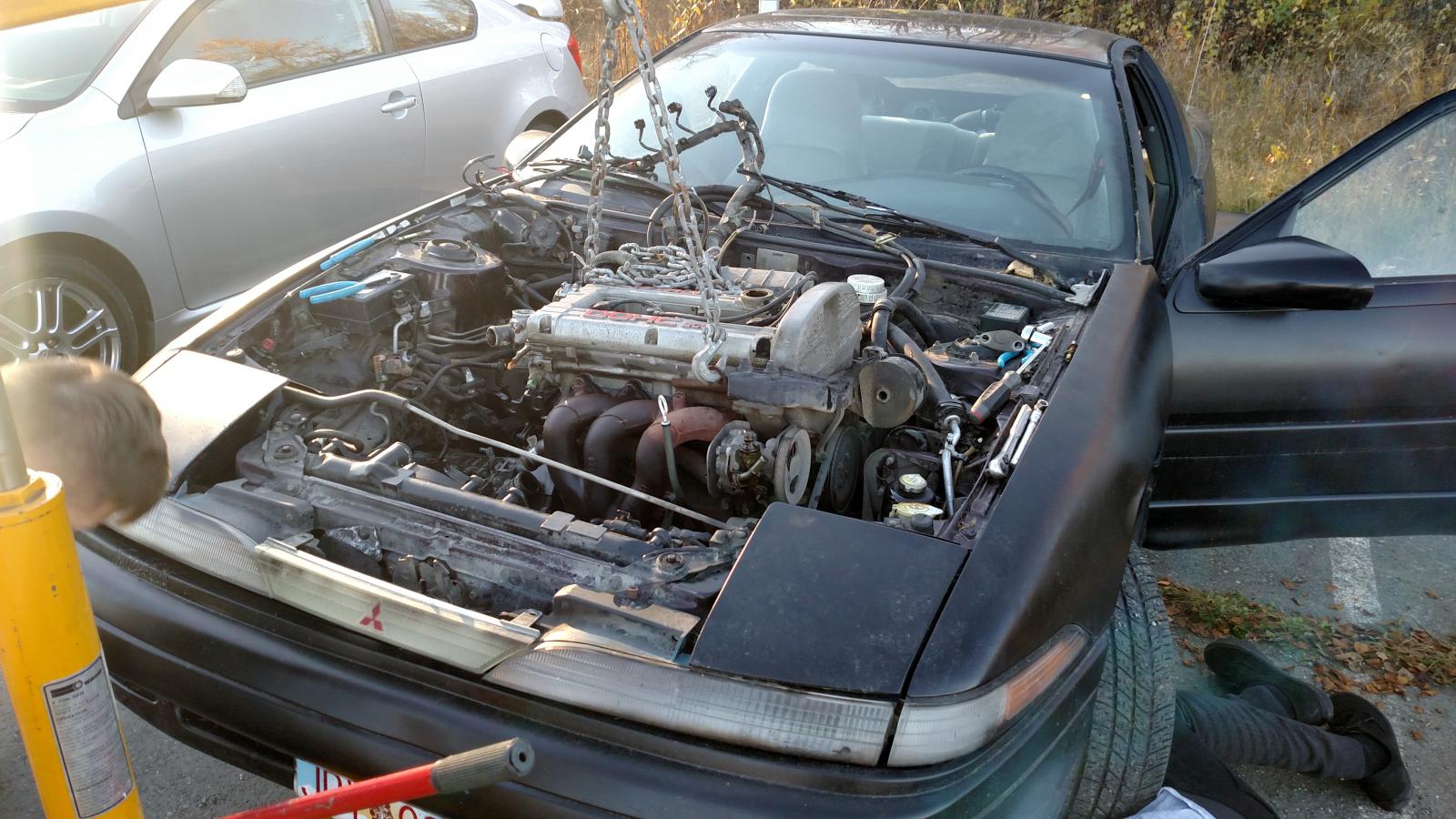

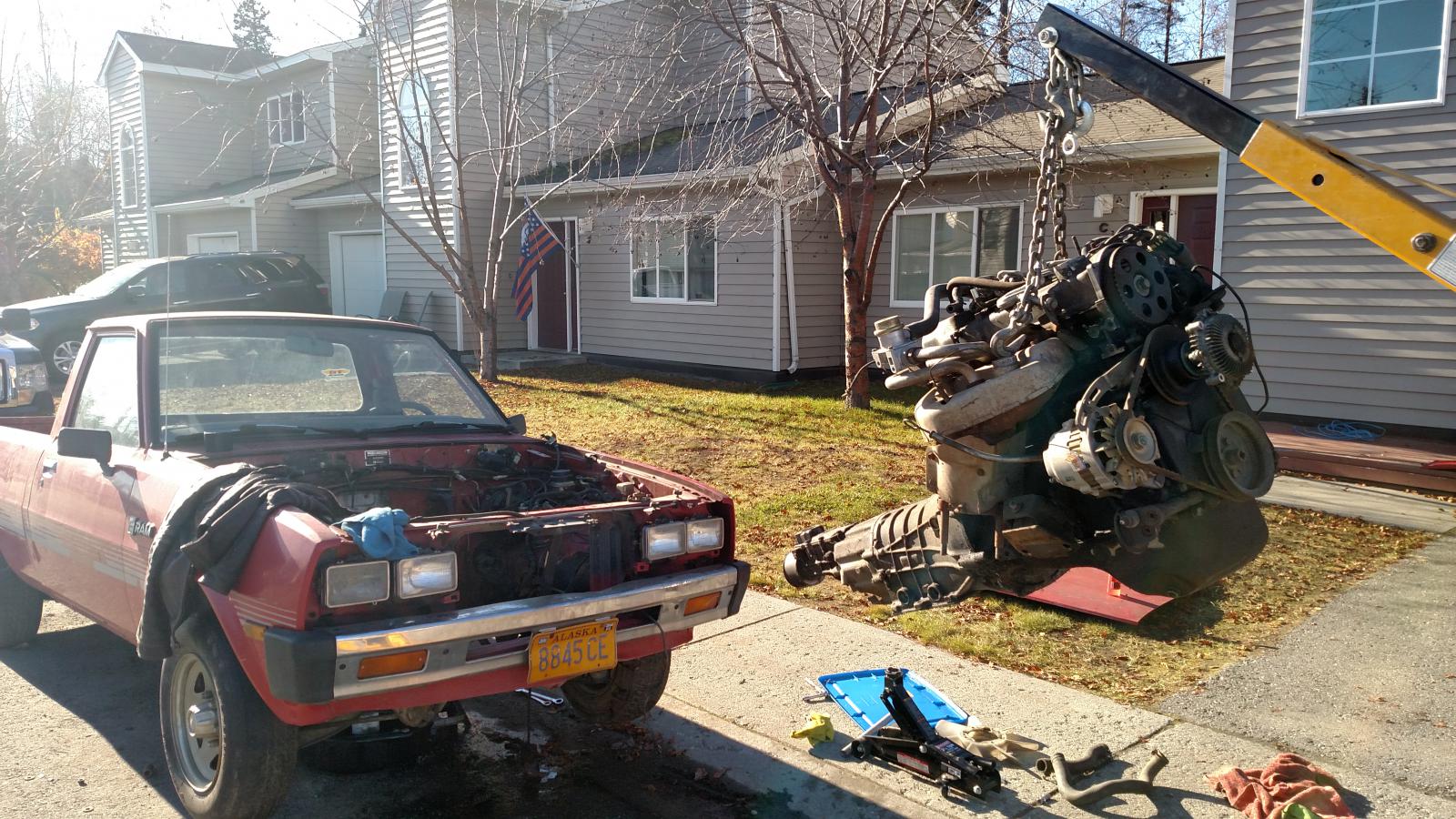

    1986 Dodge D-50

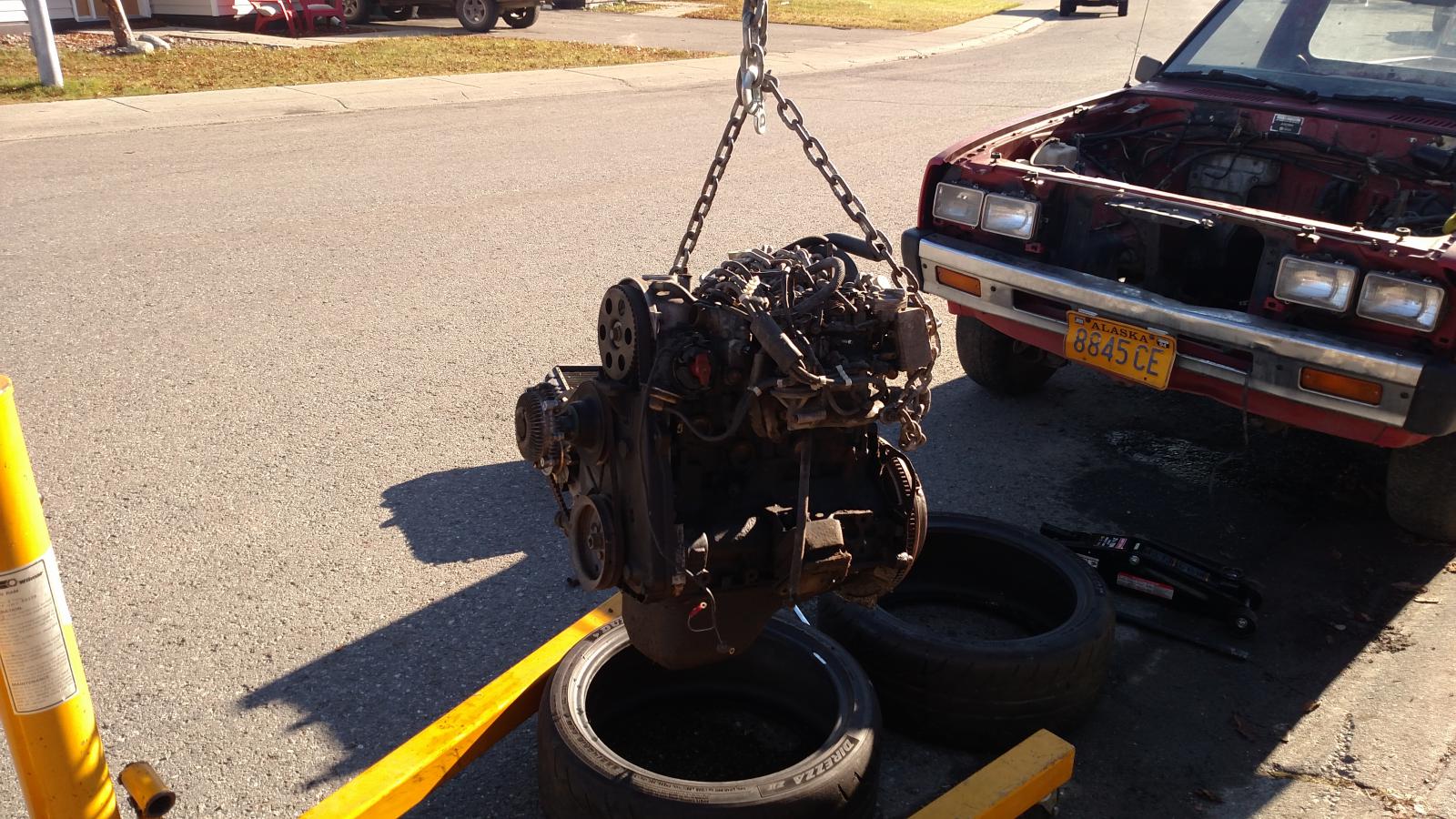

    Progress update:
    Pulling engine #1...
    Pulling engine #2...
    Ready for dismantling...
    But i have a question about brakes. I know on the second gen MM, you can take the 2 piston calipers from a late 90's montero for a easy upgrade. but whats compatible with the first gen MM. Also, can I use the master cylinder from the talon on the first gen MM?
