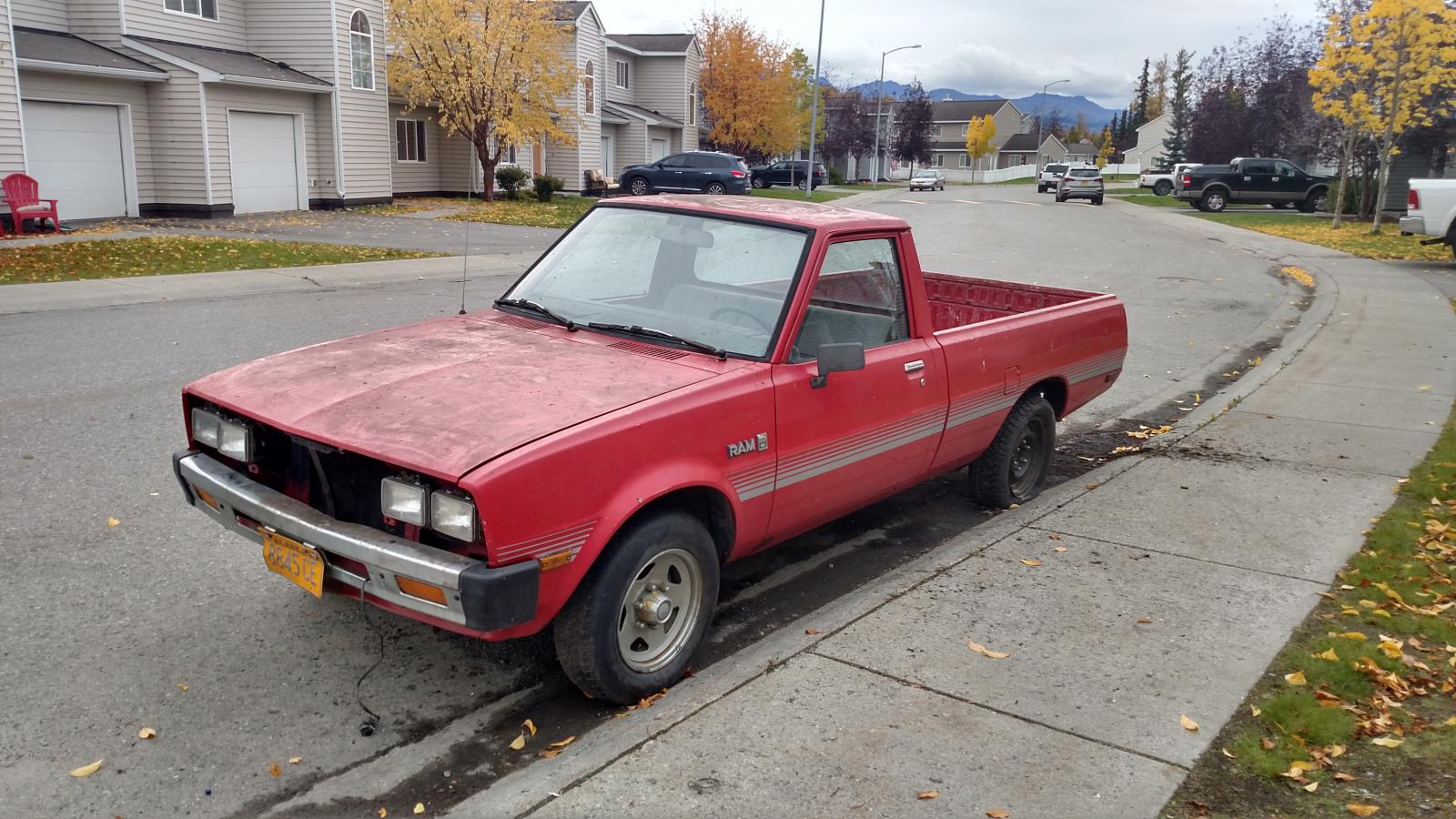

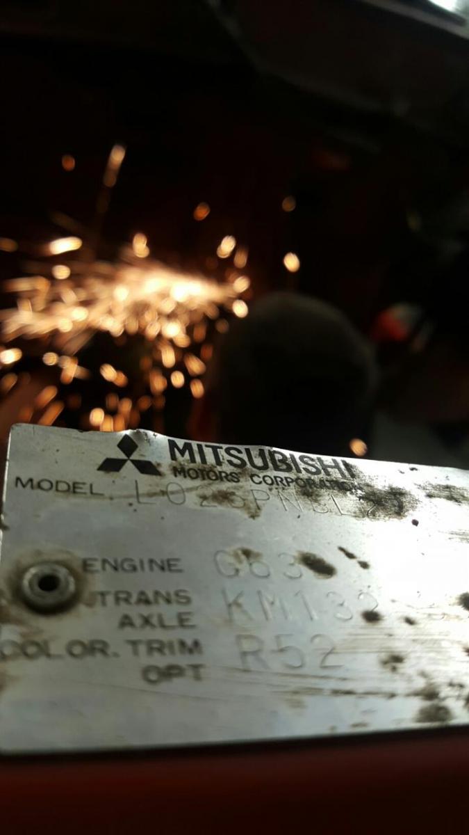

    who wants to build a race truck?
    Been wanting to build something cool and unusual and have always had a fancy for mini trucks built for racing like the Datsun Sunny they had on Jay Leno's Garage. So i went up to Fairbanks and picked this up for 200 bucks. Debating about putting a Weber on the factory G63b or swapping something in like a turbo v6 or replacing the head with a DOHC, I'd like to hit around 200hp. But thought I would start a build thread for conversation's sake so here she is! 1986 Dodge Ram 50, Last receipt i found in the glove box was from 1996 so I'm assuming she has been sitting for around 20 years or so.
    IMG_20160919_111408988.jpgIMG_20160919_111418602.jpgIMG_20160919_111430598.jpgIMG_20160919_111459808_HDR.jpgIMG_20160919_111510348.jpgIMG_20160919_111528084.jpgIMG_20160919_111617121.jpgIMG_20160919_111625954.jpg

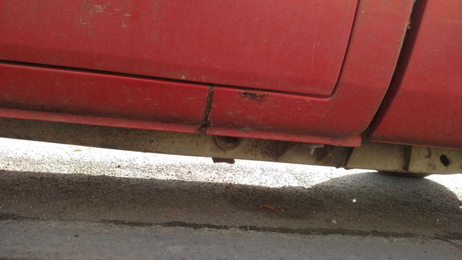

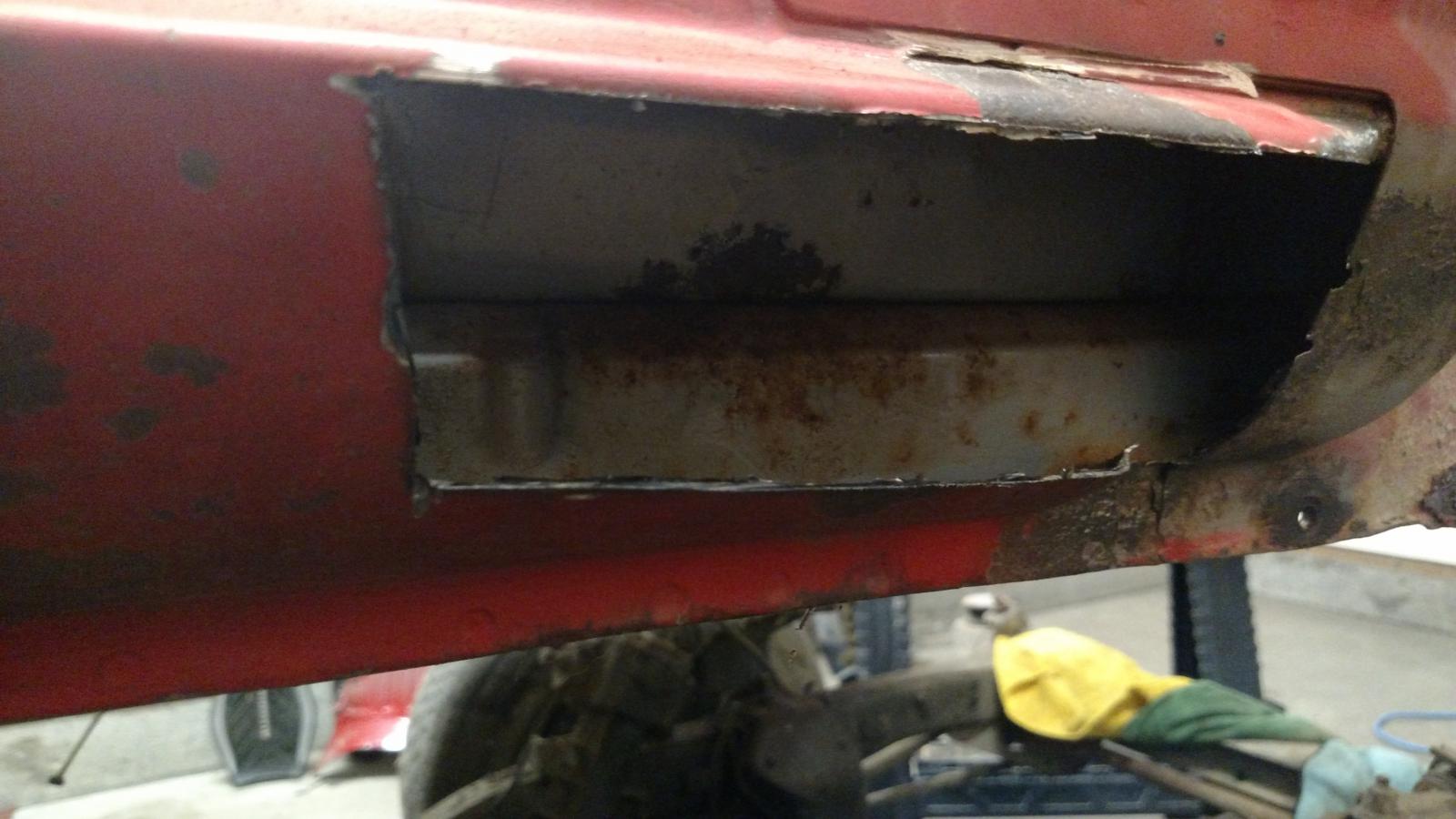

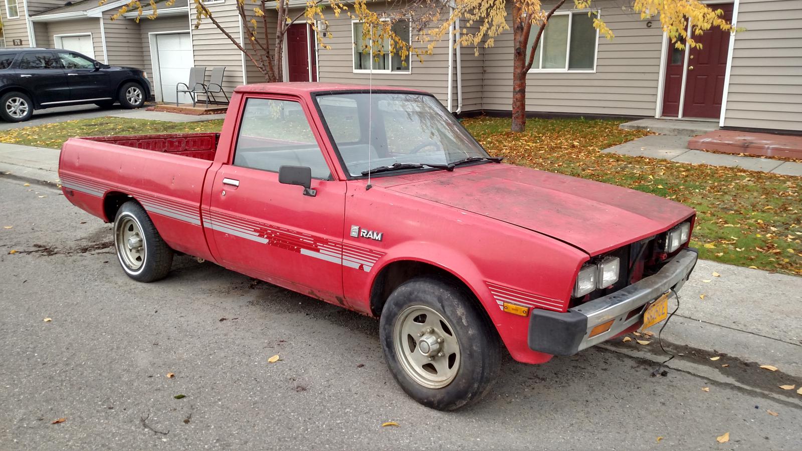

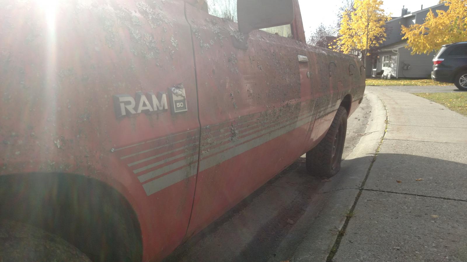

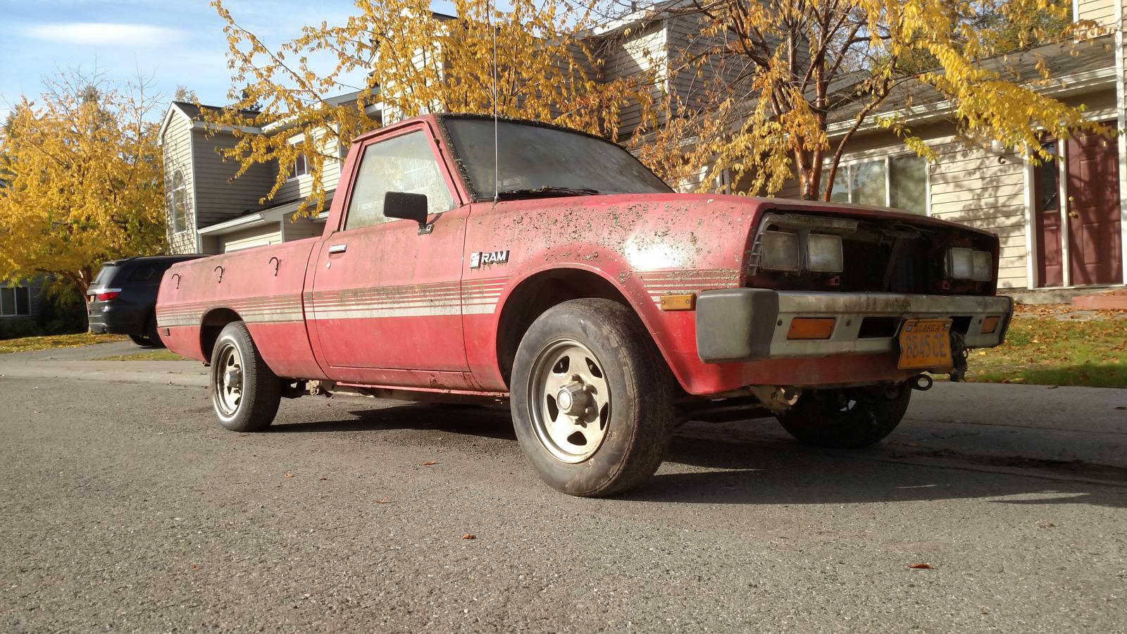

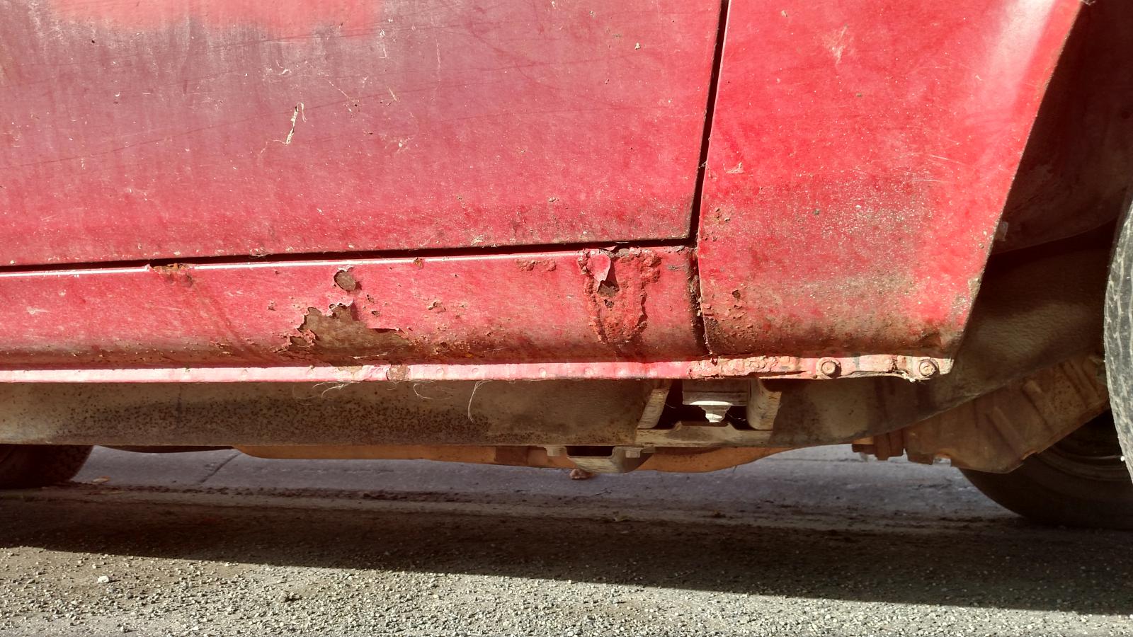

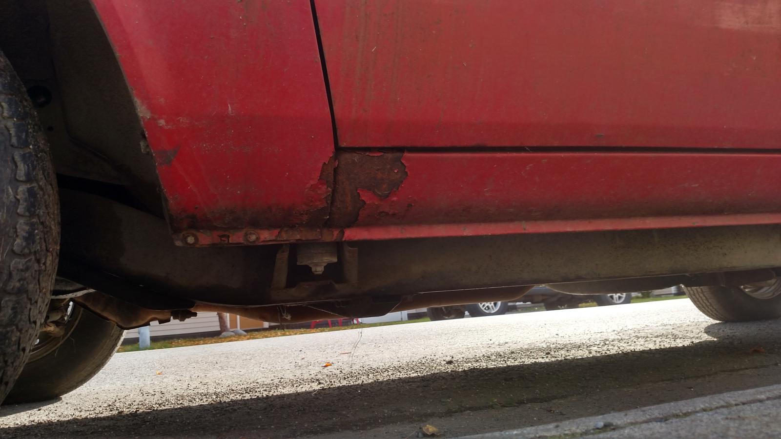

    Has some rust but i think ill be able to fix it before it gets any worse
    IMG_20160919_111638821_HDR.jpgIMG_20160919_111649986_HDR.jpgIMG_20160919_111700226.jpg

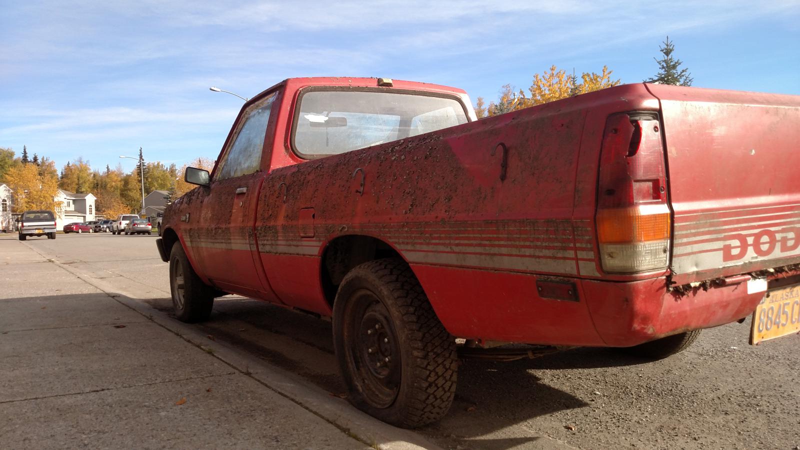

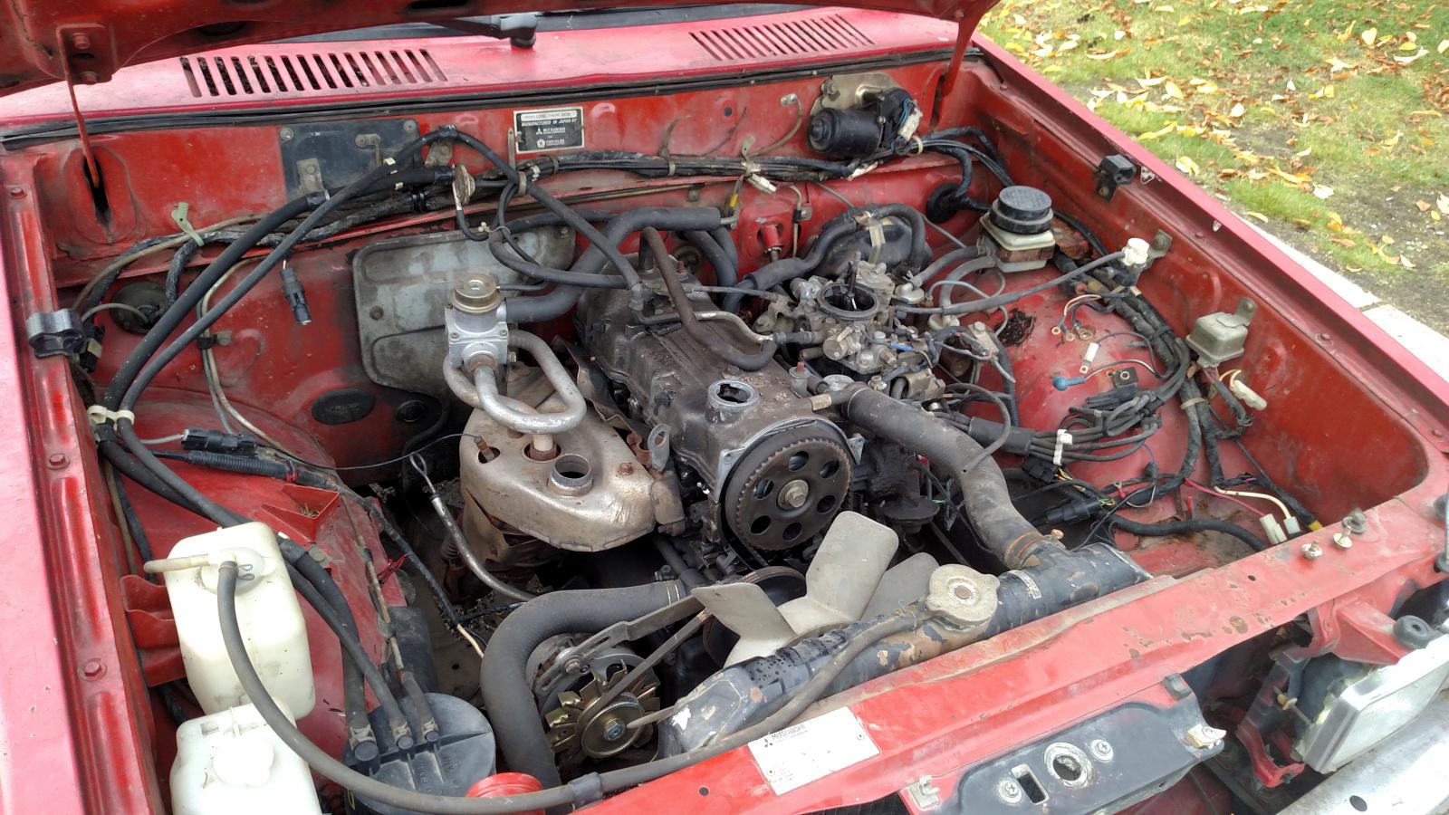

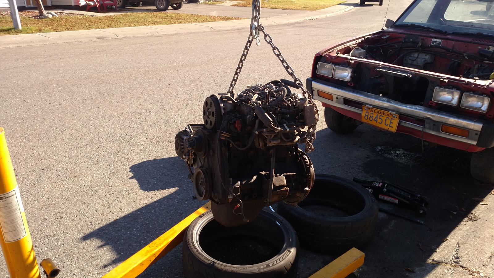

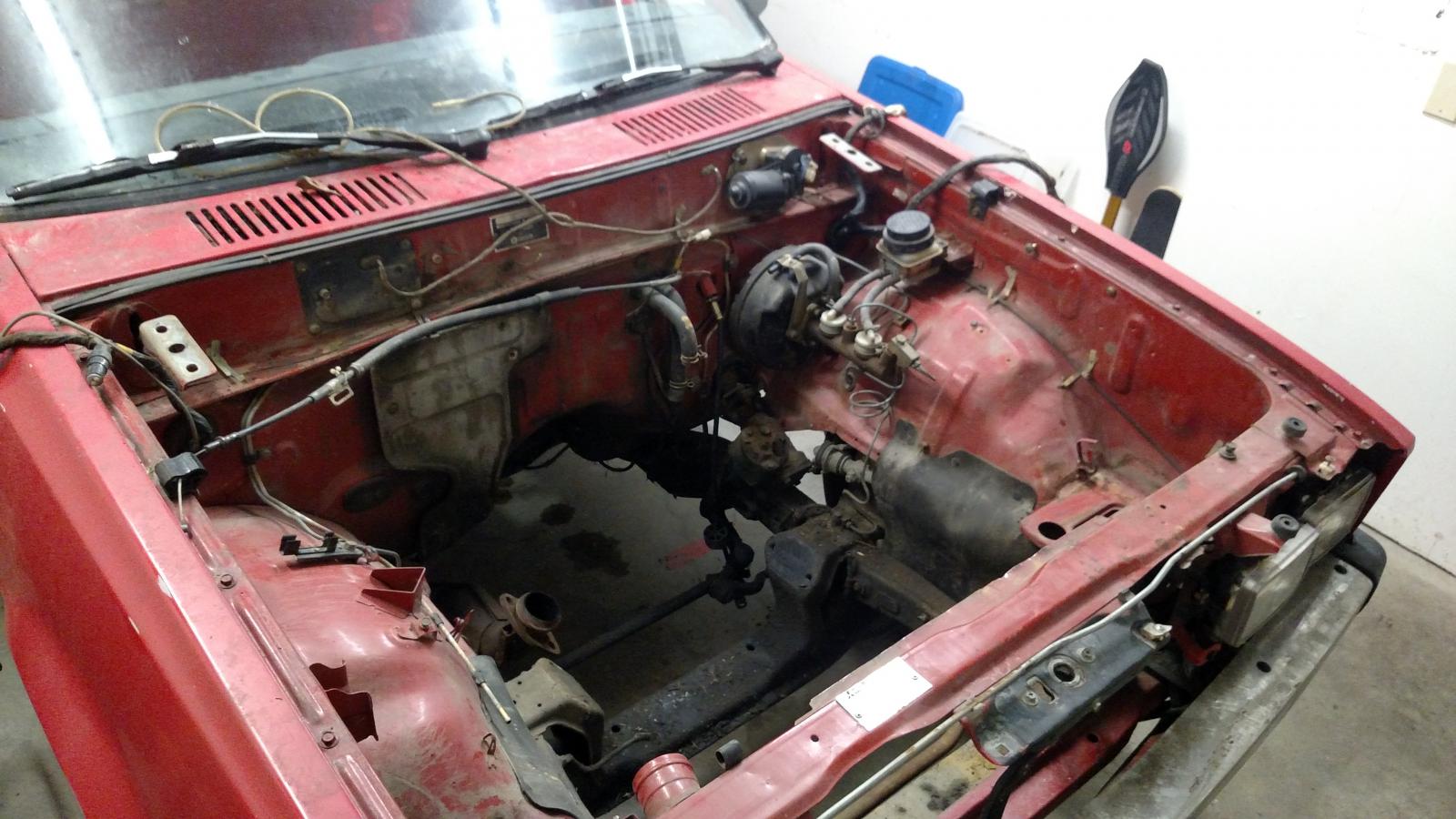

    Engine turns over (manually) belts look good which is surprising its missing some things like plug wires, igniter, oil cap, simple stuff. The oil looks like its reverting back into dinosaur poop though ha ha.

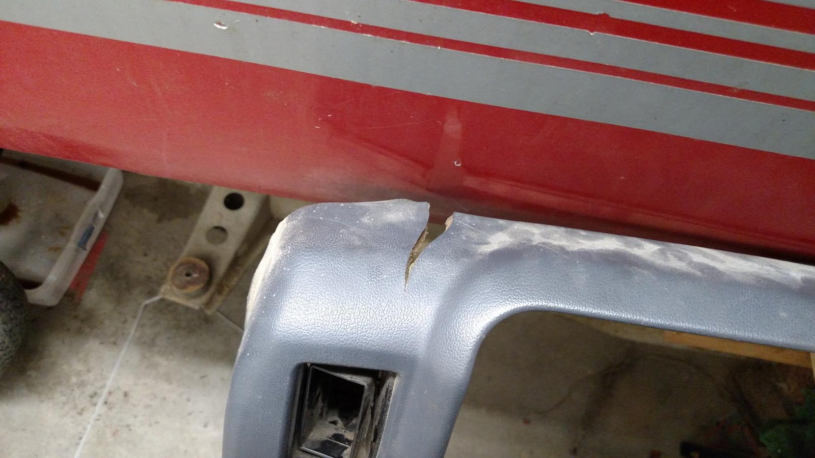

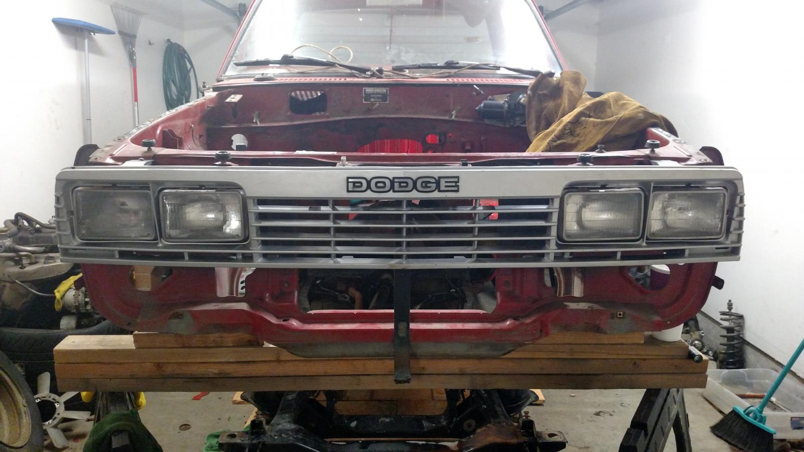

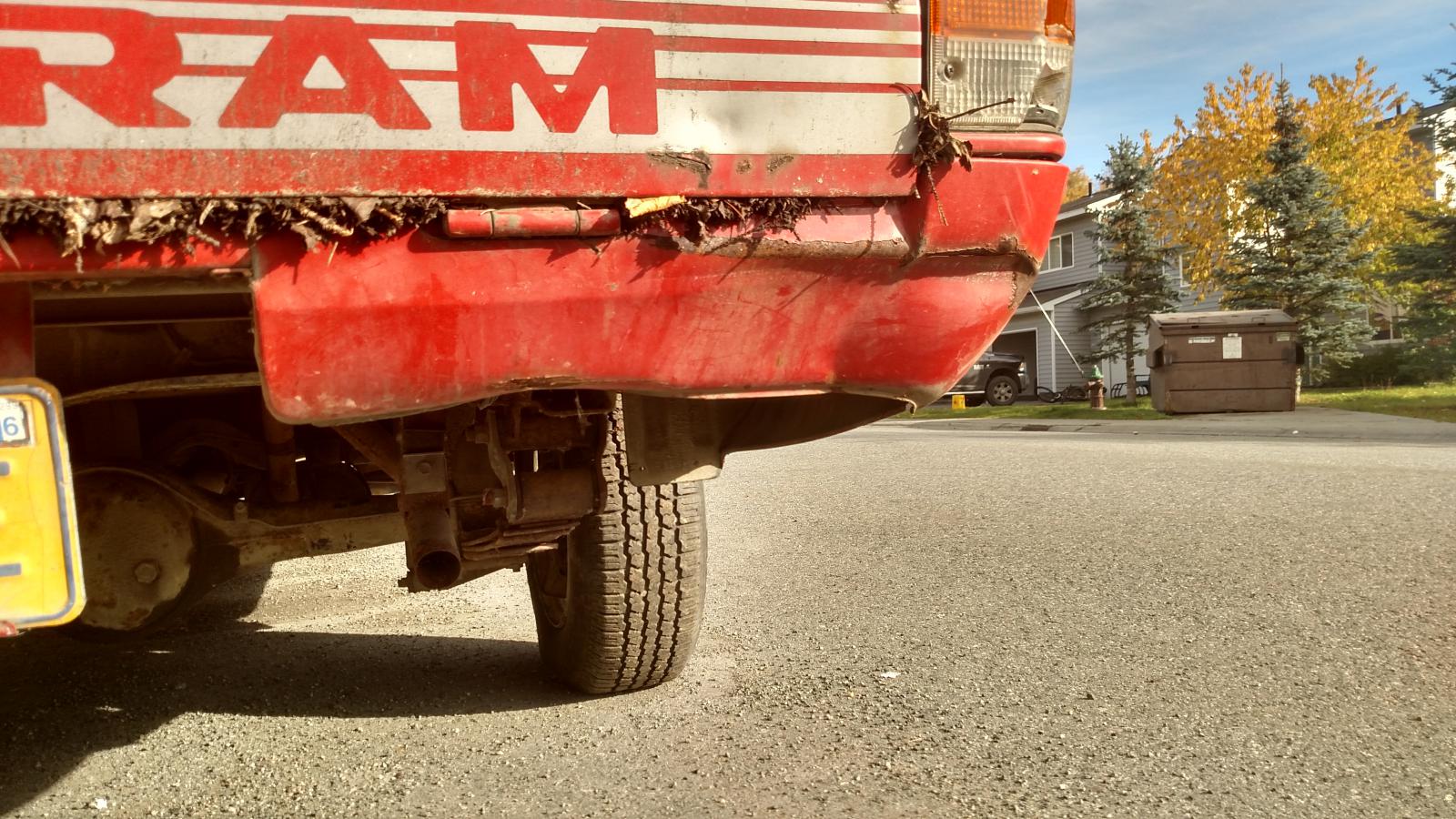

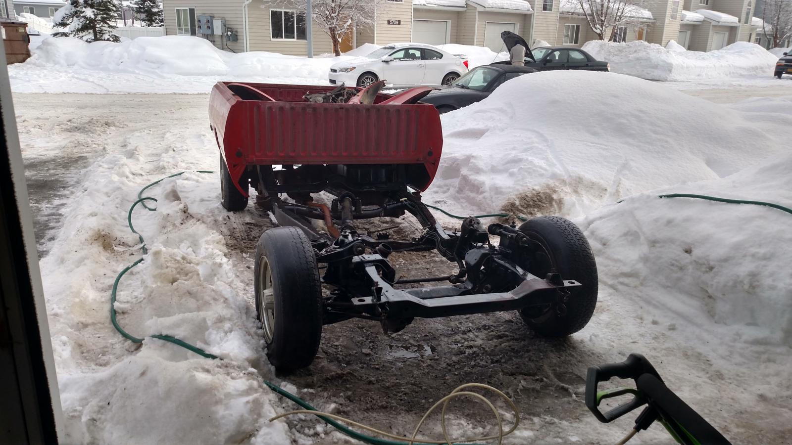

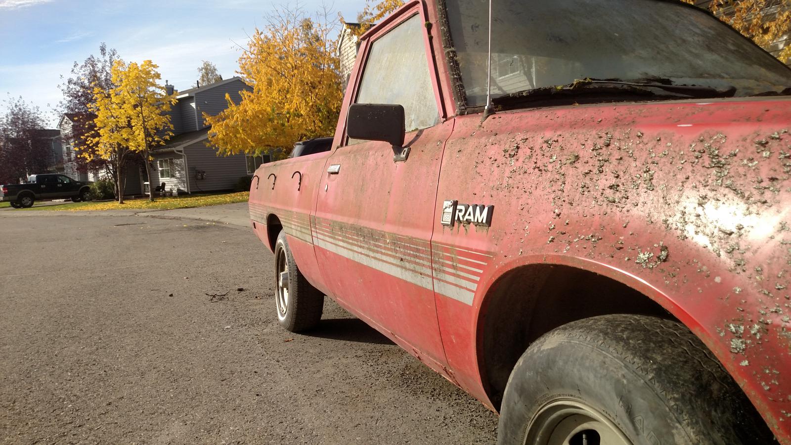

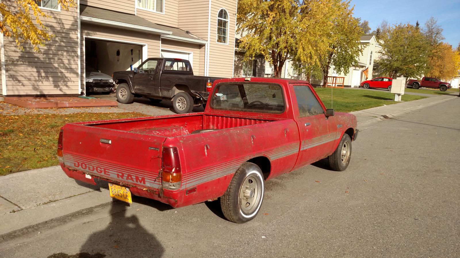

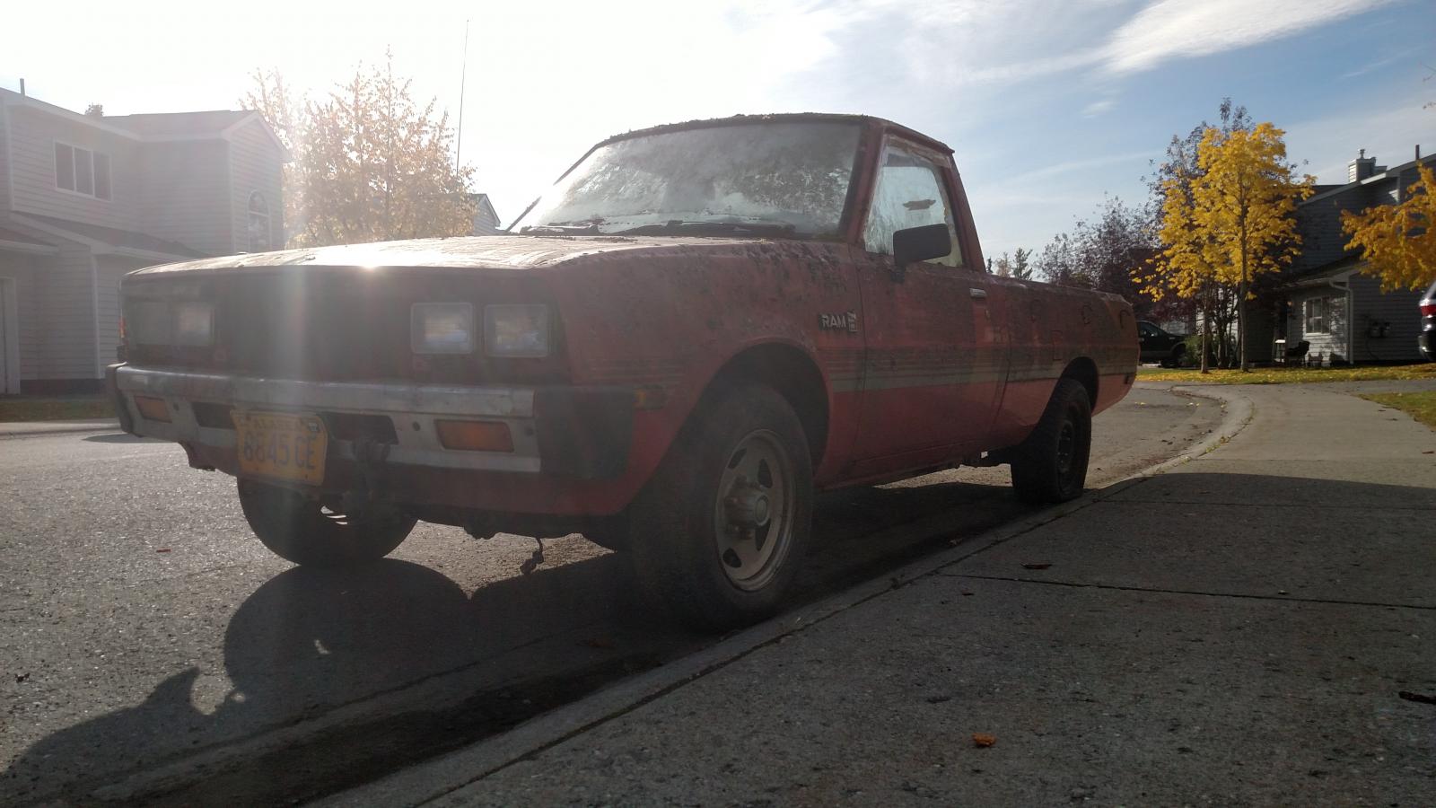

    After I pressure washed some of the crap off of it. Unfortunately some of the pin striping came off with the dirt :/ but aw well I'm gonna have to wash and wax and I already found a paint scheme i want anyway...
    IMG_20160920_111019128_HDR.jpgIMG_20160920_111028005_HDR.jpgIMG_20160920_111040519_HDR.jpg

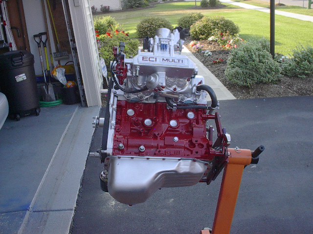

    If you're planning on using the 4G63/G63B engine and going turbo look up LSRMike's truck build (this is one industrial strength truck). These engines can be swapped to injection without too much head scratching. The 4G63T twin cam engines are injected standard and the heads/manifolds are different to the single cam engine. There are a heap of sources for a 2 litre twin cam engine - they can be found in Mitsubishis and Hyundais. Do a search here and you'll find plenty of info on which engine types and how to do it, and check out the build threads as well. There are some really outstanding projects that have unique modifications to fire your imagination

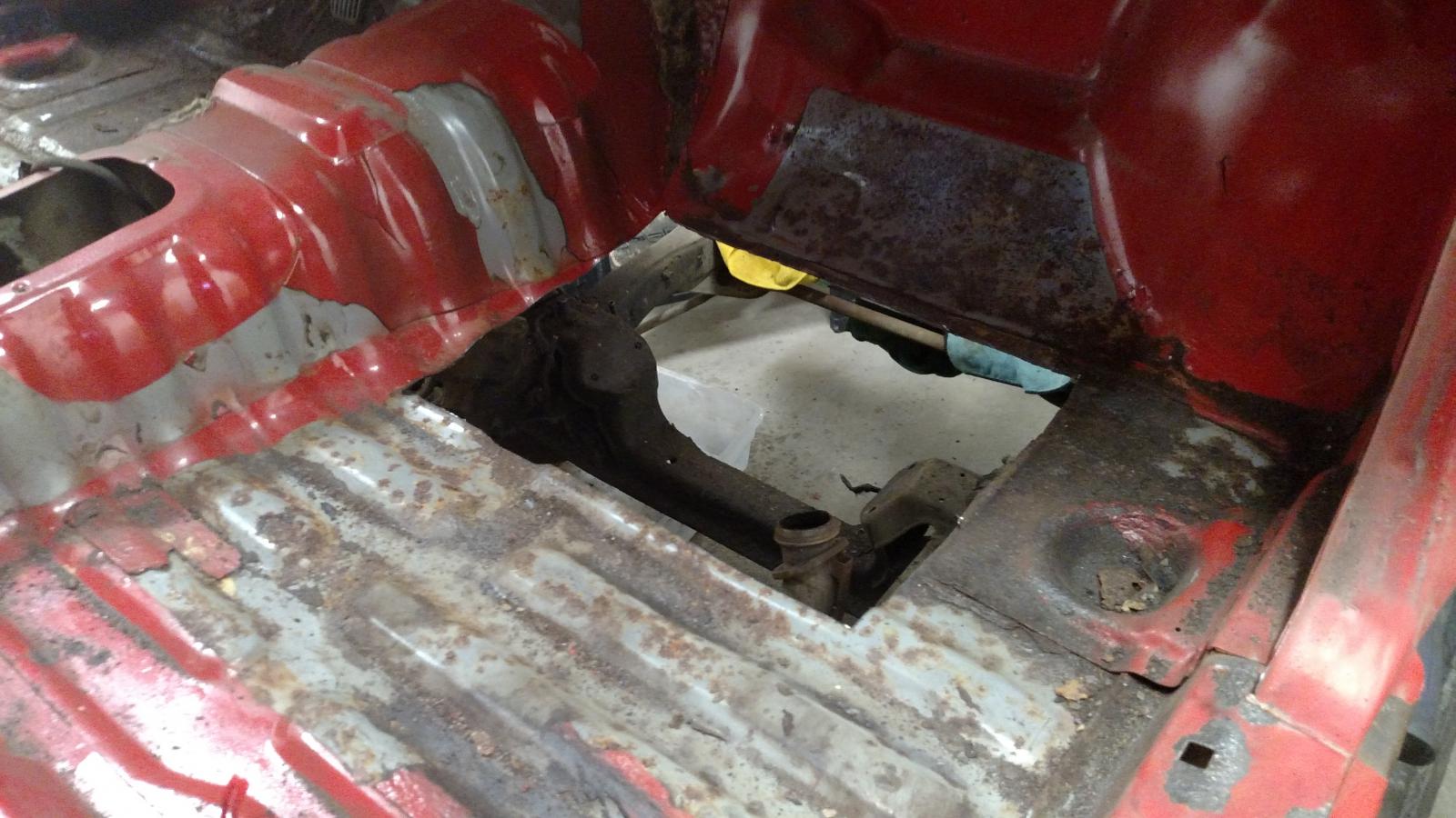

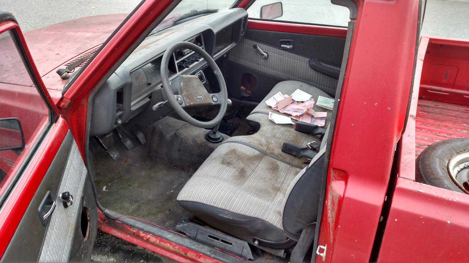

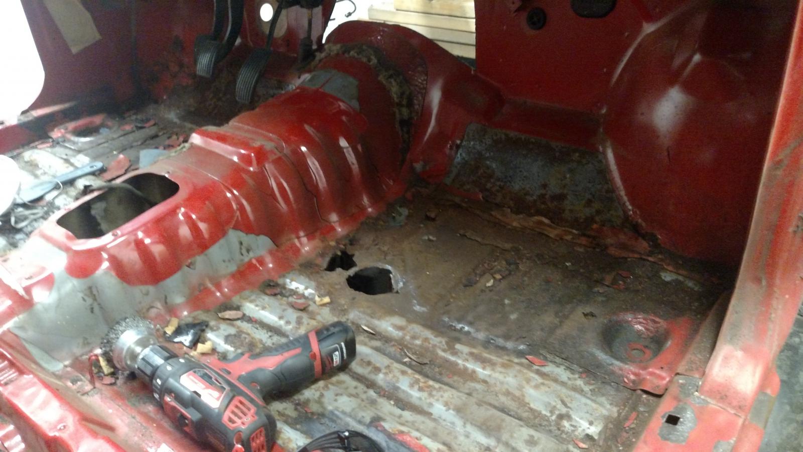

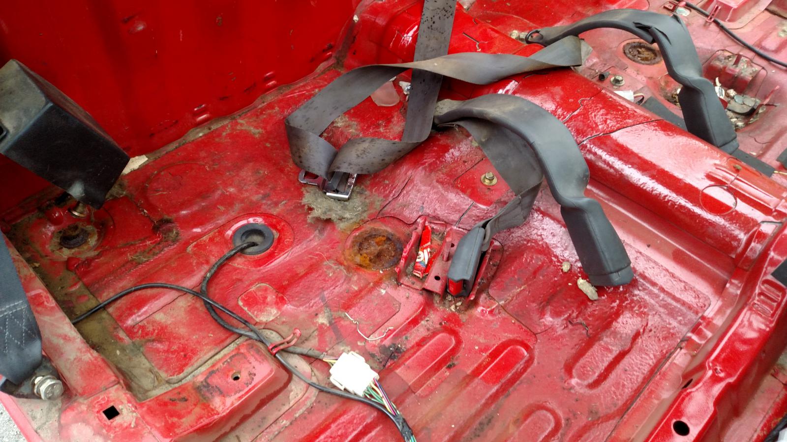

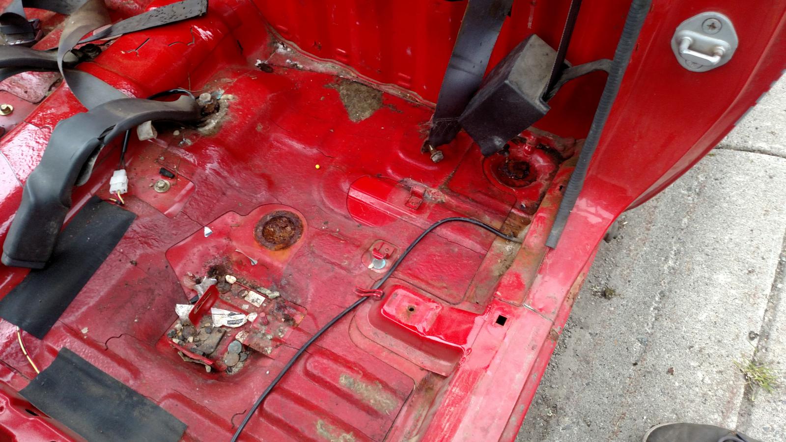

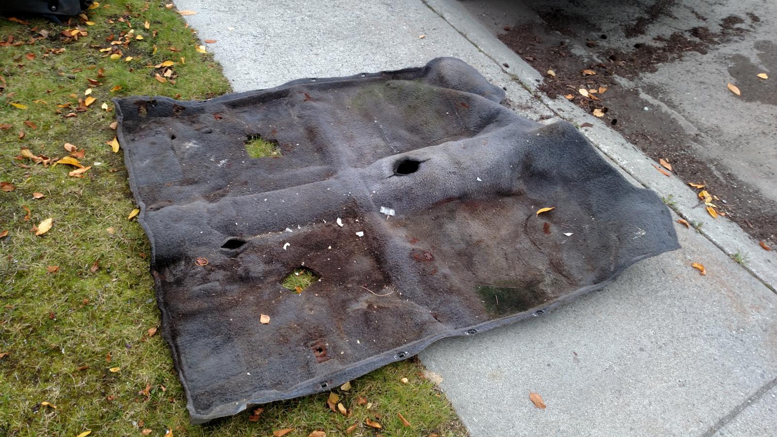

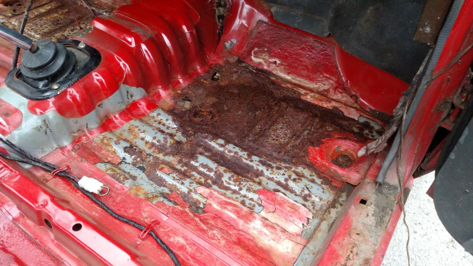

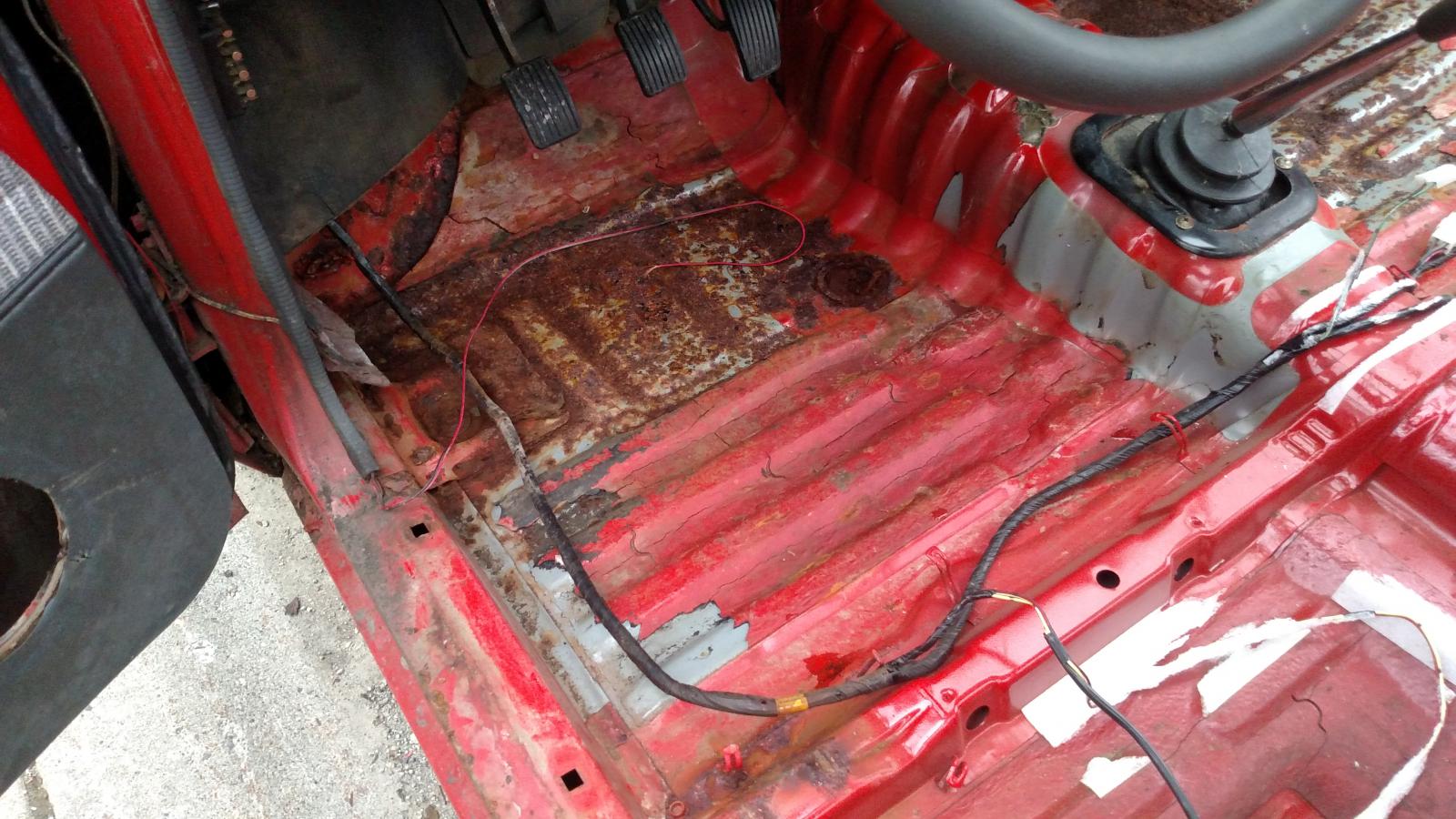

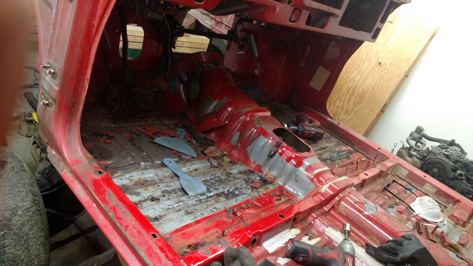

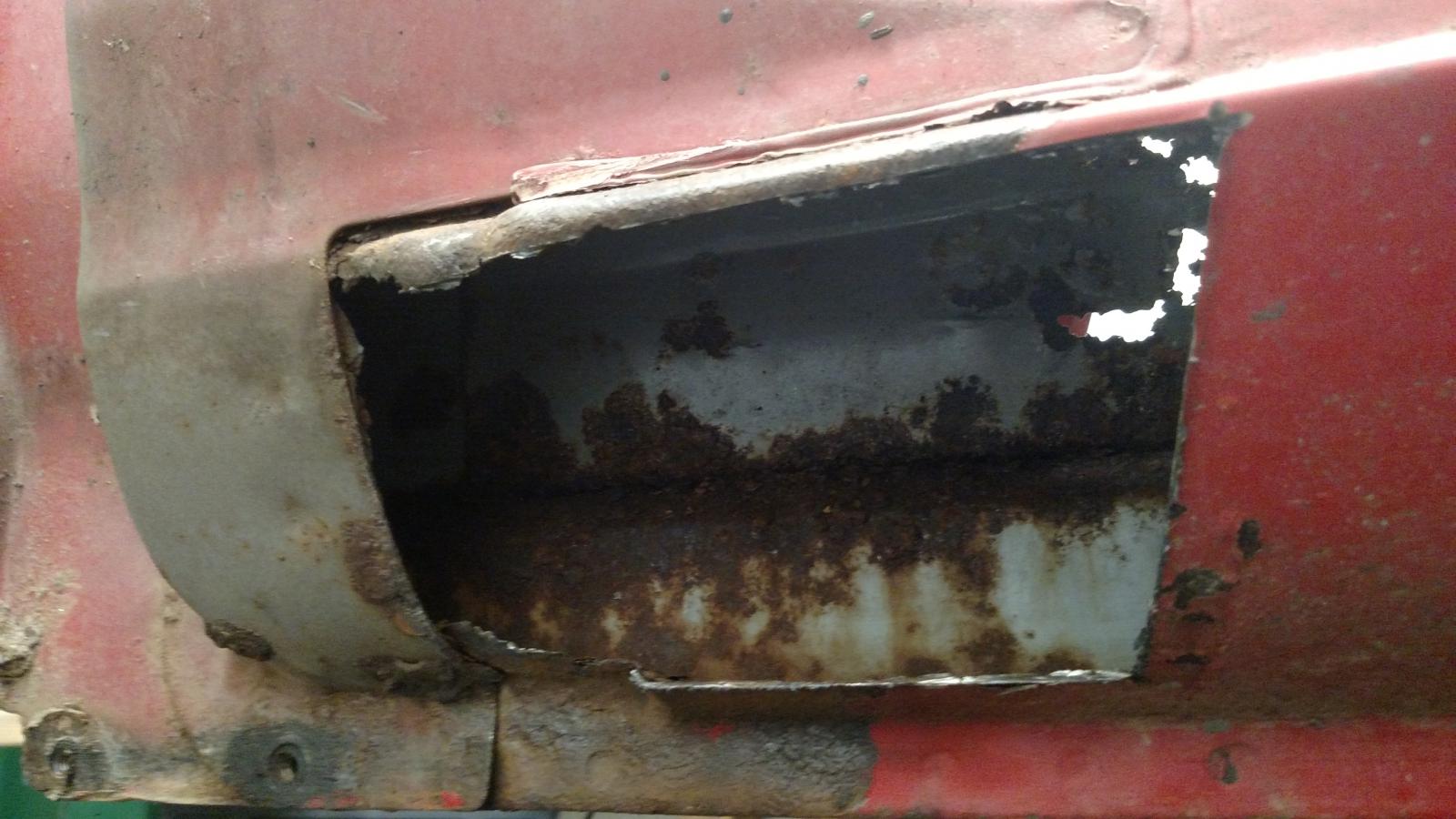

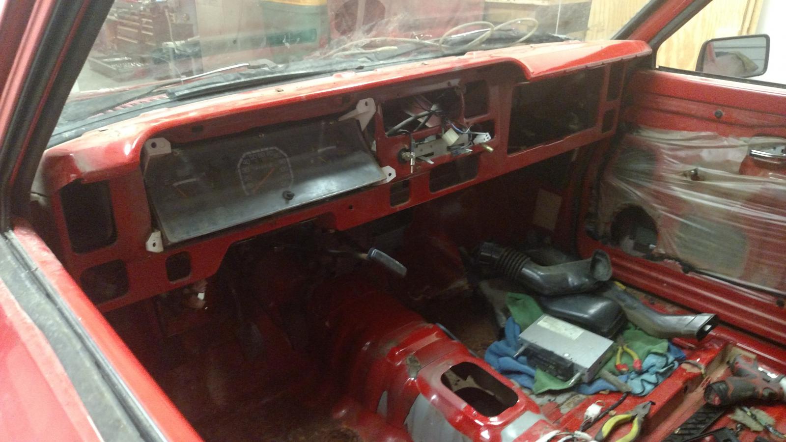

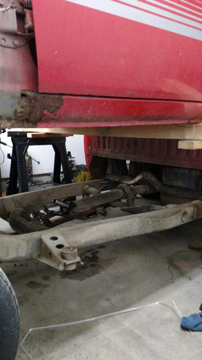

    Honestly i expected there to be more rust under the carpet! pleasant surprise!

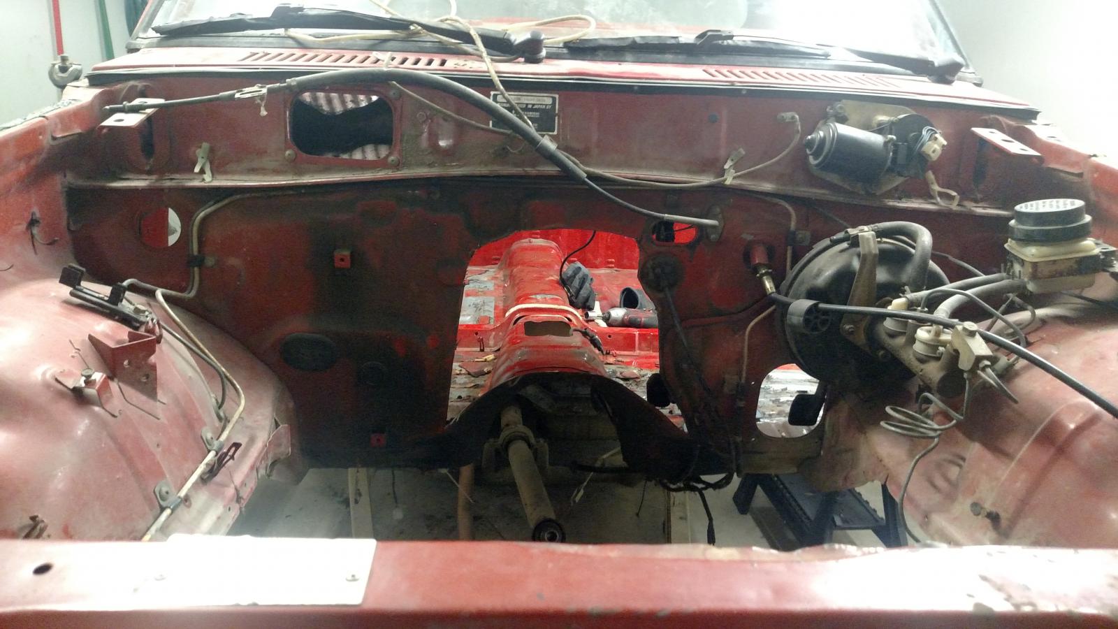

    IMG_20160921_173716745.jpgIMG_20160921_173730093.jpgIMG_20160921_180758372.jpgIMG_20160921_180813425.jpg
    Nasty
    Skittles bag from 96! ha ha

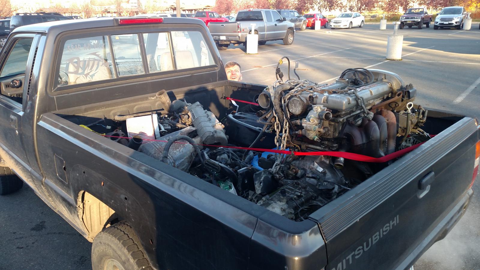

    So I have done some fine tuning to my plan of what i want to do here.
    1st I would like the truck to have around 200 to 250 hp
    2nd I still want decent MPG as i would like to take road trips with the truck
    3rd i would prefer to keep the tranny (KM132) I already have in it.
    4th aside from minor body modifications I don't really want to do a hack em up and weld kinda job here looking for more of a drop in with tweaking kind of solution.
    5th I'm kinda limited to what I find on EBay and online stores with shipping to alaska (stuck up here for a while unfortunately) this kinda limits my ability to buy things from forums and such as most people parting stuff out are not willing (nor am i willing) to pay 500 bucks in shipping for a 500 dollar part.
    So knowing this from what i have read on the forums here I'm looking at a few options correct me if I'm wrong on any of these

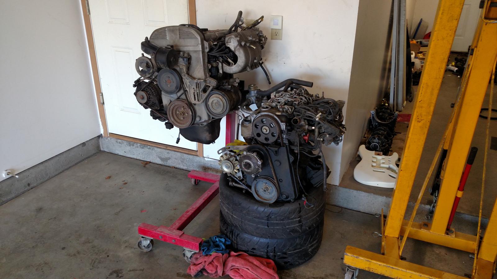

    1. Find a DOHC DSM head, accompanying turbo, exhaust manifold (could make something if need be), intake manifold, throttle body, ecm, wiring harness, pistons, etc. and use the block i currently have (6 bolt g63b with 91k on it). from what i can tell this might be a viable option as most of these parts i can find around the Internet and get them shipped to Alaska.
    2. Find a whole dsm 6 bolt engine with harness and ecu, which would be the ideal option however, I cannot seem to find one, there is one on ebay, and it seems like all of the JDM engine depots are fresh out. Would buy the one on ebay but i dont have the 1300 bucks at this very moment so it will probably be gone by the time i do. my point is finding the whole engine for the swap seems to be kind of a rare thing.
    3. Find a g54b 6 bolt from a conquest or starion, now this seems like a good option but i am also unable to find any used engines with most of the stuff with them I can only find blocks and such that are built for performance but its gonna be a while until i have 2500 to 5k to drop on just the block ha ha.
    4. I have read about putting a DOHC 4g64 head on the 4g63 block which the 4g64 seems to be a little more common of a engine and i could find those heads easier but then we go back to option 1 with buying all the parts.
    So if any of you guys have opinions on these plans or have a better place to acquire parts please let me know even if its just to tell me i'm a idiot and just typed a bunch of gibberish for 10 minutes.
    #1. simplest option - Conquest/Starion 2.6 + hardware. Already configured for RWD and will bolt in.
    #2. DSM 6 bolt turbo complete with harness and hardware. Needs to be modified for RWD but a ton of resource info and parts available.
    *remember these twin cam engines are also found in Hyundais and Kias minus turbo stuff but it opens up options.
    I might have this wrong but there aren't any 4G64 twin cam heads, only 16 valve optioned heads VS 8 valve.
    #3. 4G63 single cam turbo. Will be hard to find but a no brainer to build.
    Your weak point will be the transmission, But if you keep the power figures at a more conservative level (under 300 hp) it will last depending on how you drive it. Make a stonking thick steel plate for a transmission sump to reduce case flex.
