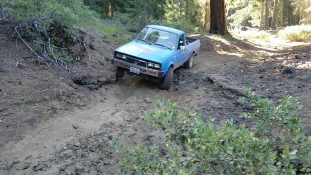

    Here are some pictures of the truck during the Gambler 500. If you go to Instagram and look up FATMANWA, I have a couple videos there.
    Screenshot_20170811-170820.jpgScreenshot_20170811-170933.jpgScreenshot_20170811-171010.jpgScreenshot_20170811-171043.jpg20170715_131148.jpg20170715_191459.jpg20170716_093028.jpg
