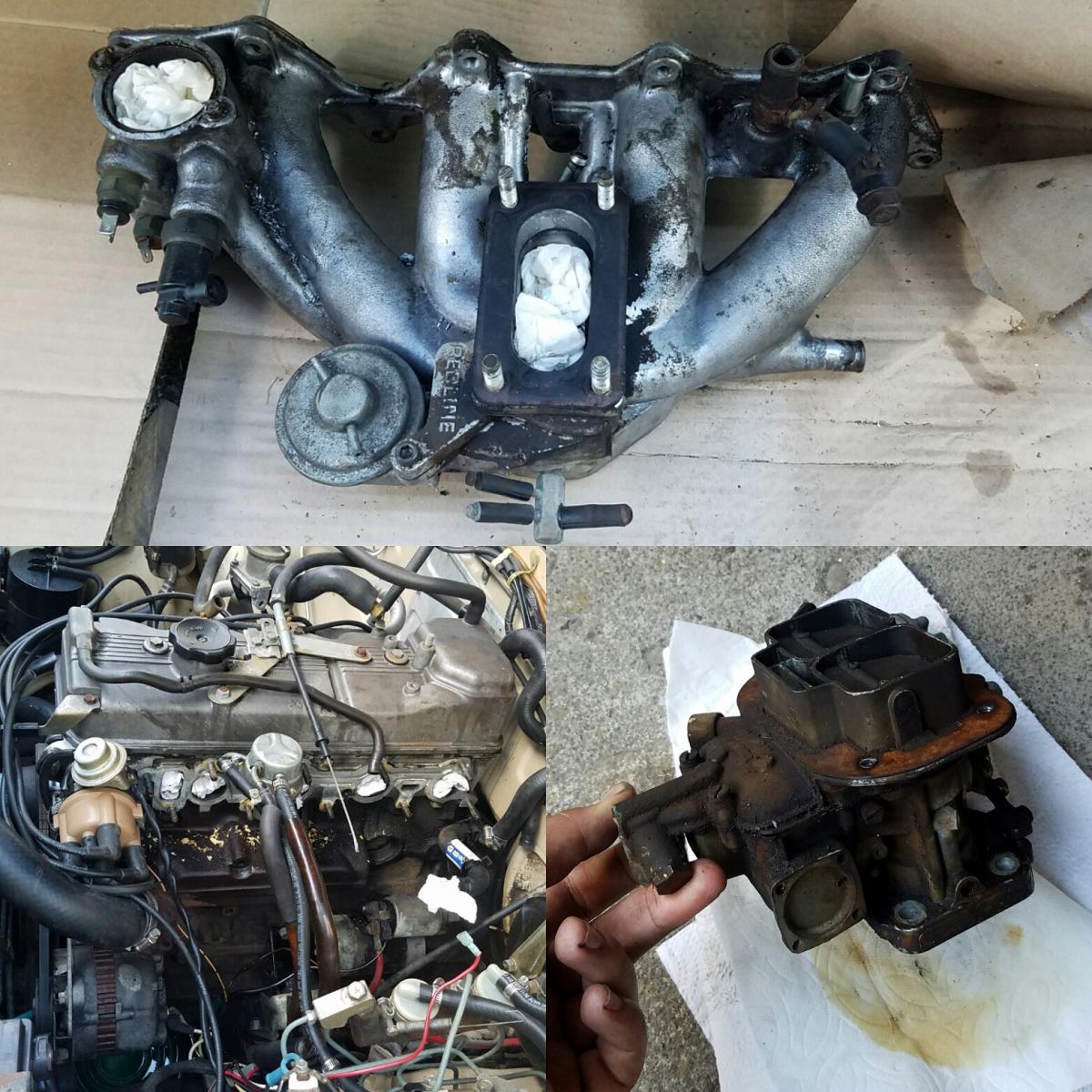

    Thought I would add some pictures of the work I have done.

    The pictures show the truck when I bought it and at its new home. Then after I took it apart showing the broken easy out on the thermostat housing. also, that carb is pretty filthy. the inside looks pretty bad too. I sprayed it off with some throttle body cleaner, so its a little cleaner now. While at the junk yard I happen to find a new weber air filter. Good thing to since looking closely at mine I can nearly see right through it.
    Next I plan on adding some mechanical gauges, finding some clips for the air filter (using zip ties right now) and getting some tires. Also need to fix the vent system a bit. It mostly works, but it wont switch to defrost.
    Since I plan on using this for a race, I plan on getting a CB radio and some LED lights. Probably also have my friend/co-driver fab up some nice off-road style bumpers. The front is bent up after some sort of front end collision and the back one looks bent from to heavy of a load.
    More pictures to come.
