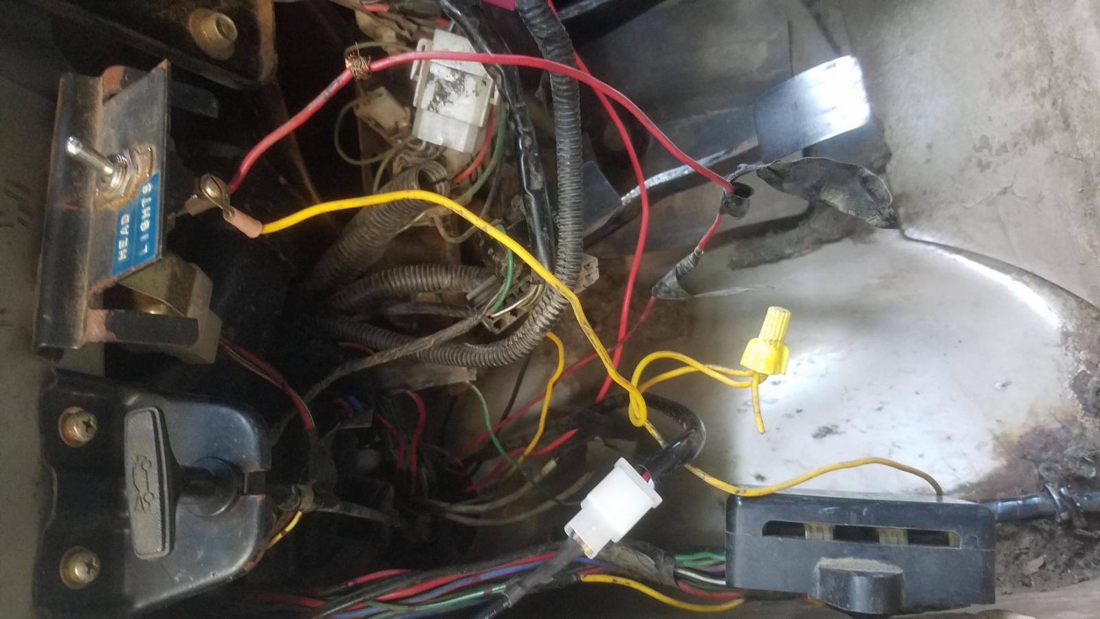

    Hello everyone, thought I would post my build and any questions I might have in the process.

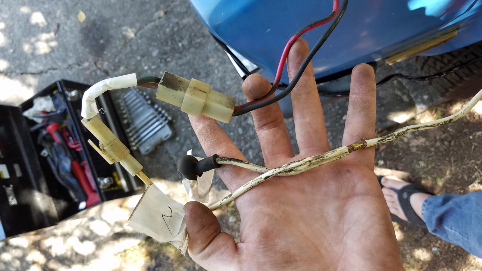

    Right now I am trying to fix the wiper system as the truck I got had its wiper motor taken out. I grabbed a 2nd Gen motor and although the bolts and holes do not match up perfectly I got it to somewhat connect. I plugged in the connector I thought would work and nothing happened when I turn the wipers on. So I plugged in another connector and it immediately made the motor hum and the 4x4 light to turn on. My guess is the original plug is for wipers and there's either a wiring issue or the switch on the Columbia is bad. Question I have now is what everyone think the second connector should go to?

    as you found out, the wiper motors are different, and not interchangeable. The intake is a headache in itself, as finding another one will not be easy - it must be from an 82 - 89 2.6 g54b motor, although one from a k car / caravan 2.6 would work if you can find them in the JYs. There may still be an 86 truck in a yard near me that might still have the wiper motor on it - I can look to see and pull it if its there. No guarantees, as I have been pulling a lot off of it, and it could become crusher bait at any time.

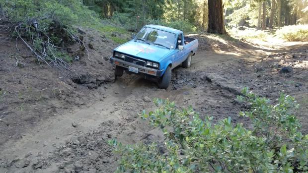

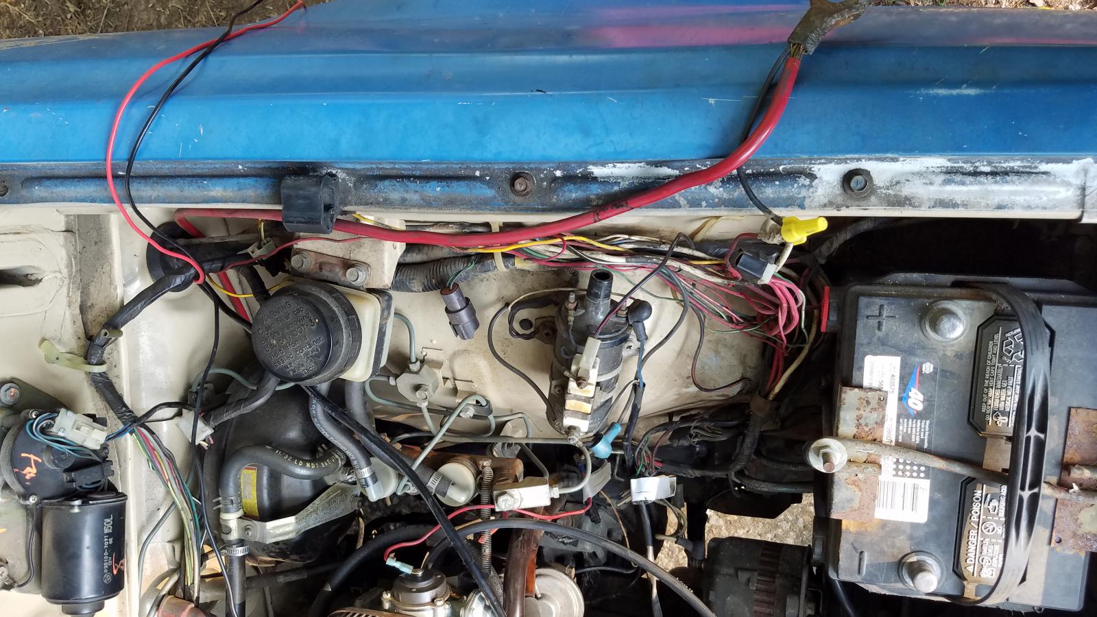

    Thought I would add some pictures of the work I have done.

    The pictures show the truck when I bought it and at its new home. Then after I took it apart showing the broken easy out on the thermostat housing. also, that carb is pretty filthy. the inside looks pretty bad too. I sprayed it off with some throttle body cleaner, so its a little cleaner now. While at the junk yard I happen to find a new weber air filter. Good thing to since looking closely at mine I can nearly see right through it.
    Next I plan on adding some mechanical gauges, finding some clips for the air filter (using zip ties right now) and getting some tires. Also need to fix the vent system a bit. It mostly works, but it wont switch to defrost.
    Since I plan on using this for a race, I plan on getting a CB radio and some LED lights. Probably also have my friend/co-driver fab up some nice off-road style bumpers. The front is bent up after some sort of front end collision and the back one looks bent from to heavy of a load.
