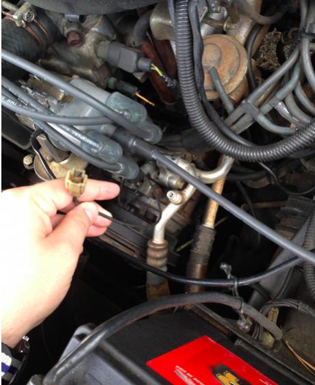

    This is the wire coming from the compressor.

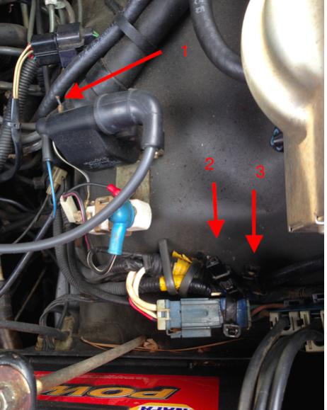

    These are the possible connections I see. #1 a connection at the ignition box but with no wire. #2 a pigtail with both male and female ends but no wire leading anywhere. #3 a male pigtail with no female connector.

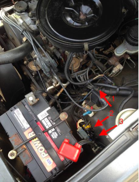

    This is another view of what we are working with, same labeling as before.

    No one has probably answered as this is a hard one to answer. Thing is most(all?) a/c units were done here in the US after they reached the port I believe or at the actual dealer. So there is no standard for the wiring I don't believe(from the units ive seen) and also believe there were a few diff suppliers/manufacturers.
    Josh
    09 BMW 335i E92 Twin turbo
    4,234
    that is true - all trucks from that time were port or dock installed because of odd import rules at the time. Kits were made by Lone Star (out of business afaik) and Frigette, to name a few.
