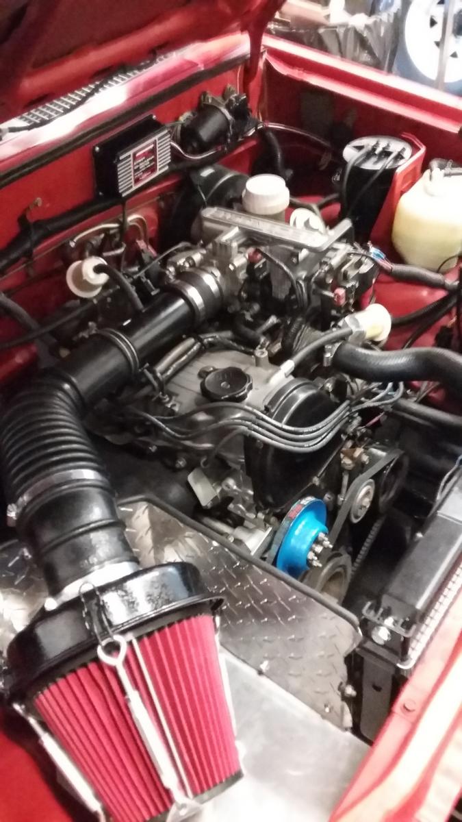

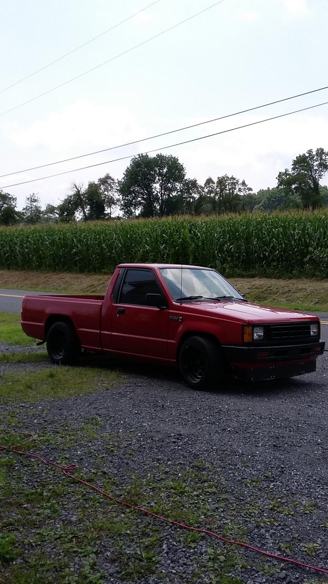

    pretty much ready to hit the street with this one. I dont have enough time at the moment to walk through building this thing. Nothing fancy,
    belltech 2.5 3" streetpreformer kit
    msd streetfire cdi box
    all energry suspension bushings
    16x8 205 55 hankooks
    custom front lip
    custom cold air
    head gasket/timing belt
    EVERY sensor tested/failed and replaced
    inner/outer tie rods
    upper/lower balljoints
    every vacuum line and rubber brake line
    egr blockoff
    so much im forgetting. Its been a battle.
    currently looking for dohc head / turbo swap parts.

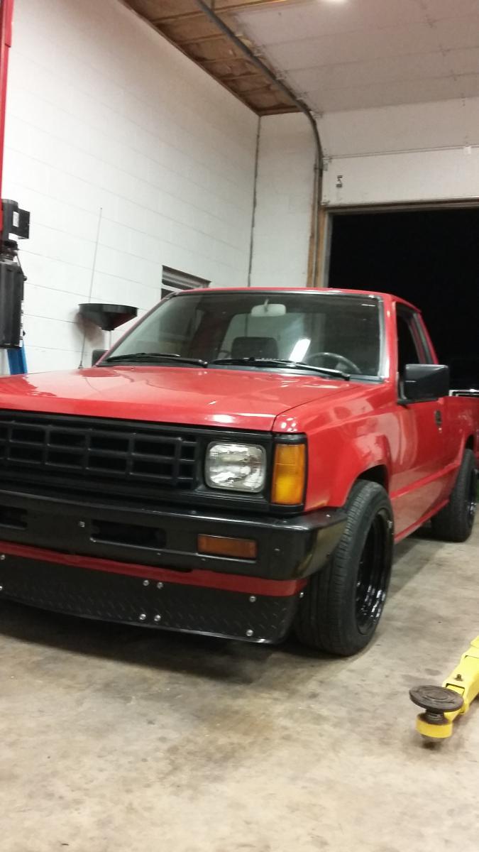

    More info on front lip?
    07-02-2016
    6
    wind gap, pa
    Just some aluminum diamond plate tapered at the ends and bent to fit, some nice-ish hardware, sprayed with plasti-dip. Did it in 3 pieces, I'd suggest doing it in one. And to finish it up, some weather stripping I had laying around stretched and clamped around the bottom from the back.
    07-02-2016
    6
    wind gap, pa
    The front lip is just aluminum diamond plate, tapered at the ends and bent to fit. I did it in 3 pieces, I'd suggest doing it in one. The rubber lip is some weather stripping i had, glued and fastened from behind. Add 8 coats of plasti-dip, some nice-ish hardware and now my trucks got a fat lip.
