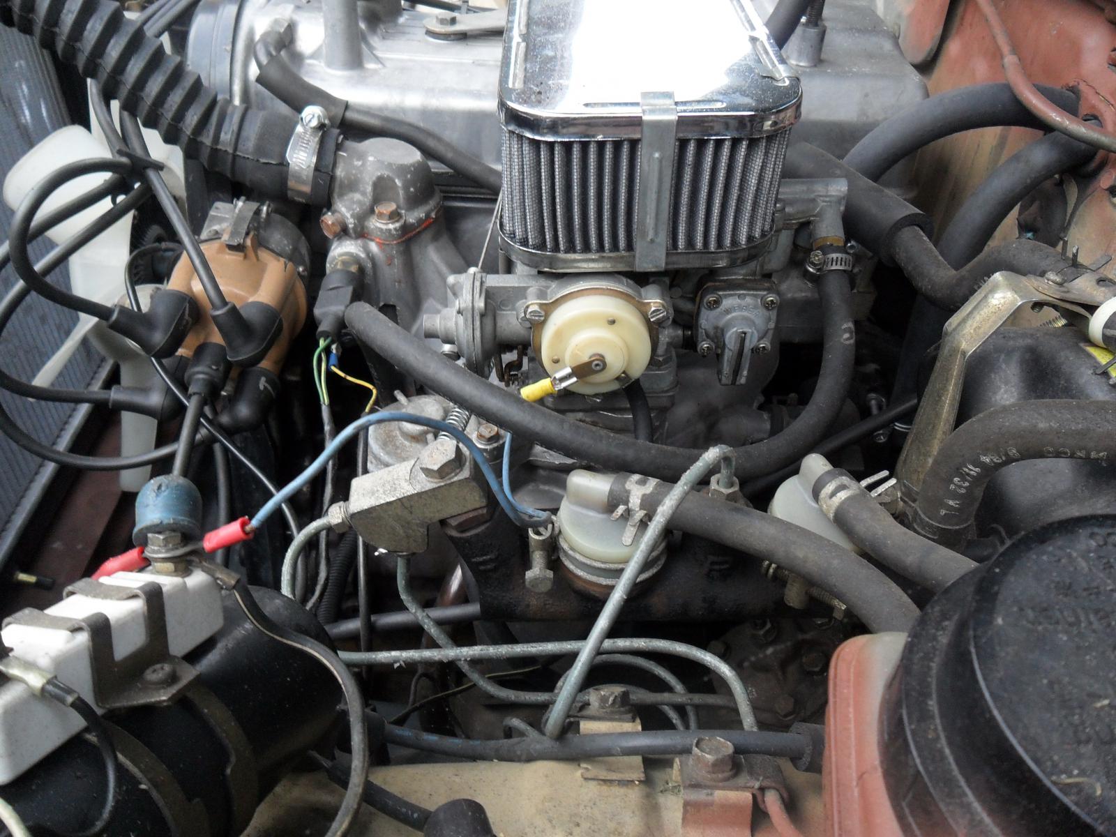

    You can see the setup. except for adding a new head, new rad, new hoses and hammering a freeze plug into the exhaust mani port after whatever was in it popped out and a new battery last month It is as I bought it. IDK what wires to trash and I suspect the carbs choke don't work right since I sometimes have to hold the butterfly open to get it to start. It probably could use a new coil. I'd like to remove all of the excess wiring to clean up the motor compartment. Oh yea I replaced the heater with a good used one. SAM_0702.jpgSAM_0703.jpgSAM_0704.jpg

    Do not buy from webercarbsdirect - they are knockoff junk carbs - the black choke cover and stickers that say weber are the tipoffs. Only buy a redline weber - they are real Spanish made carbs. Your under hood picture shows a beige choke cover - that is a real weber. The float adjustment is 1/8 inch from the cover with the cover held vertically and float pivot at the top. Look up the thread for how to adjust the choke to have it work properly.
