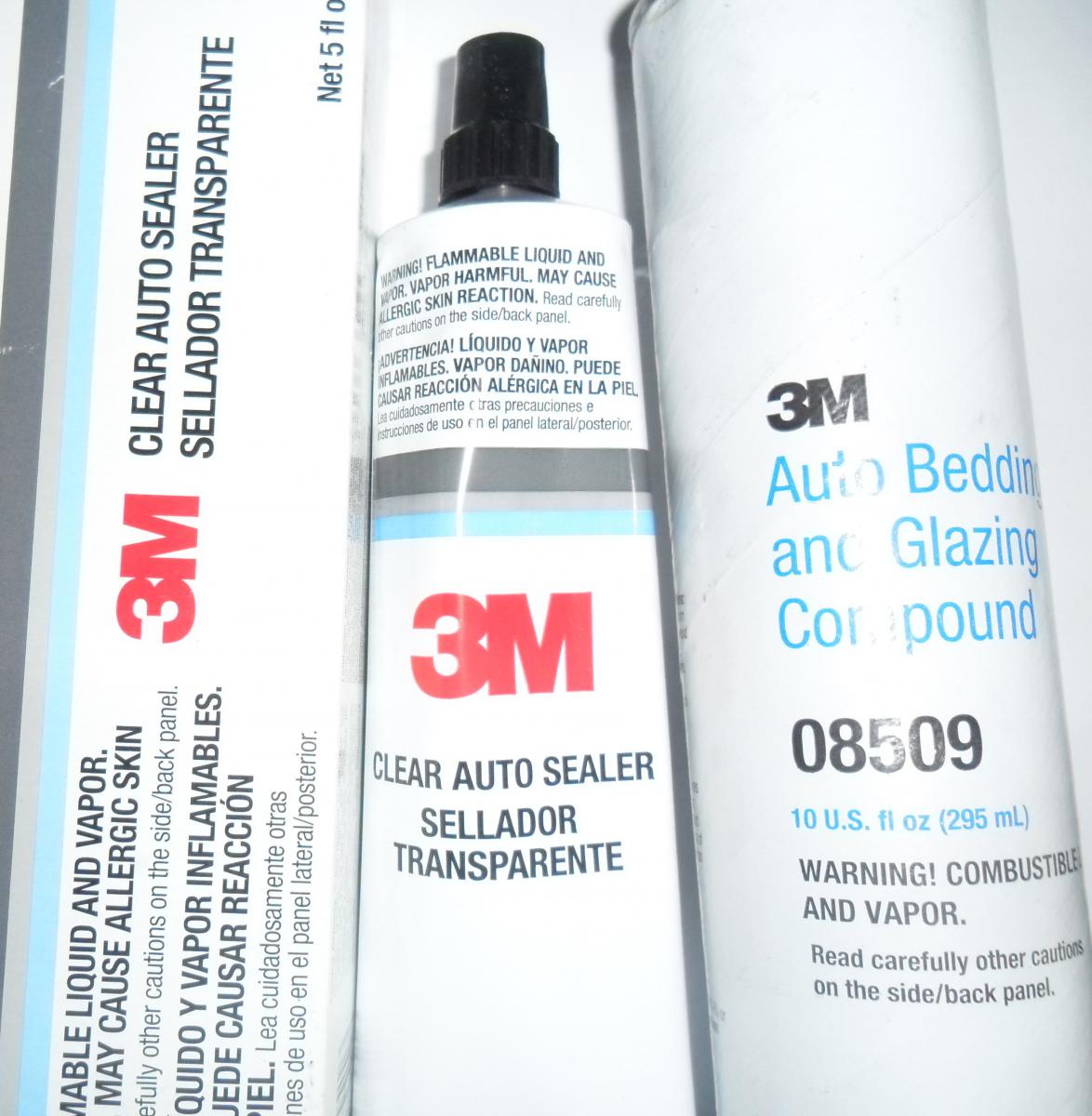

    I received my gasket and the instructions are not exactly what they showed on YT which made it seem that the seal was made by the rubber.
    The instructions they send says to use 3M glazing compound (96-8509-96) on the area just outside the pinch weld. and then they say to use 3M auto clear sealer (96-8551-96) between the rubber and the glass on the outside after it is in.

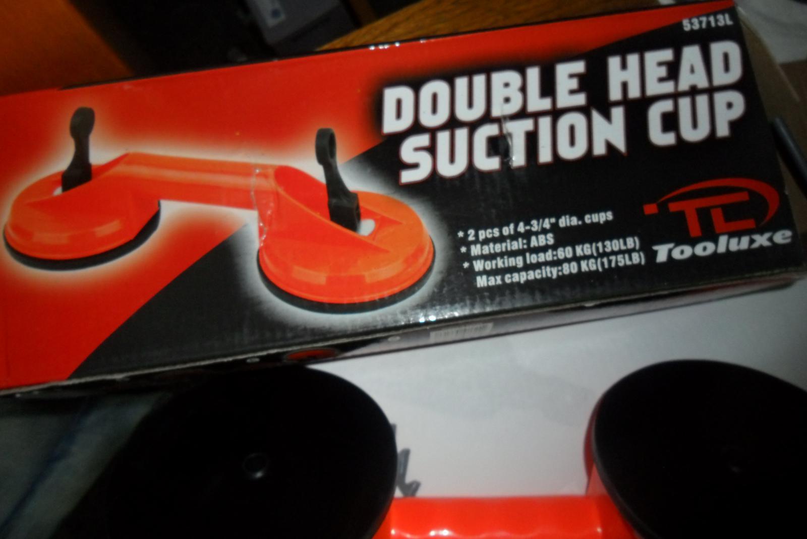

    O'reilly's didn't have it on the shelf. they will order it. Advanced Auto Parts (formerly Carquest) had it in stock. They said it is a regular stock item. Here is a pic $19 for the Bedding& glazing compound and $22 for the auto clear sealer. The suction cup is to hold the rear glass as I set it. I found it when I ordered the gasket. It was on Sears site $12.95 shipped. I might just take the bench out to make it easier. I have all the stuff, now I need the weather Starting tonight rain for the next 2-3 days at least. I'd like anyone who has done this to let me know of any surprises you might have had. Thanks.

    Rick I appreciate the advice but I already have a new one from Steele Rubber. $93 I watched their video on YT "How to replace back window glass seal with a cord" That is why I am going to try it.
    I called Steele Rubber this morning and explained my confusion about the instructions differing from the video. According to Mike the video and you are correct and I do not need to use the bedding compound or sealer. Apparently these are stock instructions the dealer "PCP Wholesale, Solon OH" put in the package. He assured me the seal would "rope in" and seal fine on the Ram 50. One thing the instructions do say to do and I don't recall from the video is to use soapy water in the groove the glass sits in so that it can move and seat as you install it.

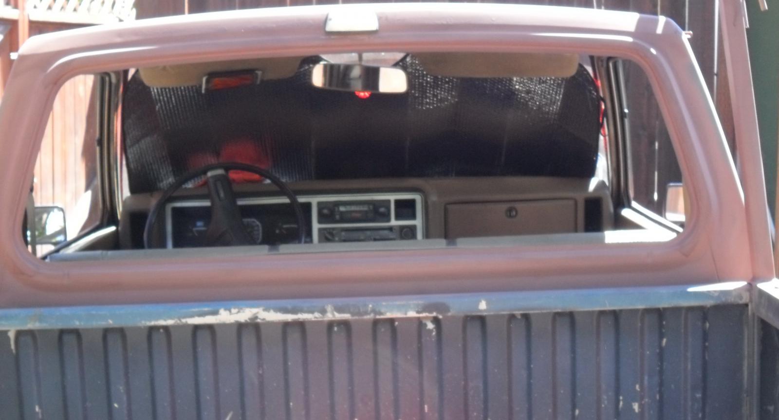

    So I got the old one out didn't have to remove the seat . No rust cleaned up around the area, sanded it and painted it with Rustoleum Automobile Primer. The window had some black gook on it because the last installer used it inside the groove in the rubber gasket. ???
    I cleaned it and started putting on the rubber. It is 1:15pm I started at 11:30ish. I sprayed it with loads of soapy water as recommended. Worst advice ever! I wiped it off and started again after trying for 30 mins or so. Still no joy then I thought to use the suction cups to hold it. Not much help either.

    I took lunch then went out at about 2:10 and it went right on. I put the 1/4" rope around the pinch weld flap. I put the sucker cups on it and laid it in the bed, got inside picked it up and after a couple false starts it went right in. It was installed by 2:30.
    Um I guess if you try it my way with suckers you should know to set it in place where it goes, not where the pinch weld flap is trying to hang over the pinch weld on the bottom which is what I tried the first time. The rope pulls the flap up and over. It went easier than the guys doing the truck in the Streele Rubber vid made it look. I only had to stop to switch hands with the rope and suction cup. Some of the primer marked up the rubber but it wiped right off.
