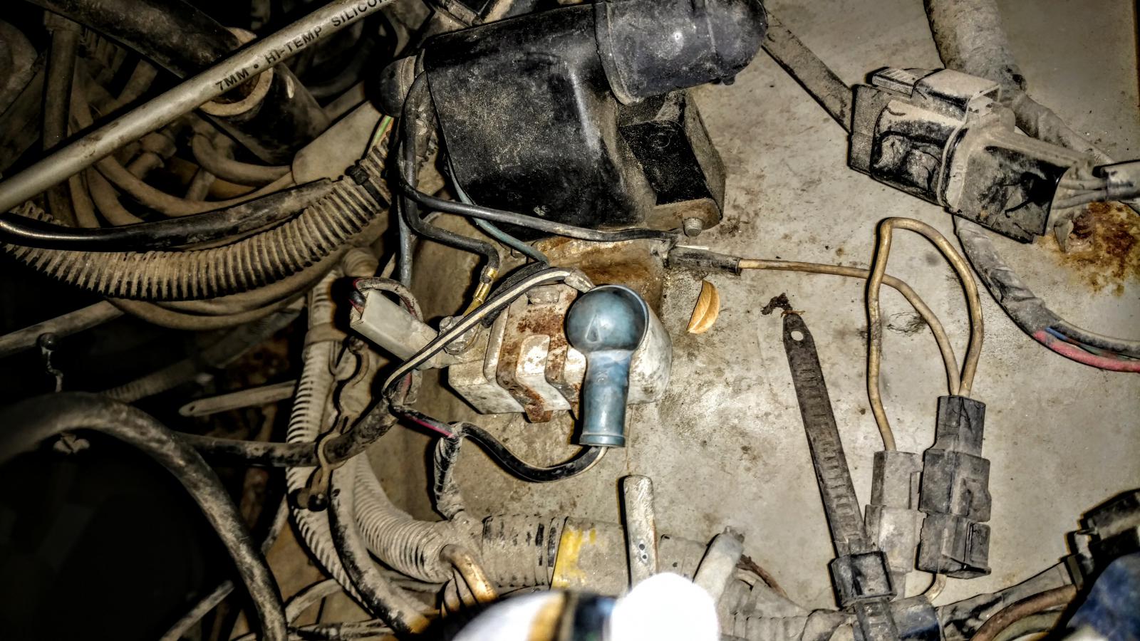

    You guys talking about this thing? Under the blue-capped wire terminal?

    If so, I just ran the truck for 10 minutes and that thing is hot as hell. Burned my finger on it. I'm guessing that's not supposed to be like that? Where can I even get one these days?
    Thanks again for all the responses.
    4,309
    that is the ballast resistor for the ignition coil - it will get hot when the truck is running - that is why it is made of ceramic.

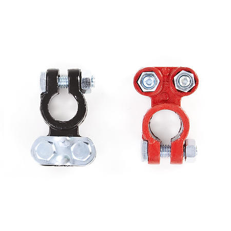

    Tell me does the battery have new clamps on it? You know the red and gree ones? If so the powder coat on them is the problem. While they look pretty in the package they will cause a host of problems because the coating is on the sides that are going to touch the post and wires.
    Also if the ground wire from the block to the engine is missing then the clutch cable can become the ground. This can be a problem as it can burn the cable.
    This is the poster child of problems. Powder coating stops electrical current.
    So by looking at this picture you can see how little contact is made where it counts.
