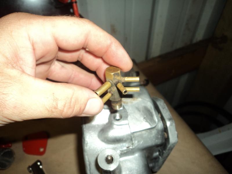

    can i knock this plug in or do i need to take the rocker arms off to install it?
    can i use this vacuum tree below the carb for a MAP sensor?
    Just loosen that back cam tower and you can slide it in there.
