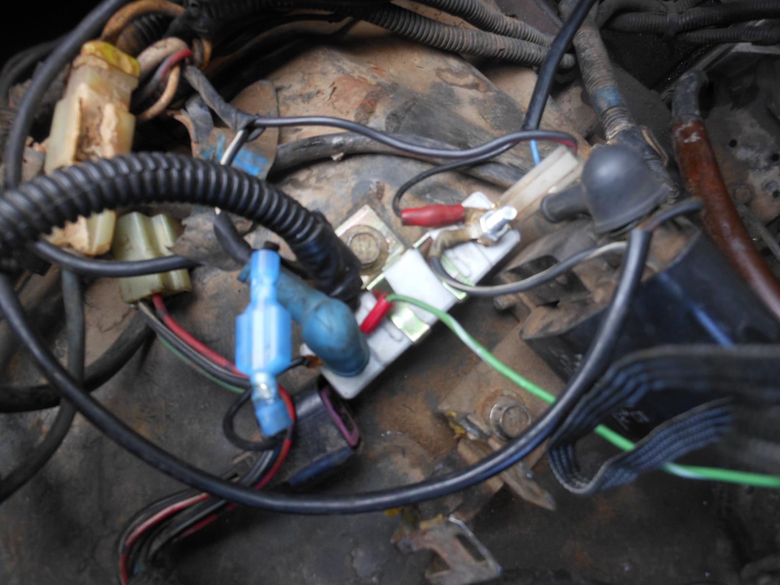

    Borg Warner ru500 installed... works fine. Came with it's own mounting bracket, a little easier to install I think then reusing old bracket. Drove about 100 miles, heating well within acceptable limits.
    Thanks or the help, especially geezer!
