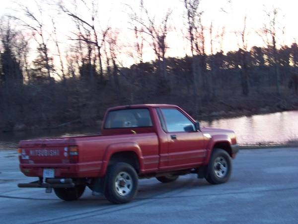

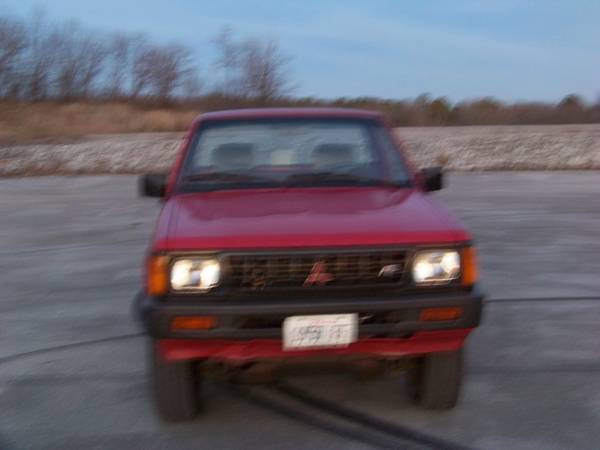

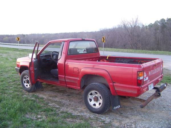

    Picked up a 91 MM v6 4x4 today, she has some pretty bad cancer in the frame. That will be where I focus my attention first. I ordered body lift block to try and do a bodylift the old fashion way Click image for larger version.

    It's a shame the frame has got rust issues. The body and cab look like they're in decent condition - but that rear bar looks scary. You'd wanna make sure your tetanus booster is up to date (just pretend you've bought a Mustang )

    That bumper is gone already ill be building a better one when I fix the frame

    Looks like ill be rebuilding the whole rear of the trucks frame itspretty bad ill get pics onei have the bedoff
