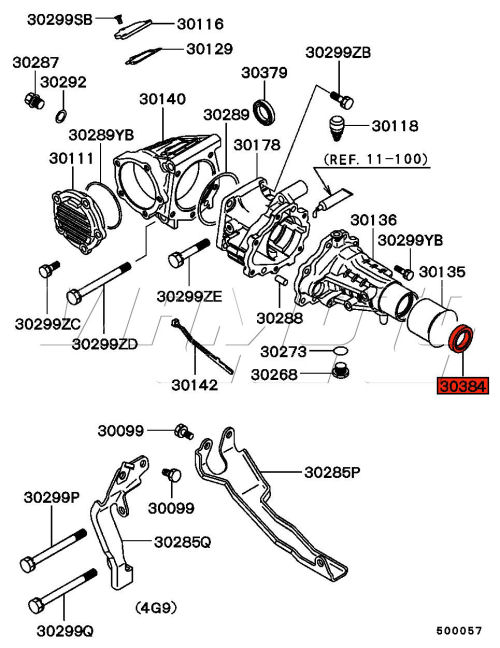

    It's more or less seating the seals correctly . They still do sell them though.
    Did you use a socket to seat them?
