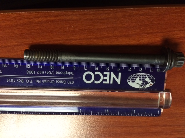

    I am working on a 1995 Mighty Max a friend of mine bought it needing a Head gasket repair so .... I took it on, Funny thing is , after taking Valve cover off the head has the Jet Valves in it ... .what gives ?? well long story short, this head is thicker then the original (1995) head!! Purchased New head bolts for 95 and they are too short!! I can't seem to locate the bolts i need & I dont know what to ask for (or search) for the right one's because I have NO IDEA what vehicle he head came off of!, so PLEASE HELP !! IF I cant figure it out , I am thinking about getting grade 8 bolts and trying that
    attached is a pic of the bolt that I am needing .. it measure over 4.5 inches long and the 1995 is like 3.7 inches
    Thanks in advance
    Hi and welcome to the site. There is a simple reason why you can't find replacement head bolts for your friends' engine - there is no demand for them as they are reusable. You'll be fine reinstalling the originals.

    thanks for the reply geezer... however , One of the bolts broke & I had to drill it out then of course the easy out had to break and had to drill it out.... So needless to say this HG repair has been a PITA !!! So that's why I am needing extra head bolts for the truck. and I was hoping someone with more knowledge of the 2.4's may know what would fit this head or maybe someone may have some extra bolts I could purchase ?
    Damn, that's not good. I had a similar problem but instead of the bolt snapping off, the hex key socket was chewed out. Not what you want to run into when pulling a cylinder head...Don't know what relevance this might have with the cylinder head bolts but do you know if the engine is a 6 or 7 bolt bottom end? You will fix the head bolt issue by going to ARP studs but these suckers are $$$.

    I have a G63B dodge and when I replaced my head I got them from a Mazda dealer. He had to look for them for 20 minutes or so them order them. I brought in one of my existing bolts. I had no idea they were re-usable.

    the owner told me "GOOD LUCK" fining them ( he was serious) so I asked him what they'd do if it was in their shop? He said we'd to go a specialty store for fasteners and bolts and get grade 8 bolts and use them. he's stated they've done it lots of times! So took it to the local place and they said it was 7/16 X 5 X 20 or 11mm X 127mm X20 so I order 10 of them!! I did run a tap down the holes to clean up the threads. However we got to talking and somehow i ended up getting a smaller bolt!! so YET again something went wrong on this headache!!! oh well
