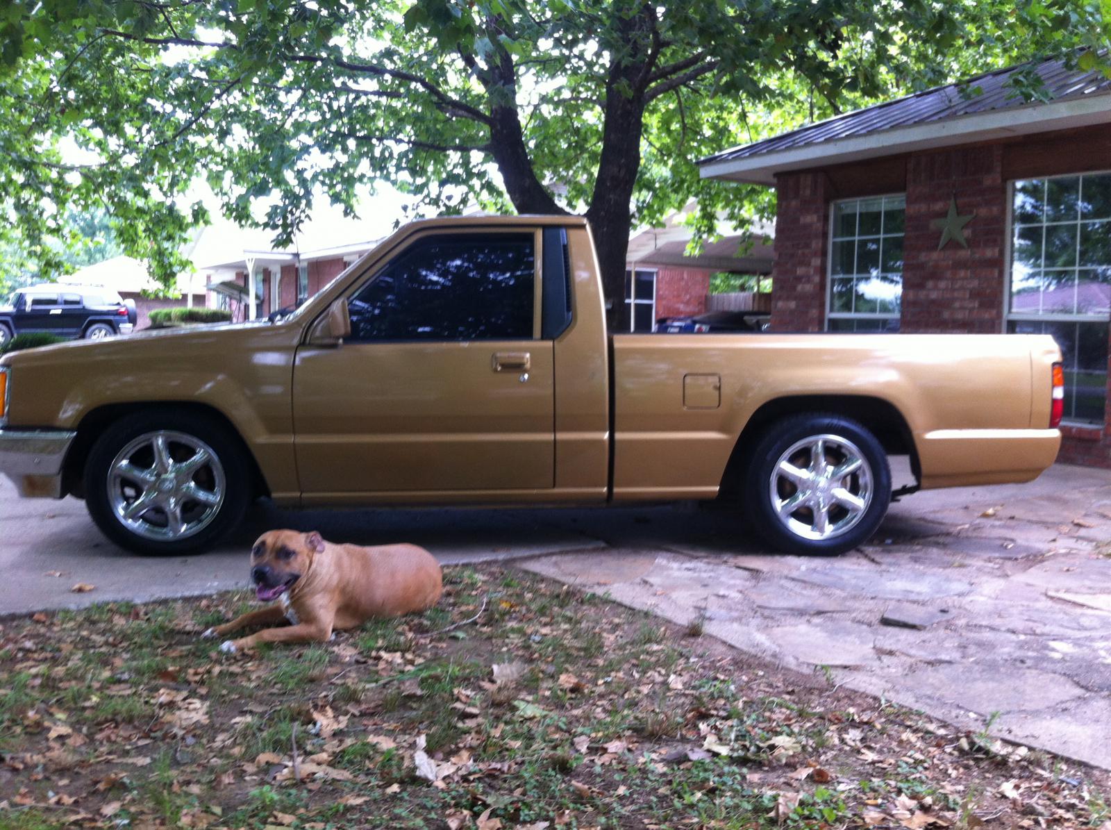

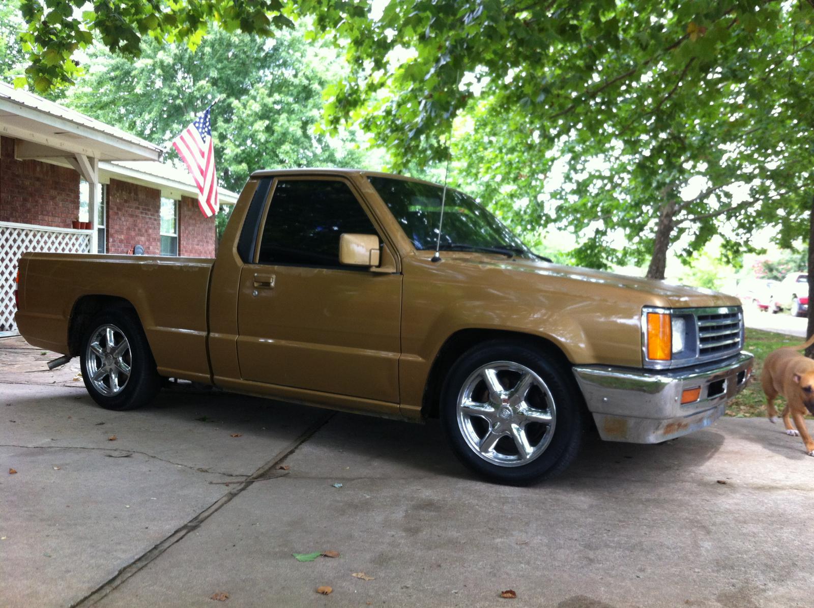

    Finally got home and got these mounted and I must admit the tire size I chose was perfect for a 3" drop. I went with 205/55/16's, I also chose to grind down the rear hubs and knock off those tabs on the front. The front was cake, the rear was a bit of work. I did have to go with some 1/4" spacers up front because my wheels where making a bit of contact with the upper control arms. But all and all I'm very happy with the outcome and now I can run any GM 6 lug I want.

    I just got 16 inch, gm rims for my truck too. I just need to find a tire size for them. I don't plan on lowering my truck tho. How is the offset on yours. Do they stick out much farther? They look pretty cool tho!
    Is that really a 3" drop? I have a Gen 1 which allegedly had a 2.5" drop and you can really notice it (might be the wheels - still running 14" on a slightly lower profile Yokohama truck tyre) Your truck looks sharp but now you need to paint that front bumper skirt!
