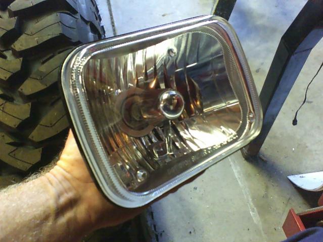

    I just picked up a direct replacement of the sealed beams. Truck lite # 27009 And YES they are DOT stamped. Glass front metal backing. They come with lamps. I got them through The Light House.
    Here is a link to the truck-lite site. They were around $80.00 for a set of High/Low They also have just the Highs
    http://www.truck-lite.com/webapp/wcs...tentryId=33651
    Cool, Do the Bulbs/Plugs stick out any further than the stock sealed beams? It's kinda a tight fit in my engine compartment with Dual 1000CA Batteries in the truck. The Batteries literally sit tight against the core support.
    Also while i'm on the topic of lights. Anybody got some Low-Profile Light recommendations? (have about 5" height to work with, former license plate location) Anybody who's ever tried plowing snow in the dark with just the stock reverse lights knows what i mean when i say you can't see crap. Or just backing up through a winding trail at night. Went night fishing last week with a friend, and had to take the critter off-road to reach the fishing spot. When we went to leave, my buddy had to sit in the bed holding a 12V portable Spotlight so we could see to back out to a wide enough spot to turn around
    My friend found it funny though, that every time we needed something, i told him to reach behind the seat. "Dude, it's getting cold out" "There's coats and sweatshirts behind the seats." "What if the battery goes dead and we need a tow? You're the one with the towtruck." "There's a jumpbox behind the seats." "How are we going to see to back up?" "There's a spot light behind the seat." "What isn't behind those seats?! It's like you've got a frickin' toolbox of goodies crammed in this little truck!"
    They are a direct replacement of a seal beam. Pin hight is the same as seal beam.
    Now for the bas ass back up light that is 4.5 H. -- 3.5 D -- 3.5 W 55 Watt Quarts.
    Same place, Light House. Made by Hella 1G0 996.176-491
    55W watts of Bad Ass Reverse Light!
    Sounds perfect, I've got 55W Driving Lights on the back of my Dakota (Plow Truck), but i had more room to work with on that truck (i had another set of driving lights, but they're about 3/4" too high to fit between the crossmember & bed). Those 4.5" Ovals you posted will work great on my D50. The Driving Lights on the Dak work great for backing up at night, it's like i've got High Beams on the back of my truck, lol.
