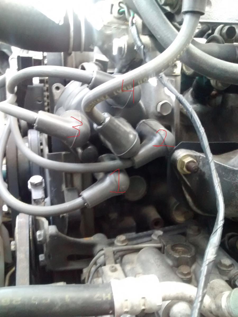

    that big T is TDC correct?

    ok so here are some picks. the motor in my truck is a 1995 but everything sets up the same as yours. i have the timing slightly advanced on my truck but it runs great like this. i could not get a picture of my lower pully setup because of all the belts but it was aligned slightly before the last mark like yours. looking at how yours lines up it should be fine assuming the harmonic balancer was put on right. the picture that shows the cam aligned to the head was taken at an angle so it will look slightly off. just line all the marks up and set the distributor to how it is in the pictures and it should fire up.
    distributor set.jpg distributor timing.jpgrotor location.jpgtiming mark set.jpg

    Quote Originally Posted by chaoticdopey View Post
    Yes.
