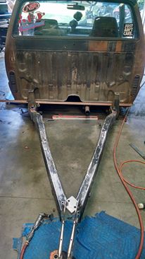

    Here's the bent frame:
    Here are the rails after some cutting (to mount the subframe as high up as possible):
    13339559_10204343288220946_7714167916770824934_n.jpg13321827_1359799174037487_1758863511501020515_n.jpg
    This is why I chose to bend the rails instead of notching and making a mess:
