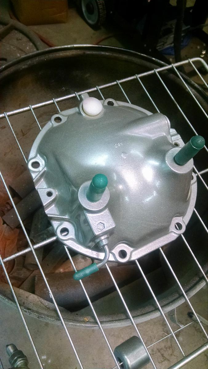

    My brother went to town on the S13 diff. If anything breaks, this won't be it.

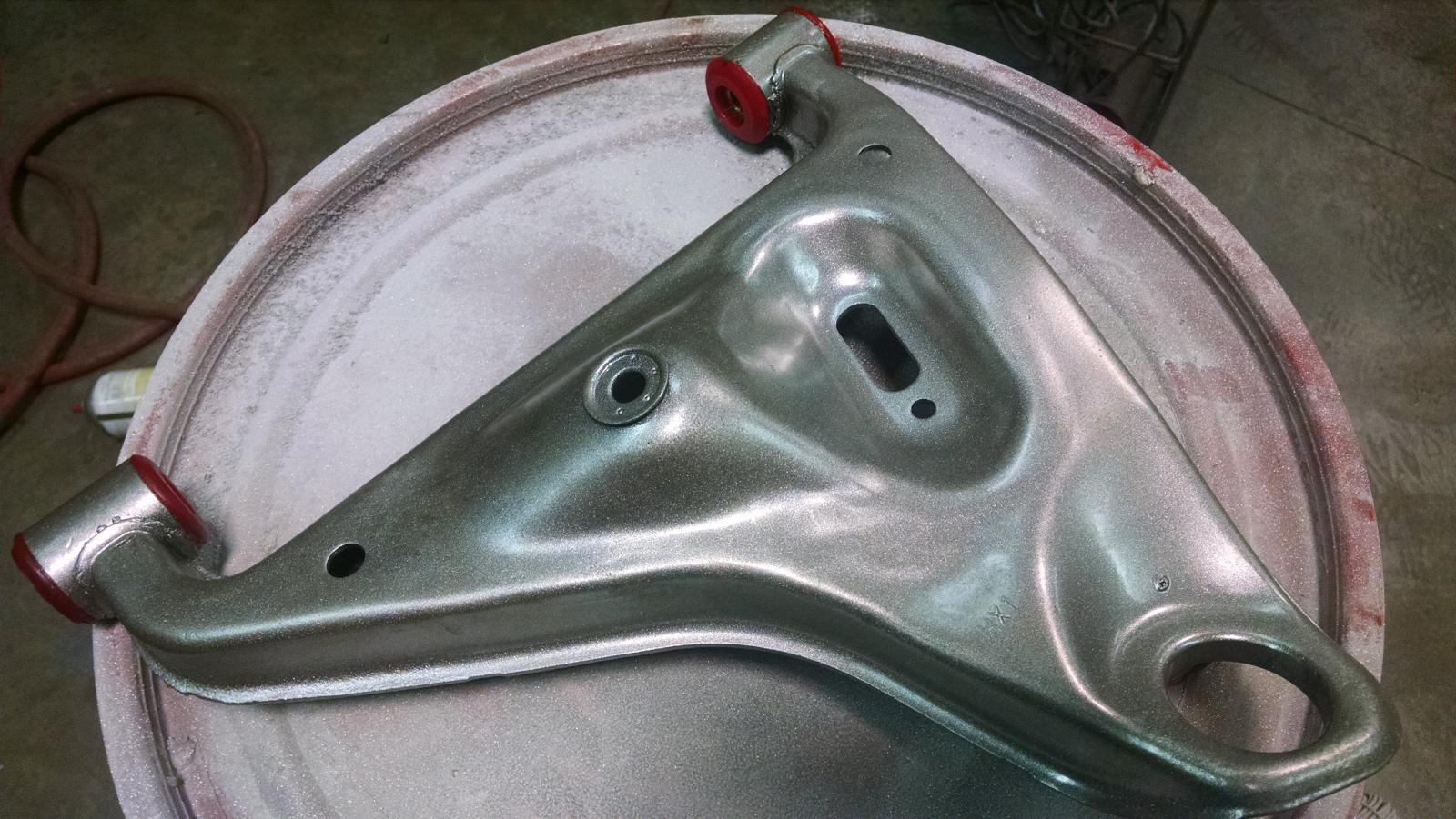

    Here's some of my brother's powdercoat work on the RLCAs and diff cover.

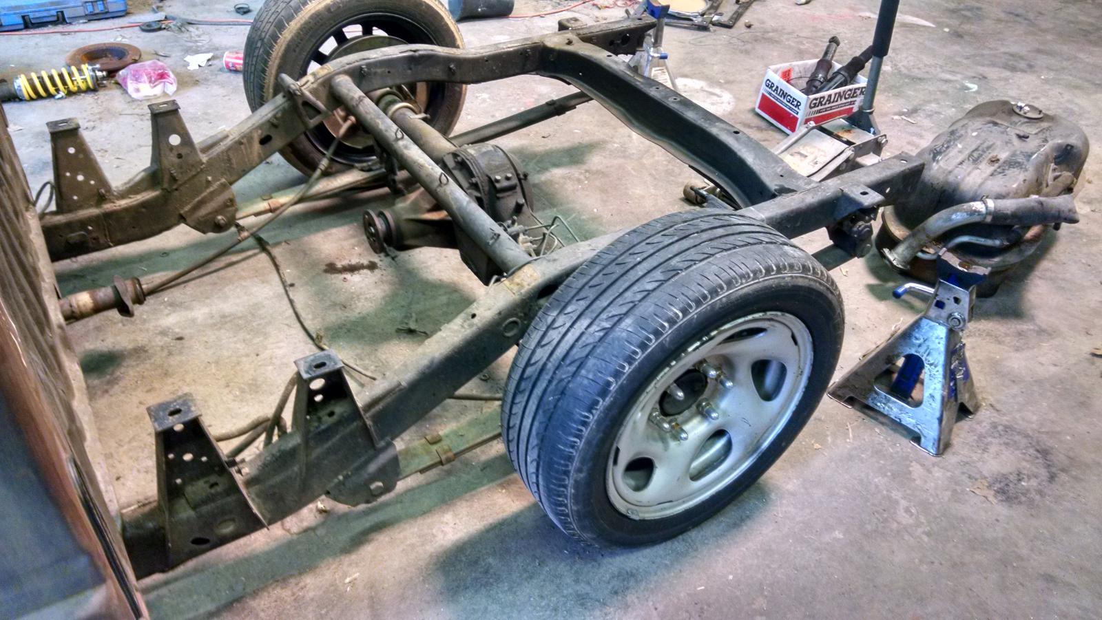

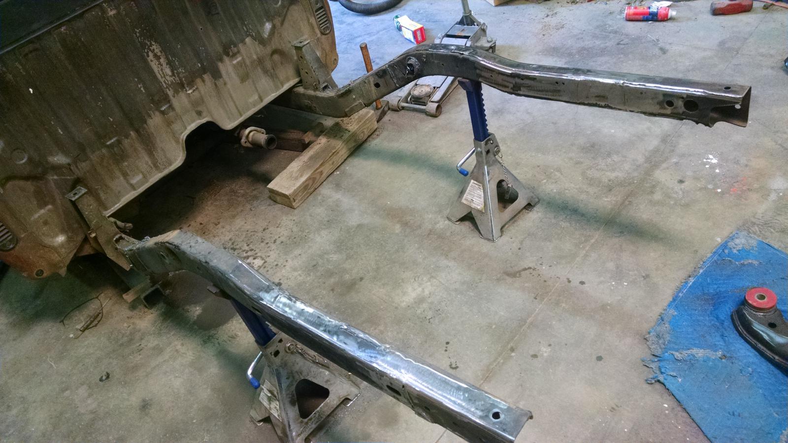

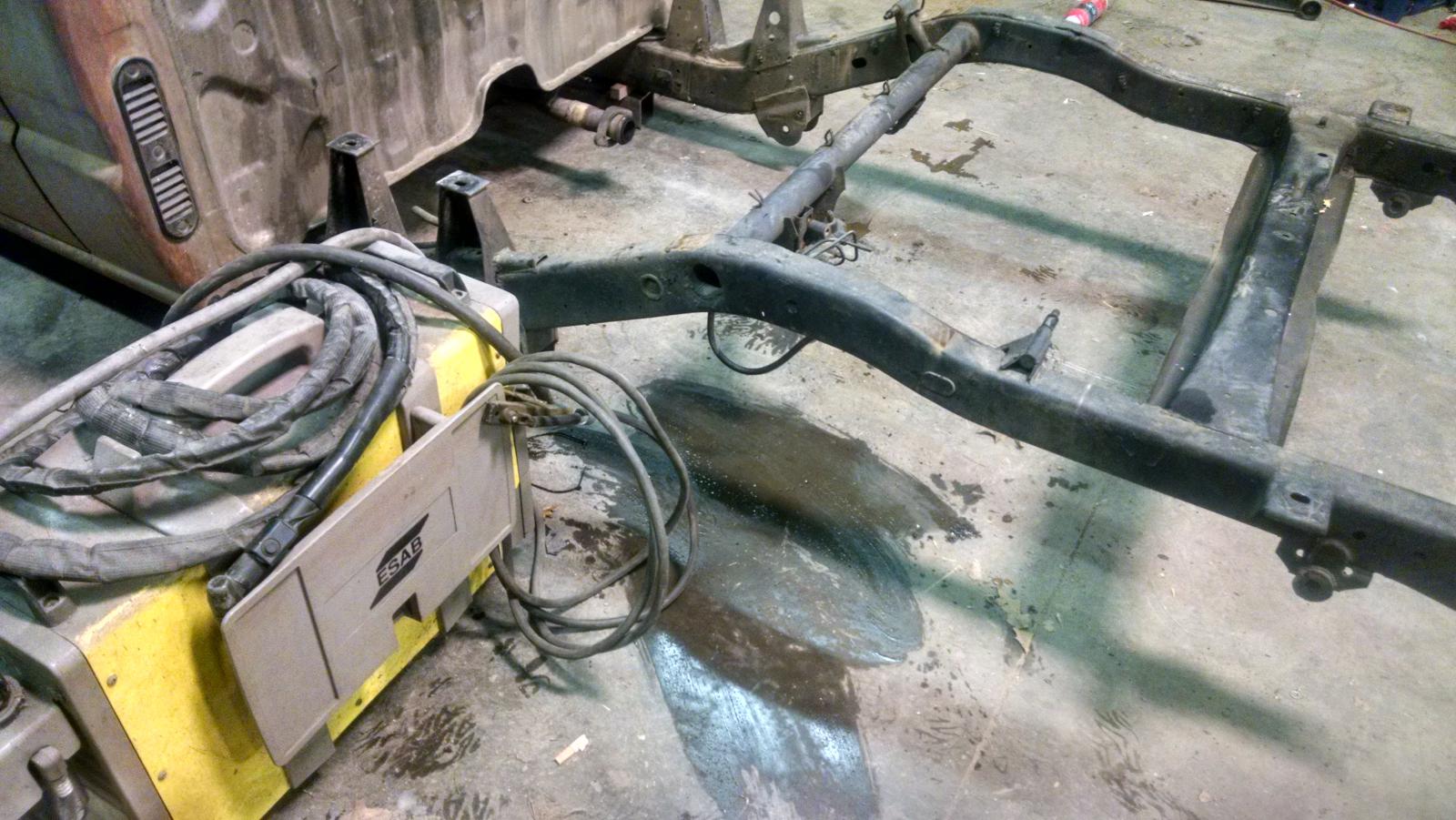

    A plasma cutter made short work of stripping the frame rails. We still have some grinding/ prepping to do before we make the bends for fitting the subframe.
Name:	2016-05-28 18.50.38.jpg
ID:	16899Click image for larger version.
Name:	2016-05-28 21.08.27.jpg
ID:	16897Click image for larger version.
Name:	2016-05-29 16.10.15.jpg

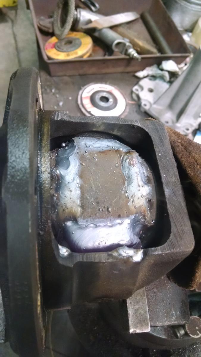

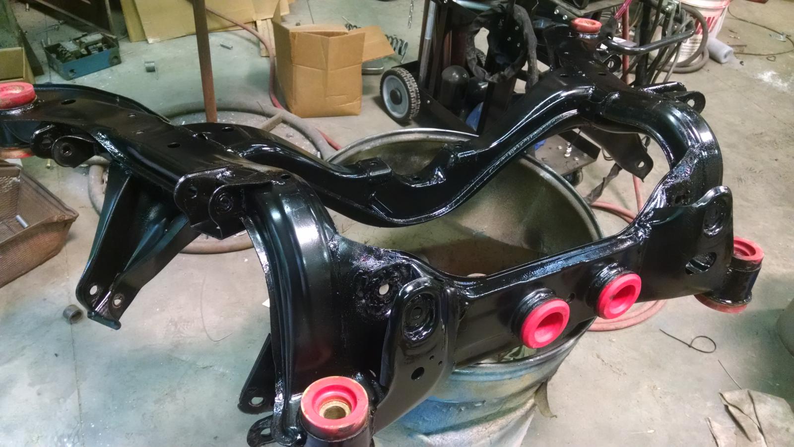

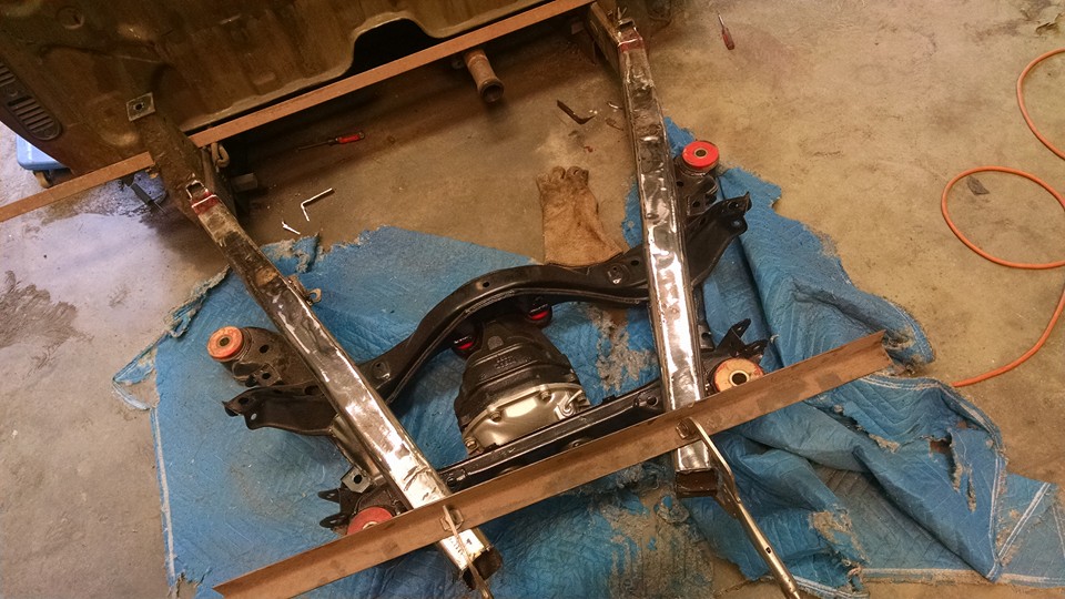

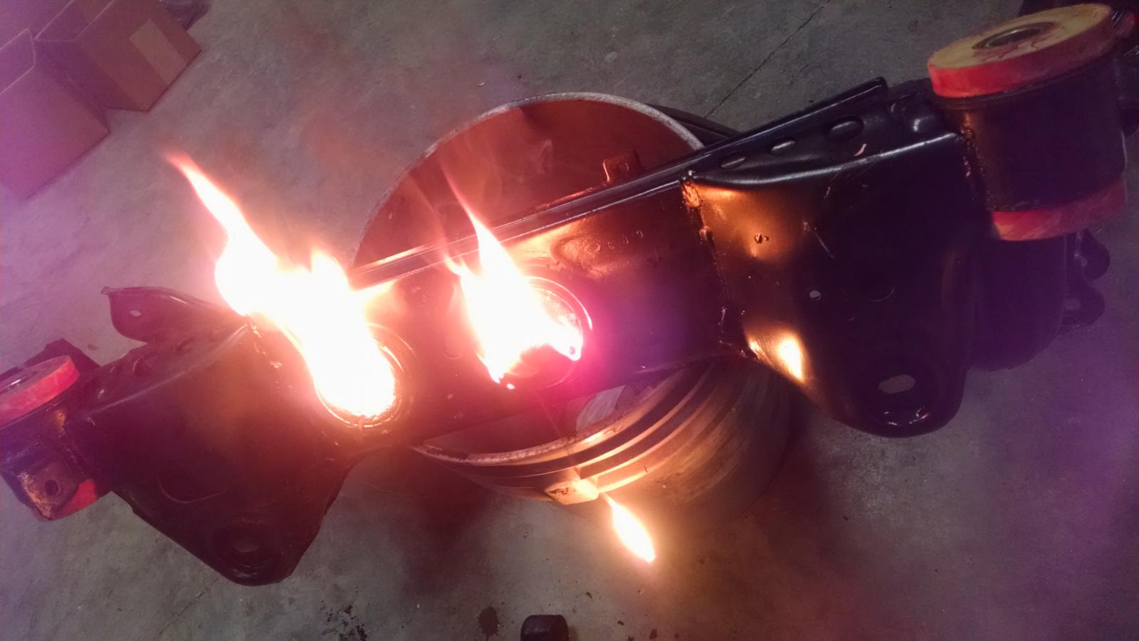

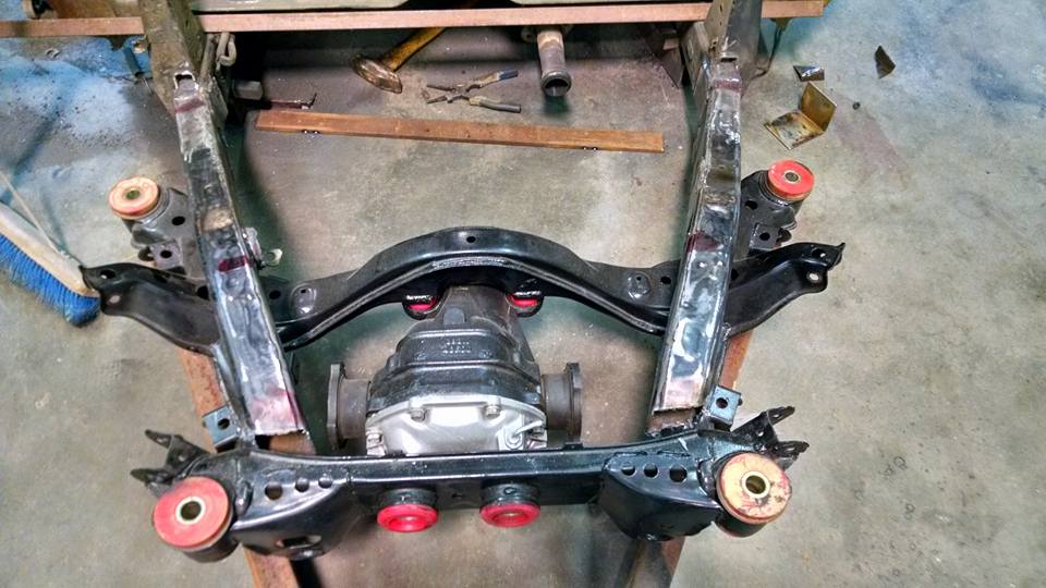

    The S14 subframe I bought already had poly bushings, but I still had to burn out/ install differential bushings and weld in some washers for deleting the eccentric bolts.
Name:	2016-05-28 10.45.30.jpg
ID:	16900Click image for larger version.
Name:	2016-05-28 18.53.56.jpg

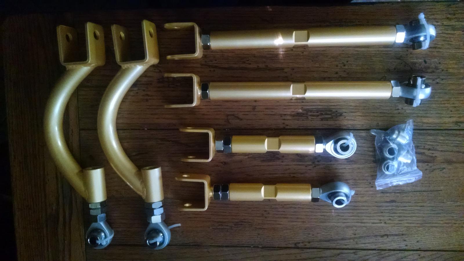

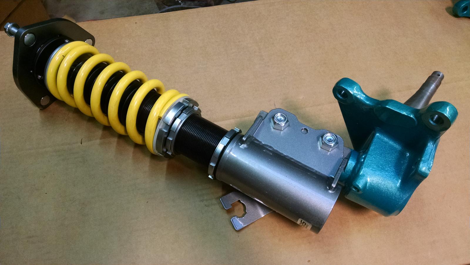

    Here's the ISR rear arms and coilovers mounted on modified Z31 front knuckles.

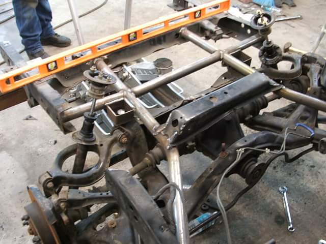

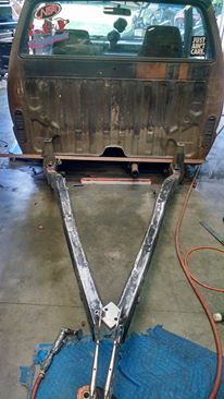

    Here's the bent frame:
    Here are the rails after some cutting (to mount the subframe as high up as possible):
ID:	17081Click image for larger version.
    This is why I chose to bend the rails instead of notching and making a mess:
