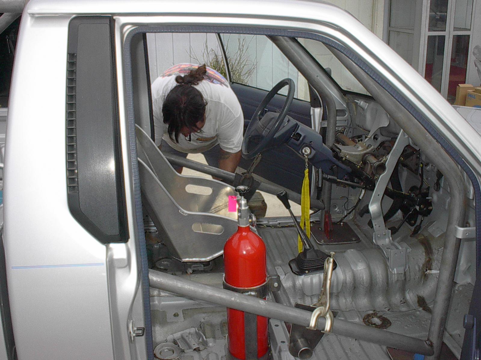

    Just a heads up, when you remove the Heater box (big piece in the middle) there is a Nut, in the engine compartment that you have to remove.
    when I removed everything from under the dash, going racing, I found it after beating the thing into submission and finally a sawzall to get it out.
    that's when i found the stud going thru the firewall with the nut in the engine compartment, by the transmission tunnel on the passenger side. Just sayin'

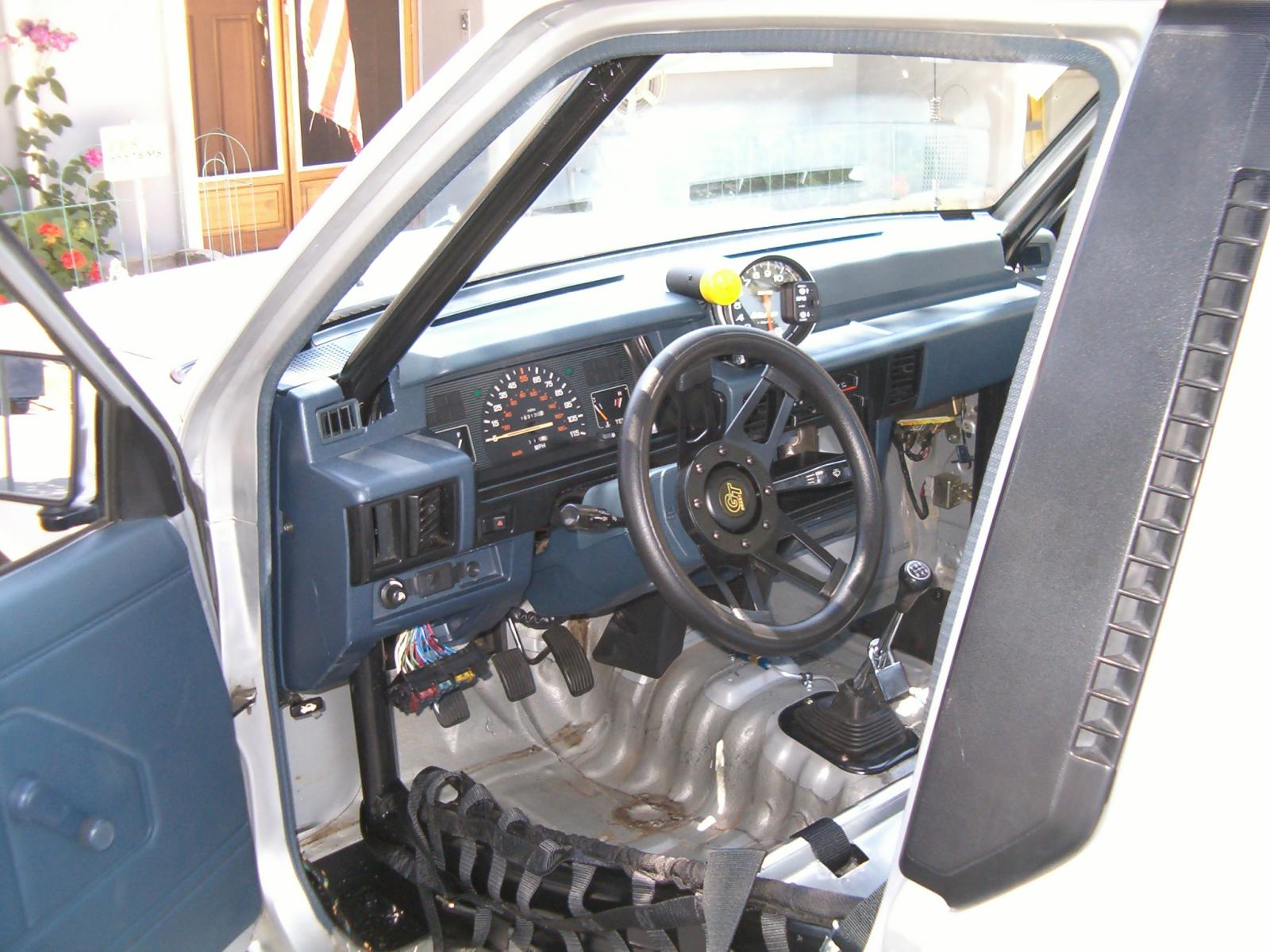

    Oh yeah, basically everything can come out..this is the roll cage being put in...
    Then put the dash back in....

    Very informative, thanks!
    Quote Originally Posted by LSR Mike View Post
    Appreciate it! Roll cage is lookin good!
