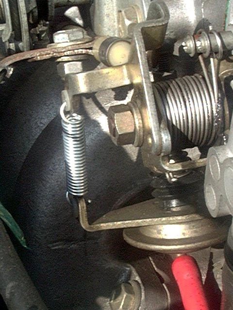

    You have the wrong size alt belt and it is 'lashing'. Going for a shorter belt should solve that. That throttle return spring... Can a return spring be attached to the throttle linkage and then anchored to the throttle cable bracket so it is facing the other way? It will be running underneath the throttle cable in a parallel path. The spring will be much sorter. Other option might be fitting a tensioner spring behind the throttle linkage like this -
    Undo the throttle linkage and slip the spring onto the shaft - one end would hook around the linkage while the other end is pinned against the body of the carb. You could 'procure' something from an EFI throttle body at a junk yard. Just an idea.
